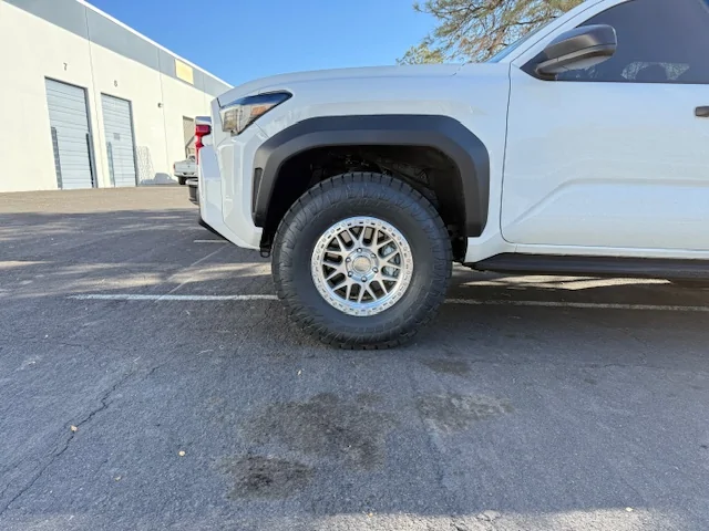

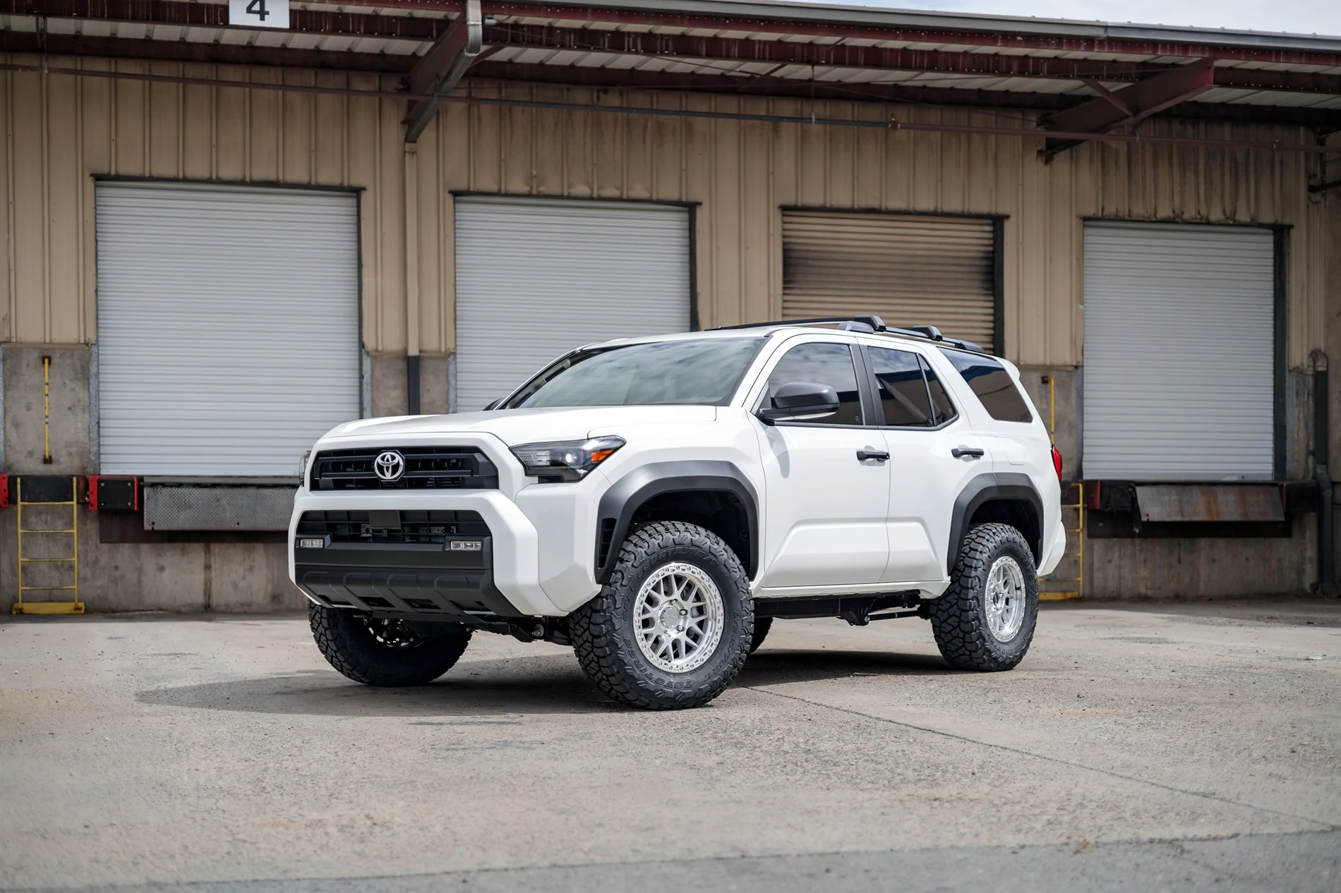

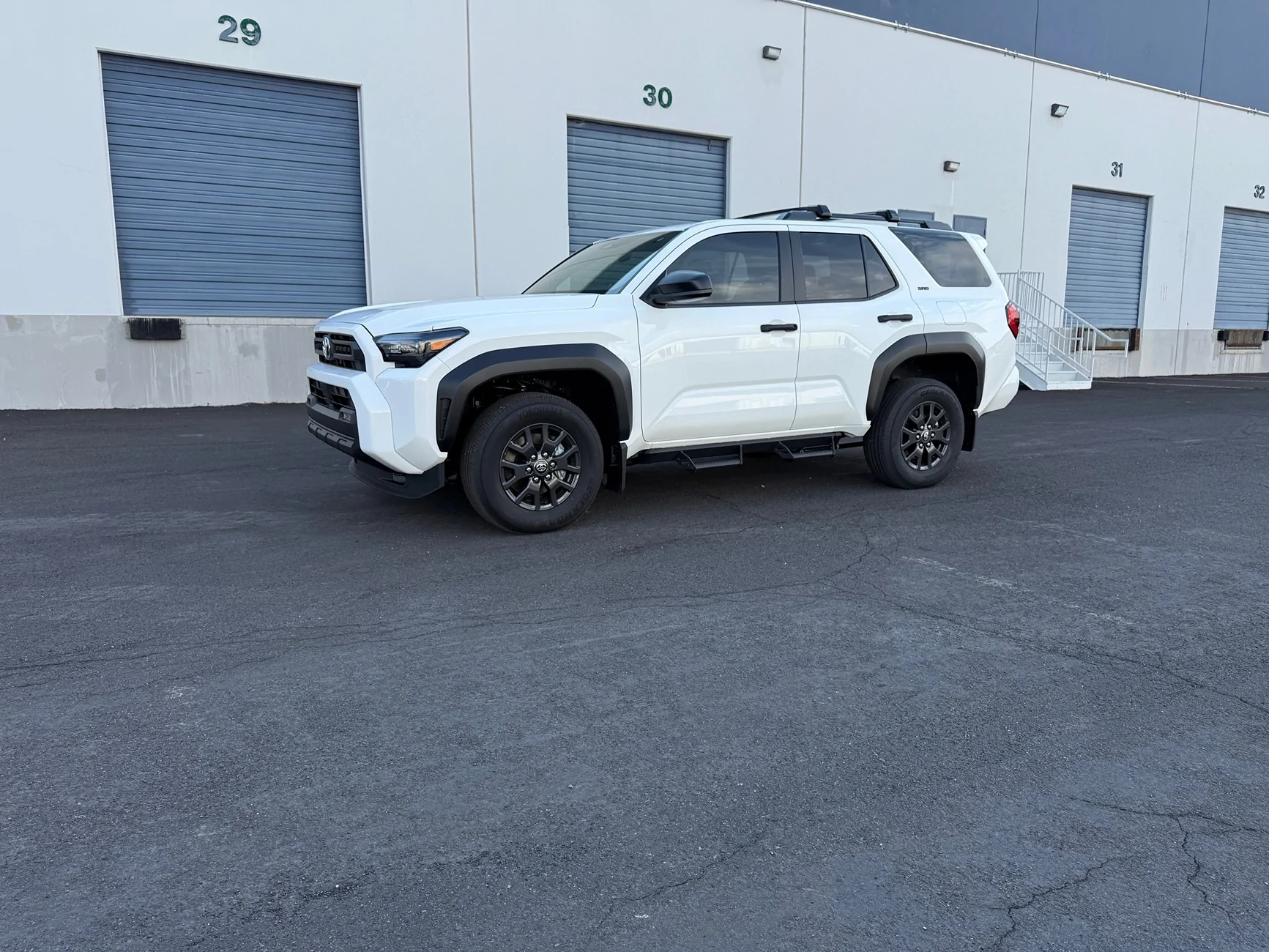

Here is my SR5. Current mods
1.5" Rough Country Leveling Kit
ModCo M73 17x8.5 +22 offset
285/70R17 Toyo RT Trail Tires
Premium JDM Horns
TRD Cast Aluminum Running Boards
TRD PRO Grille From Taco Vinyl coming soon

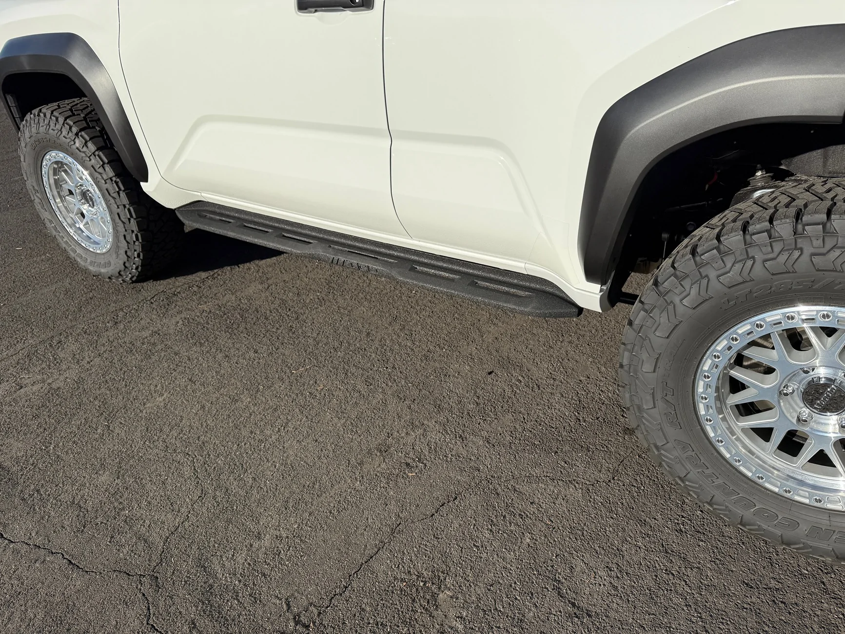

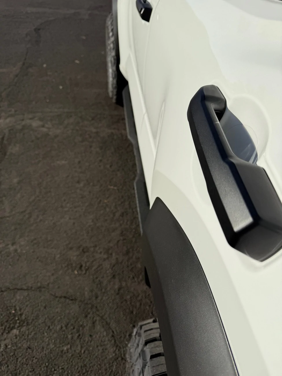

TRD Cast Running Boards
They look nice but don't serve much a purpose. The step area is very small. It fits the body contour nicely but looking back the electric fold down steps would probably be more useful as a step.
They look nice but don't serve muc a purpose. The step area is very small. It fits the body contour nicely but looking back the electric fold down steps would probably be more useful as a step.
Those look really nice. Much nicer than the factory ones on the ORP.
On my 5th gen that was pretty much the first things to come off. The stock running boards would mud up the back of my calves on my pants every time I would get out.
If it was raining or muddy conditions. People at work would say what's all that crap on the back of your legs! So these that you have look very low profile and away from your pants. Nice

They do look nice and fit well. Just not practical as a step. But they do fill the void of no steps like my initial pics show. And the dealer I bought them from had them for $950 so it seemed worth while.
I had sliders on my Tacoma and had the same issue you do with your steps. The sliders stuck out so far.

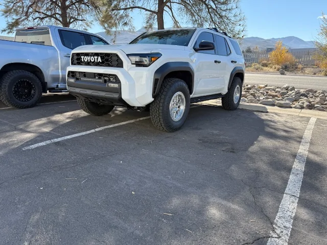

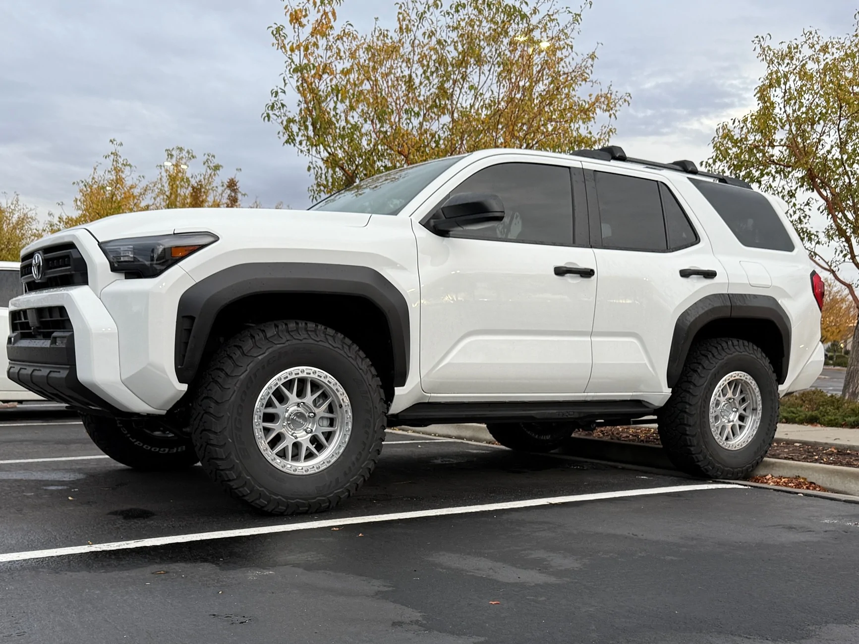

Bumped up to 285/75R17 tires. Looks a lot better IMO. The the 285/70's looked small. I did swap these BFG's out for Toyo AT3's. The BFG's shook pretty bad despite the the road force being within spec. The Toyos are smooth.
2025 2026 4runner 6th gen SR5 build: 17x8.5 +22 offset ModCo M73, 285/70/17, 1.5" RC Leveling Kit and more to come IMG_0334
2025 2026 4runner 6th gen SR5 build: 17x8.5 +22 offset ModCo M73, 285/70/17, 1.5" RC Leveling Kit and more to come IMG_0333
4RNerAndScrubs
Nov 1, 2025
60
Ice Cap SR5+ 4wd
Nice setup! We also just bought our Ice Cap 4runner last week and bought the RC 1.5" Spacer lift to put a bigger wheel/tire setup. Do you have a photo of the Toyo AT3 in the 285/75? Also did you have to do any mods to make them fit? Love the look of the machined look when we first saw Wescott Designs Ice Cap 4Rnr.

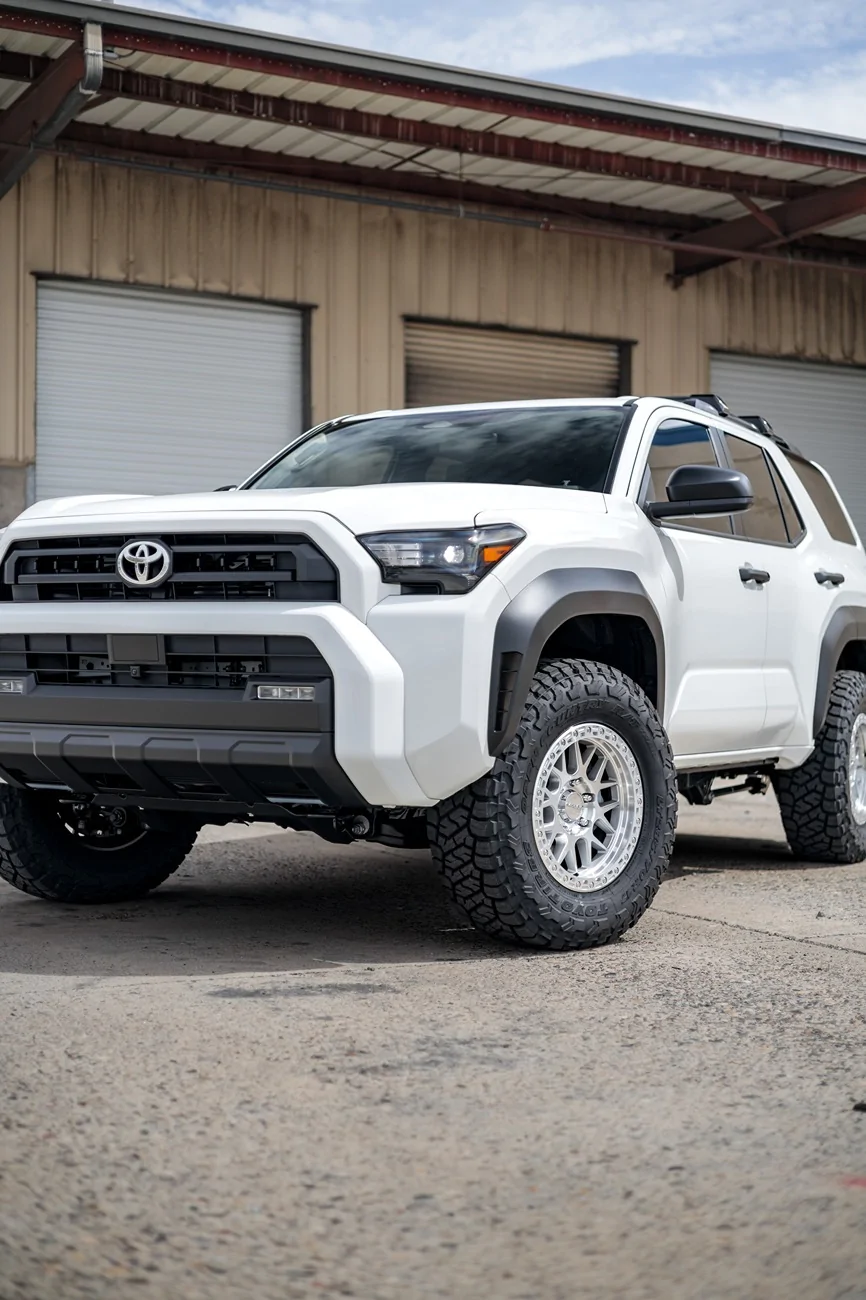

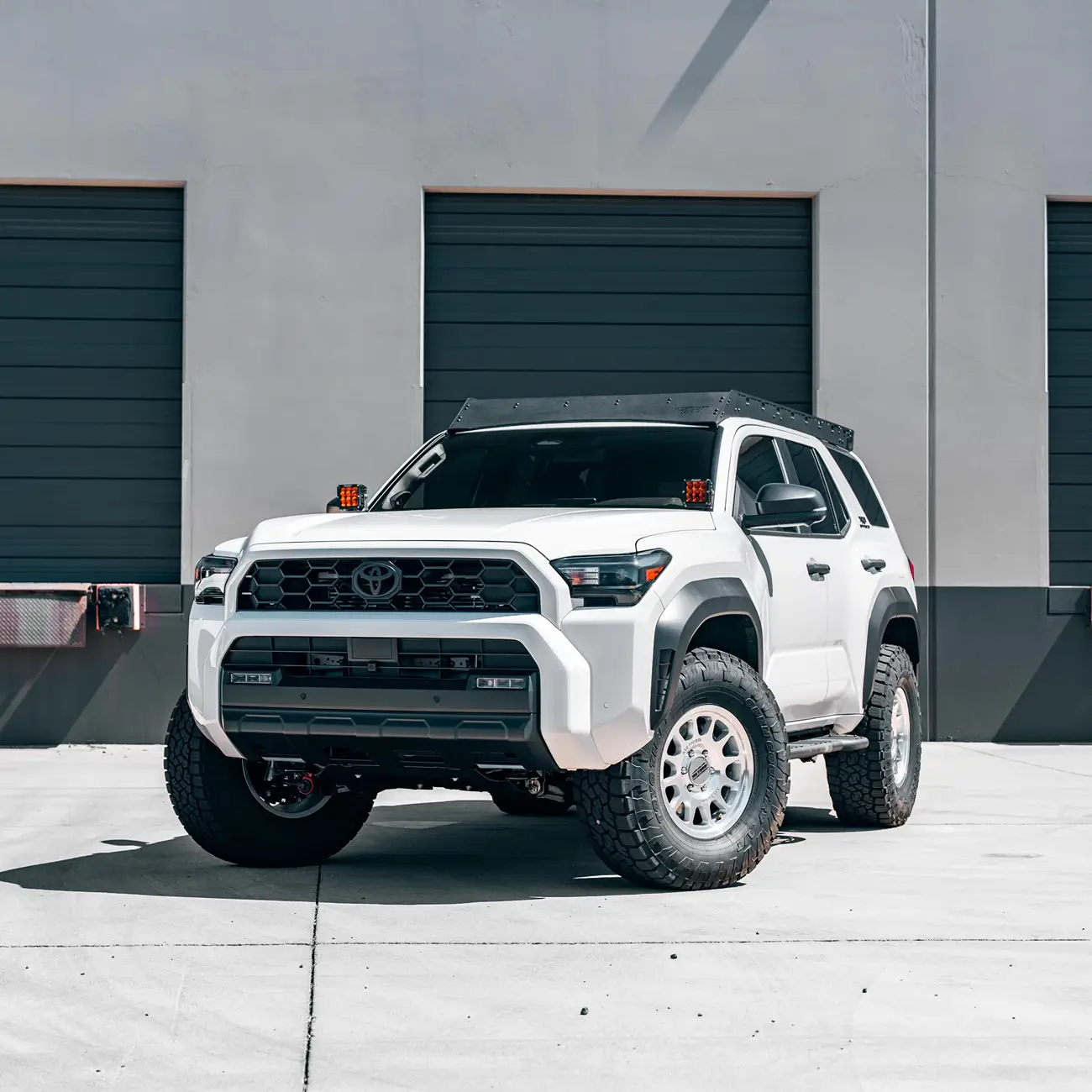

@4RNerAndScrubs I removed the plate near the fire wall and pushed the front of the fender liner forward. Here are a few pics. Weather has been crappy.

Nice! Seems like these 6G 4runner's can easily fit 35's with minimal mods to the wheel well. Thinking about 305/70/17 which should be the same diameter as yours but a 12" width.
