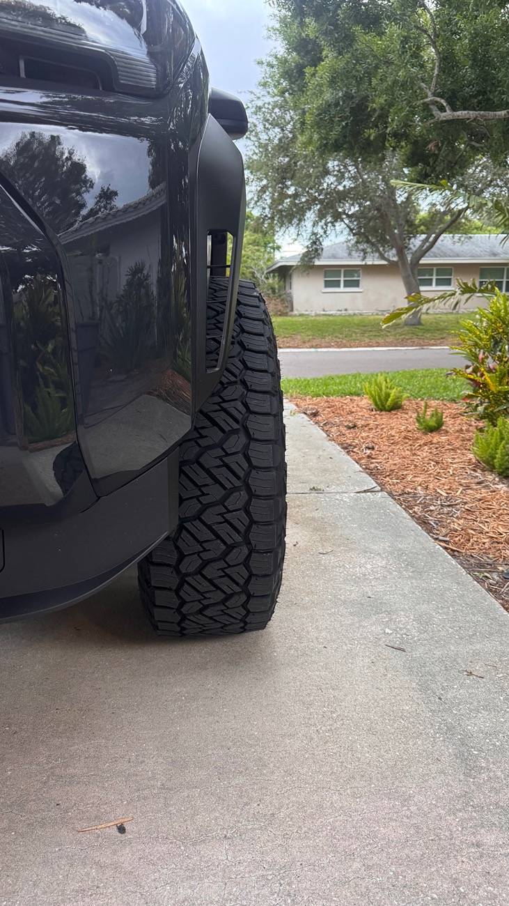

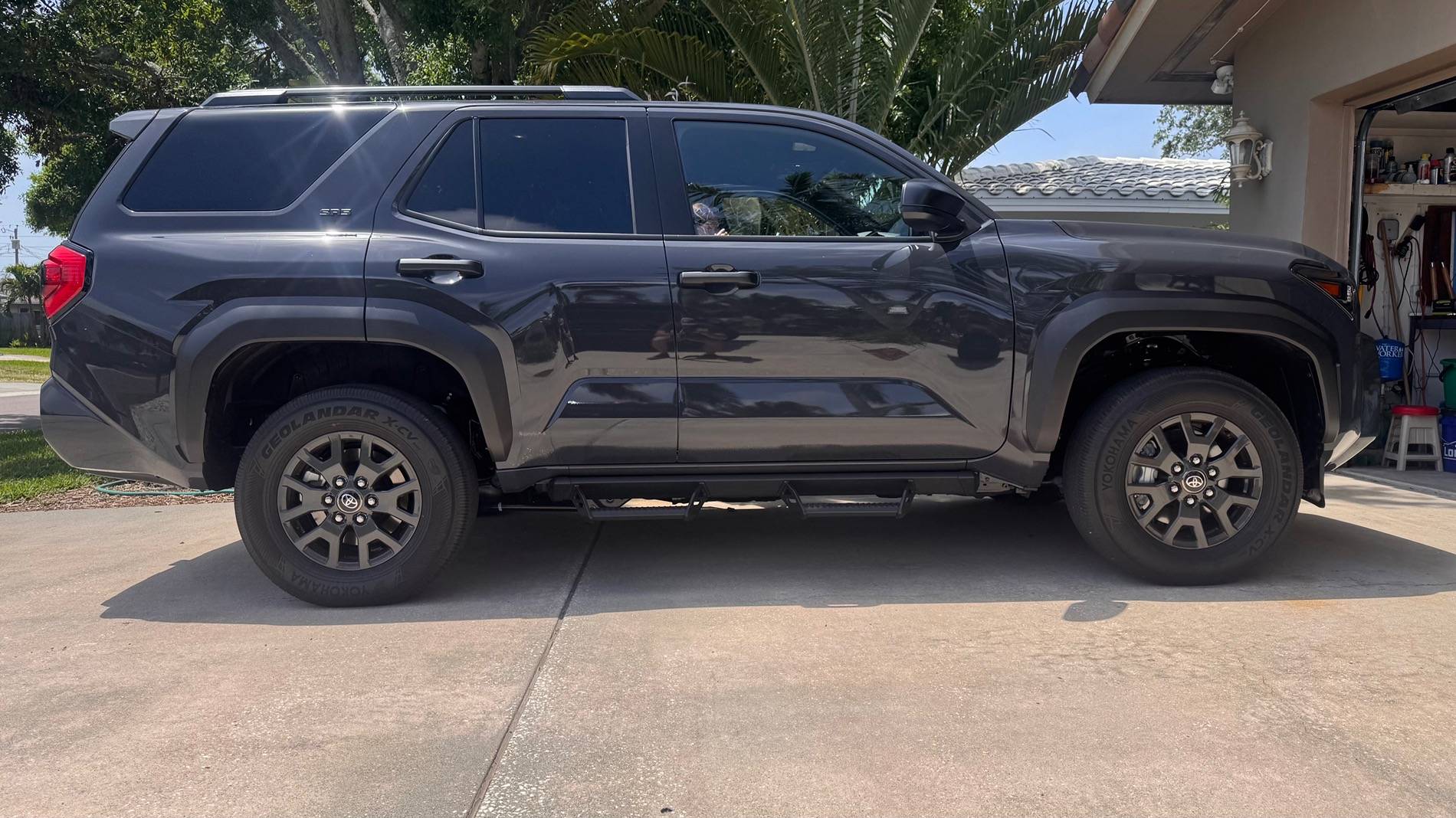

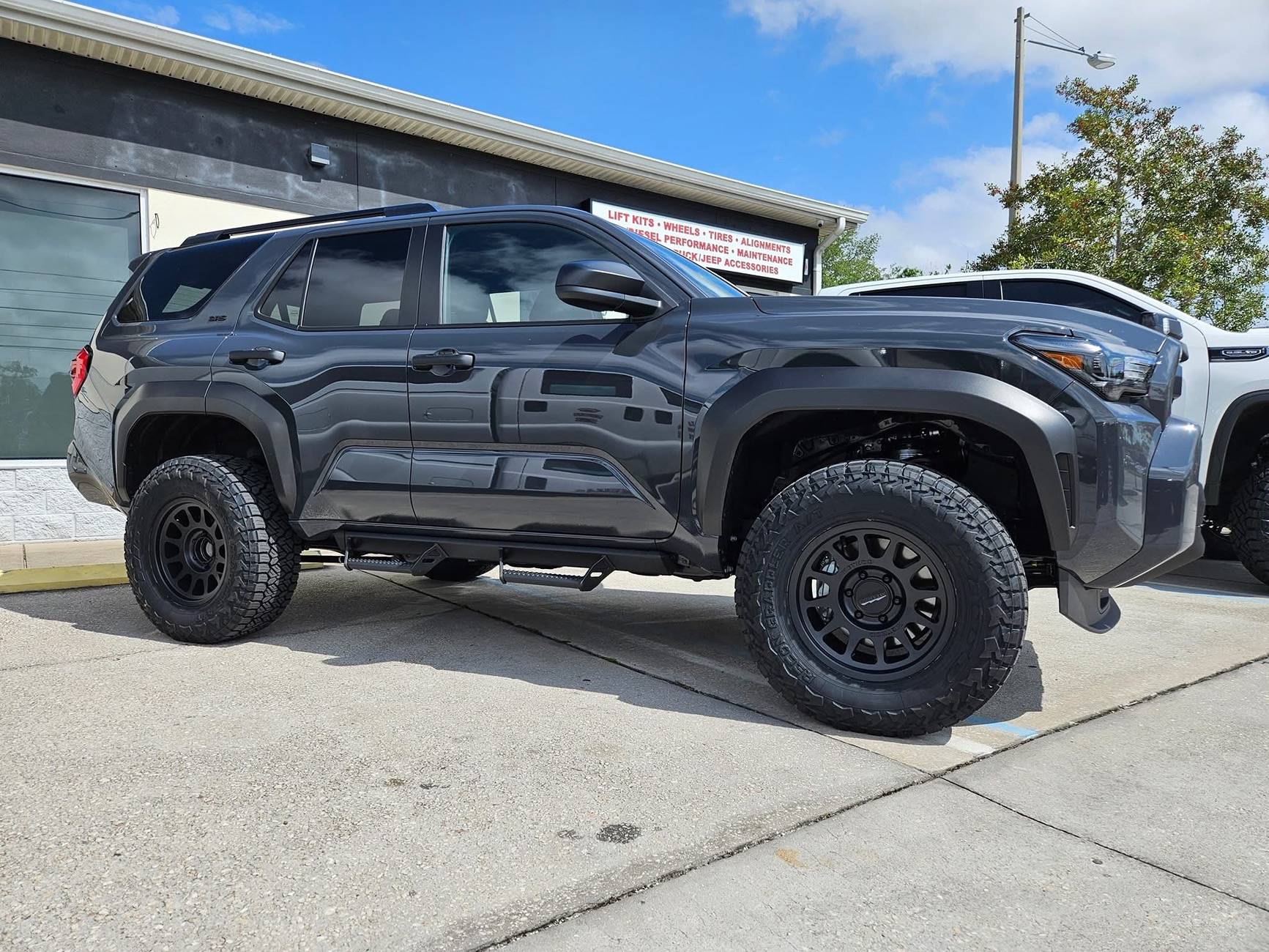

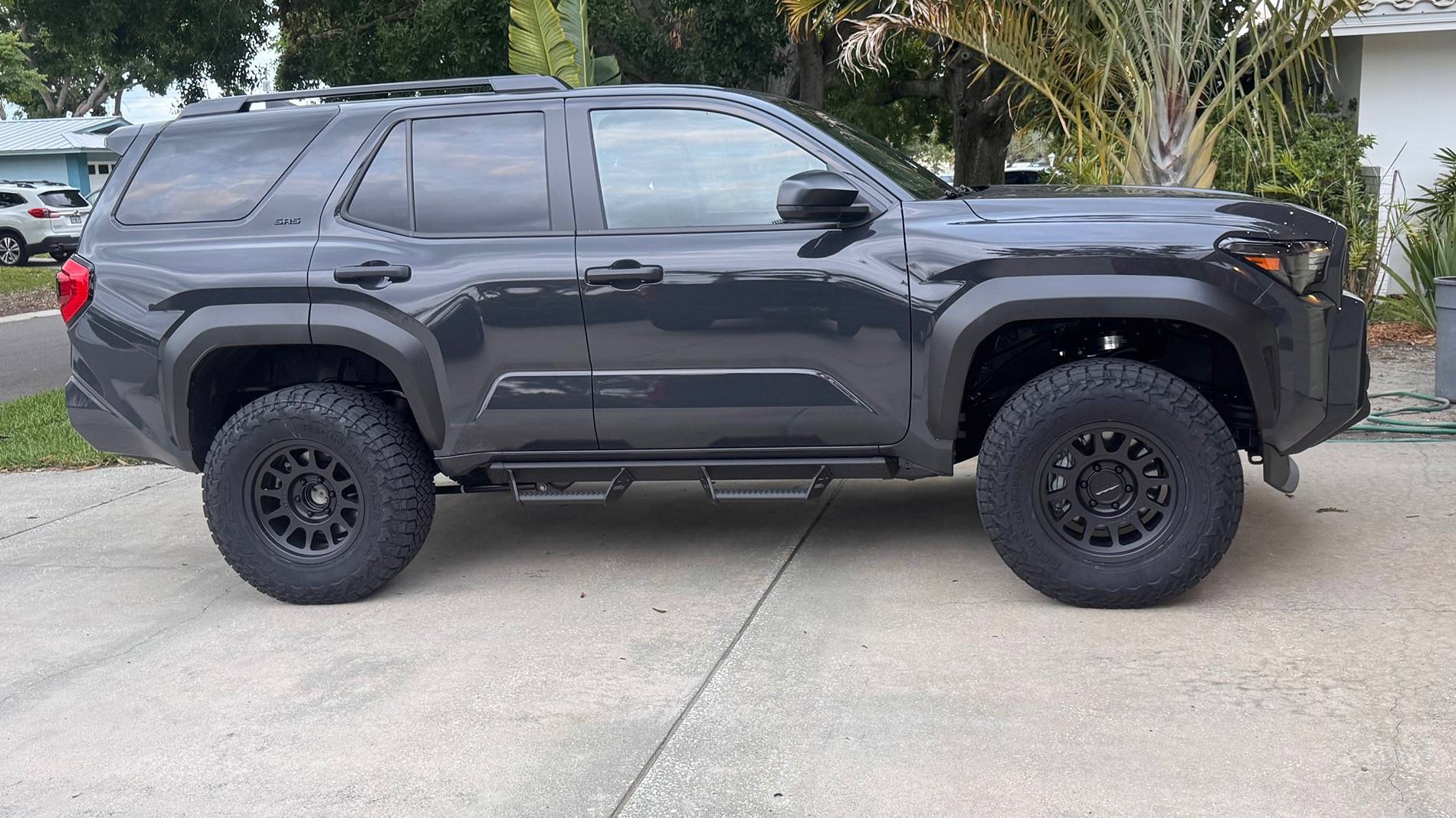

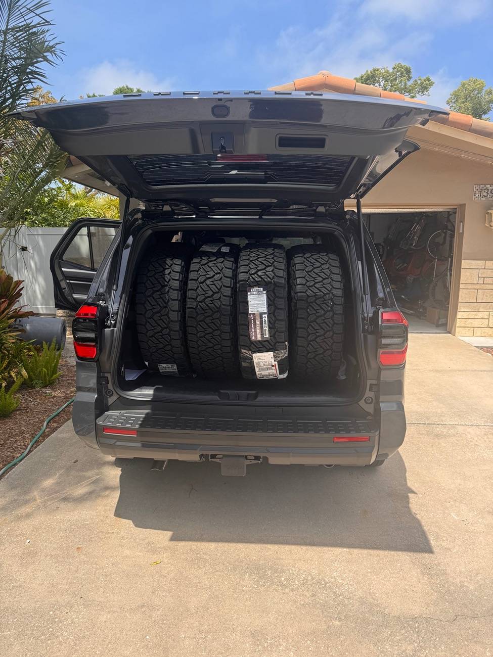

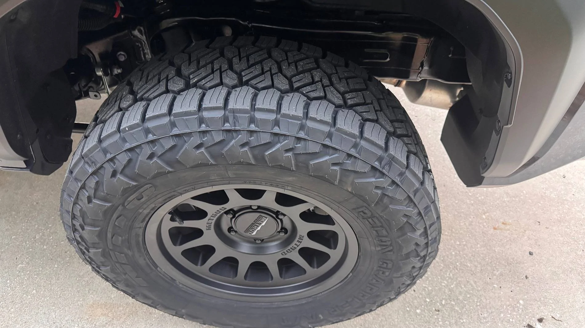

2025 4 Runner completed with a 2.5" ReadyLift Suspension Kit, 17x8.5 Method 703 Race wheels (+0 offset) and 285/70/17 Nitto Recon Grapplers

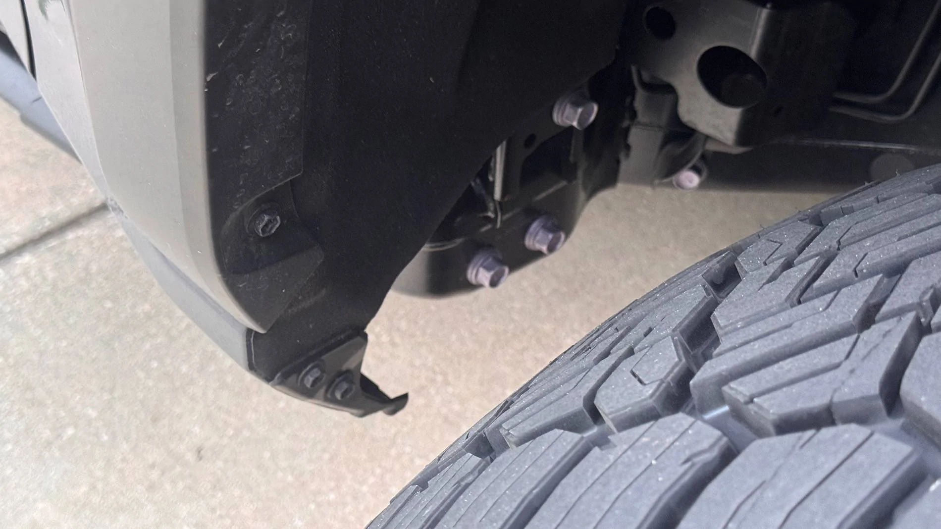

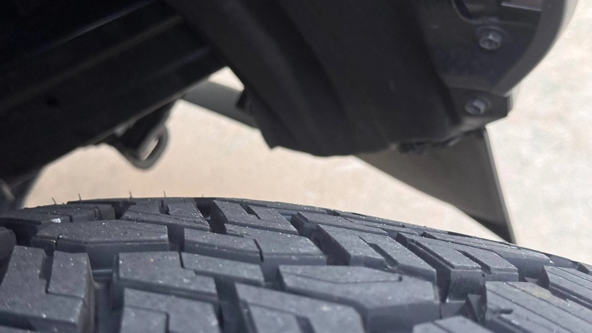

So far no Rubbing no cutting and just a minor adjustment to front inner wheel wells. The ride is very good and these Recon Grapplers are very quiet much like ATs
Everything fit easily in the truck for the trip to shop.

So far very happy with the steering and these tires produce less road noise than expected. The 0 offset Method 703's produced a little more protrusion than I was expecting, about 2". I was hoping to be flush with the wheel wells but meh.
There is a little more dive on hard turning for sure and the ride has stiffened up to where you feel your terrain a little more but still an amazing ride.

Yeah I hear many people are running +22mm to +35mm offset to reduce wheel poke. I did not realize that more positive offset = less wheel poke. :)

With that offset, your risking a lot of paint dings :oops:

Did you rub at all on this setup? and if so, did you have to do any modifications like trimming?
