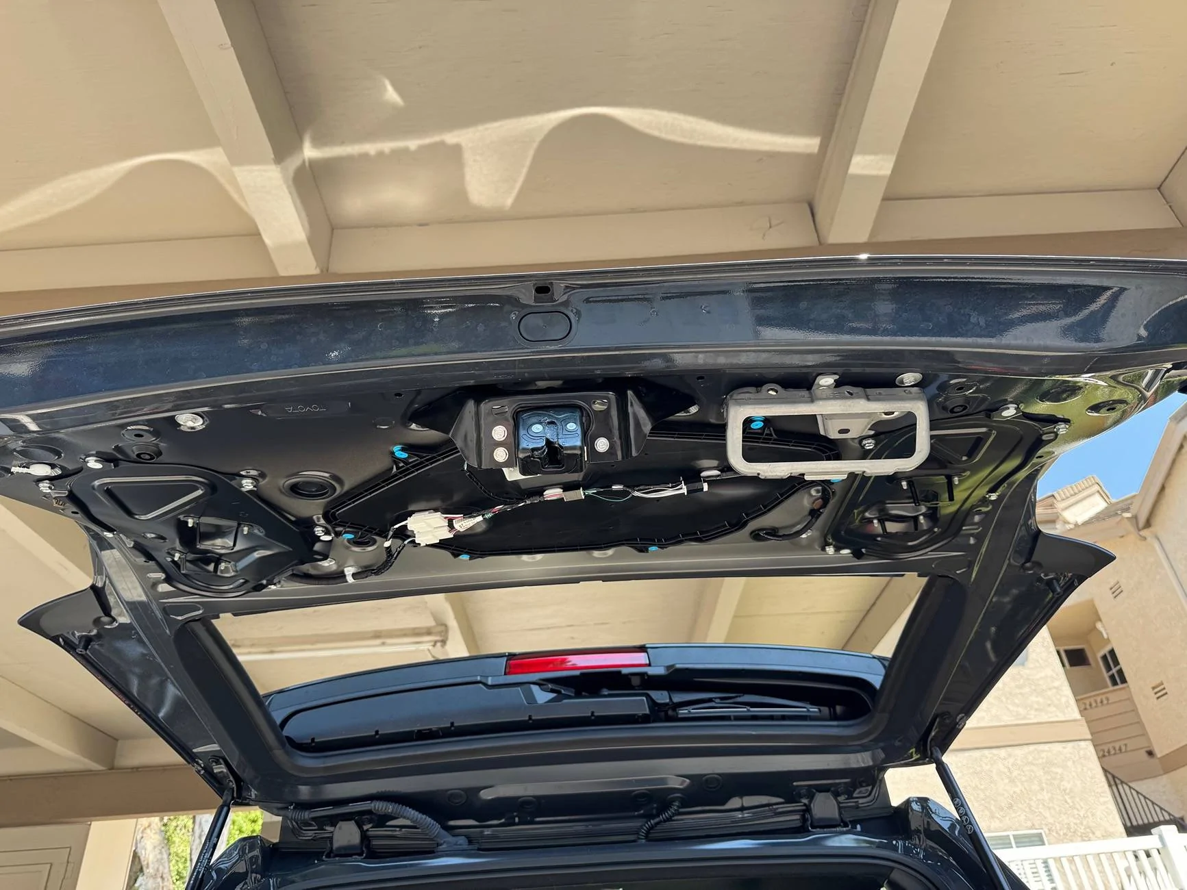

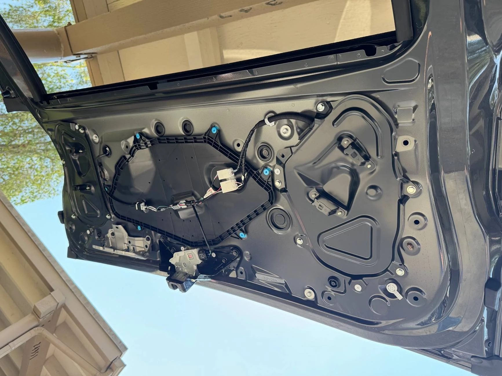

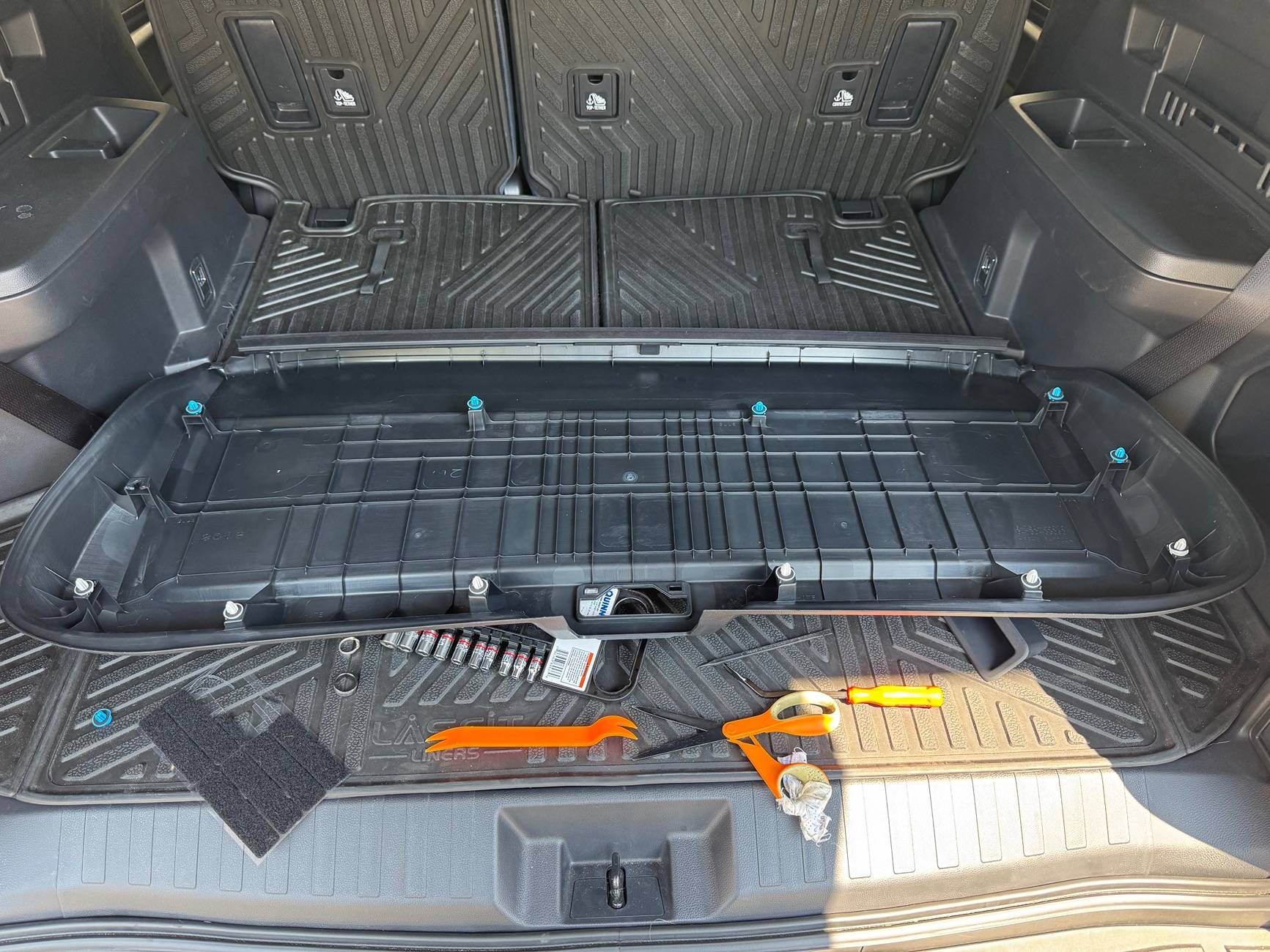

I have been chasing a rattle that seemed to be coming from the entire rear cargo area at random and I finally thought to look at the rear hatch panel.
If you’re having intermittent clacking and rattling this is the fix.
2025 2026 4runner 6th gen Rear Hatch Rattle Fix IMG_2687
2025 2026 4runner 6th gen Rear Hatch Rattle Fix IMG_2686
2025 2026 4runner 6th gen Rear Hatch Rattle Fix IMG_2688
2025 2026 4runner 6th gen Rear Hatch Rattle Fix IMG_2690

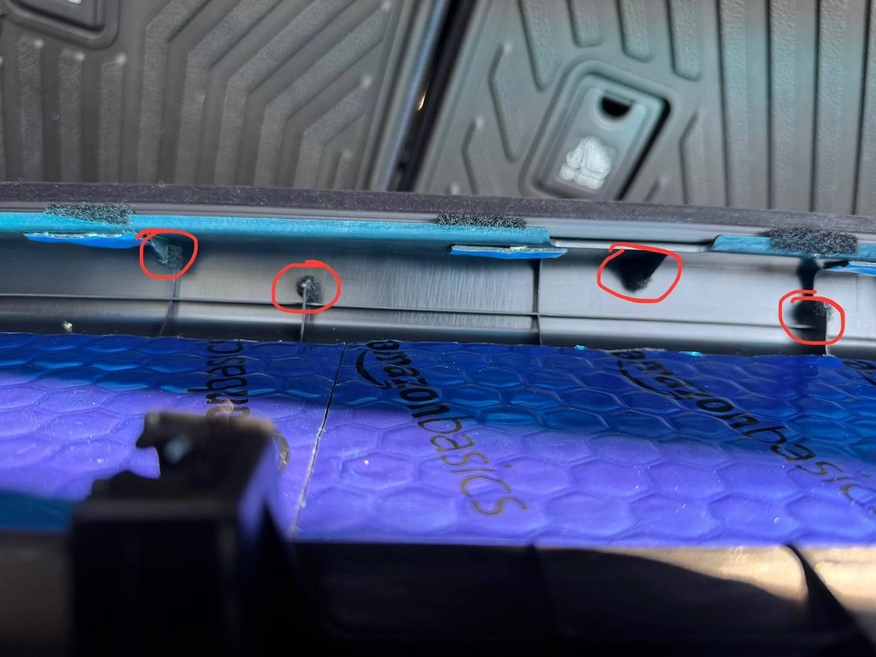

These highlighted red circles areas are the principle offenders. You’ll see that I added soft Velcro literally everywhere on this panel during my diagnosis but the immediate fix was these areas. What they are supposed to hold onto is the lip of the hatch frame behind the rear window, but it does not fit snugly enough to not rattle back and forth. Adding the Velcro immediately silenced any and all rattles back here.
