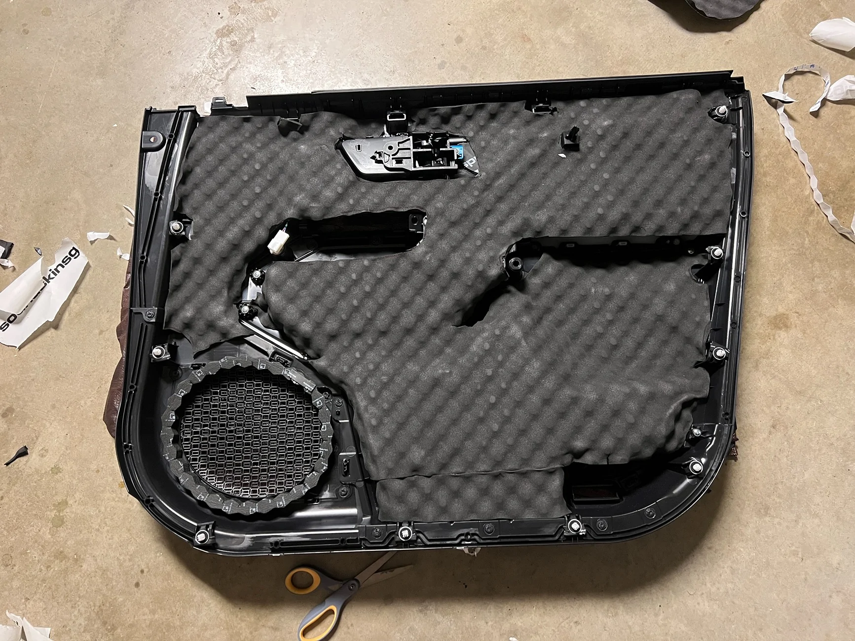

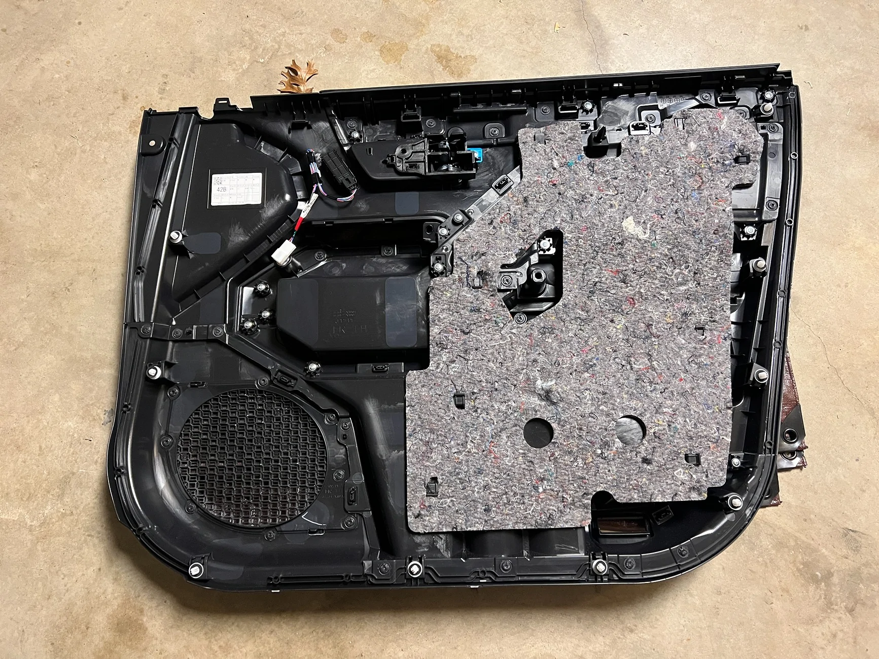

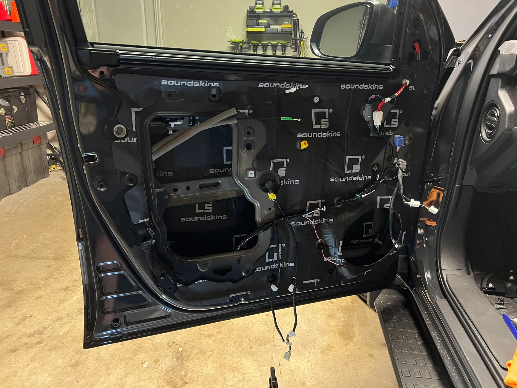

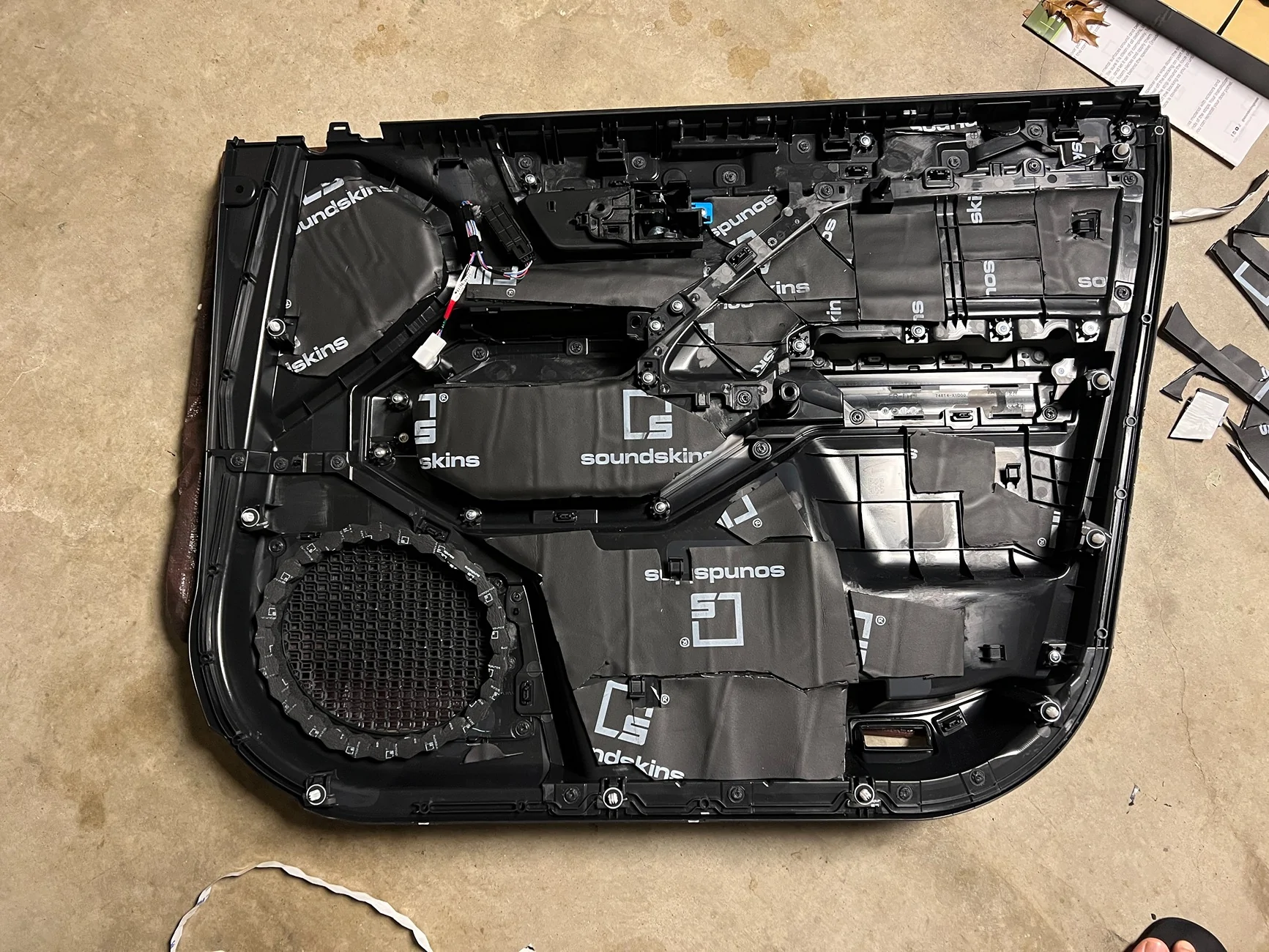

This is a fantastic write up, and it seems to have quelled the metallic rattle I would get out of the passenger door. I could reproduce it by striking the heel of my palm on the door and listening to the right side of the window.
I heard it more on choppy (read: not so much potholes) road surfaces, than music bass.
I also added some Tesa wiring harness tape here and there on the panel for good measure, along with the amazon basics insulation sheets.
No one should waste time at the dealer trying to get them to hear it, it takes 45-60min at home with very basic tools.
The most difficult thing was actually just getting the door puddle light connector unclipped!

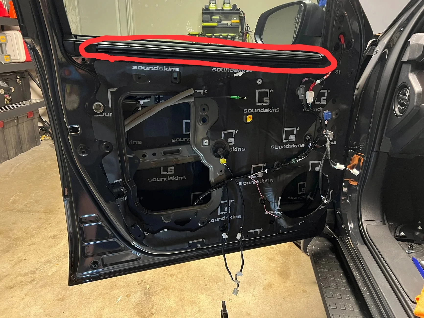

I took apart my door and mine was related to a piece of metal that ran behind the window channel in the pictures here. It was a non painted chrome type 1/4 diameter tubing of some type that ran from behind the window channel to the upper portion of the door where the rattle is from. Its very loose and if I touched it you could hear the exact rattle on the pilar behind the window.
I didn't take any pictures and I did a rush job because its over 100 out today, but I shoved a thick piece of foam between this piece and the back of window channel and the noise is now gone. I will return later in the fall to redo everything and also apply more sound deadening as well.
