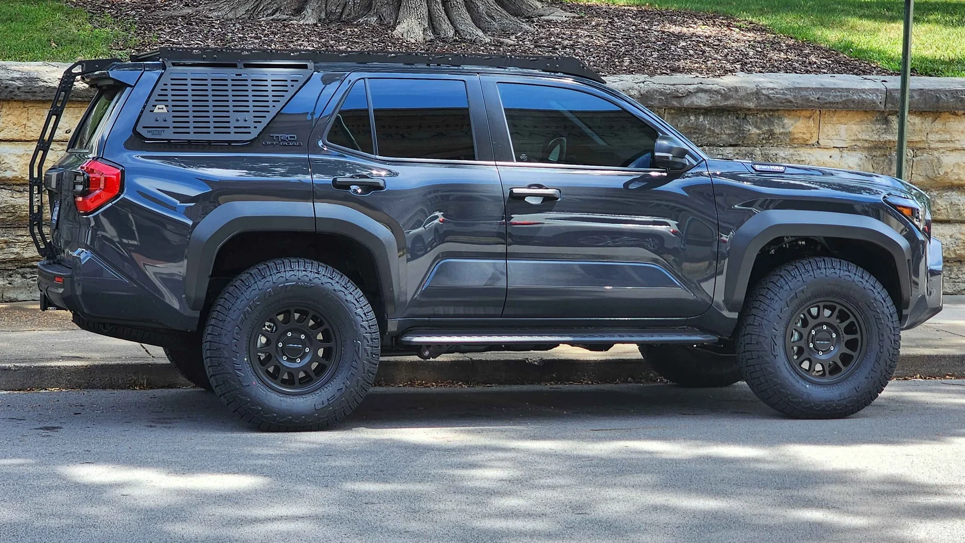

Finished with the base mods, now oh to phase 2 where the self recovery mods will start. Every time I still stop and smile for a moment.
Westcott roof rack
Westcott window molle panel
Westcott rear hatch ladder
Westcott spacer lift
Method Racing 703 17x8.5 +35 offset
Wildpeak A/T4 35x11.5

Looks good and welcome to the site. What are your wheels & tires specs?

Love 6th gens on 35's. Looks perfectly sized and scale.
What mods are next?

Waiting on a full bumper most likely so I am planning next major upgrade is portals and see how they run on the 6th gens.

Looks great! Just wondering, what is your solution for a spare? Or are you just leaving the stock size?

What brand roof rack, I see Sherpa and green line

How was ladder install? Does it pass the shake test strength wise? I know it’s bolted to the spoiler wing up top but that’s made of plastic. Hope it’s strong. My westcott ladder is on the way.

Looks so good dude!
On the 703s, do you have to use a spacer/ring thing on the hub to run them on this smaller hub?

Well i am 320lbs and holds me haha. install wasnt bad other then the bottom bracket and that was just issue where i drilled it wanted to rub on the tract for the window

just used the standard spacers that came with the wheels and worked perfect. +35 offset let me not have to mess with much.
