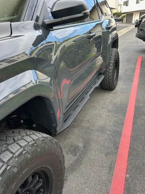

Sorry - Here are some photos. The tread sticks out about 1" vs the +25s I had that only the sidewall stuck out past the fender. Hope this helps
All good! It does help knowing the tread sticks out about 1". Would you say the lip of the wheel lines up with the fender?

No probably out past the fender by 3/4 inch

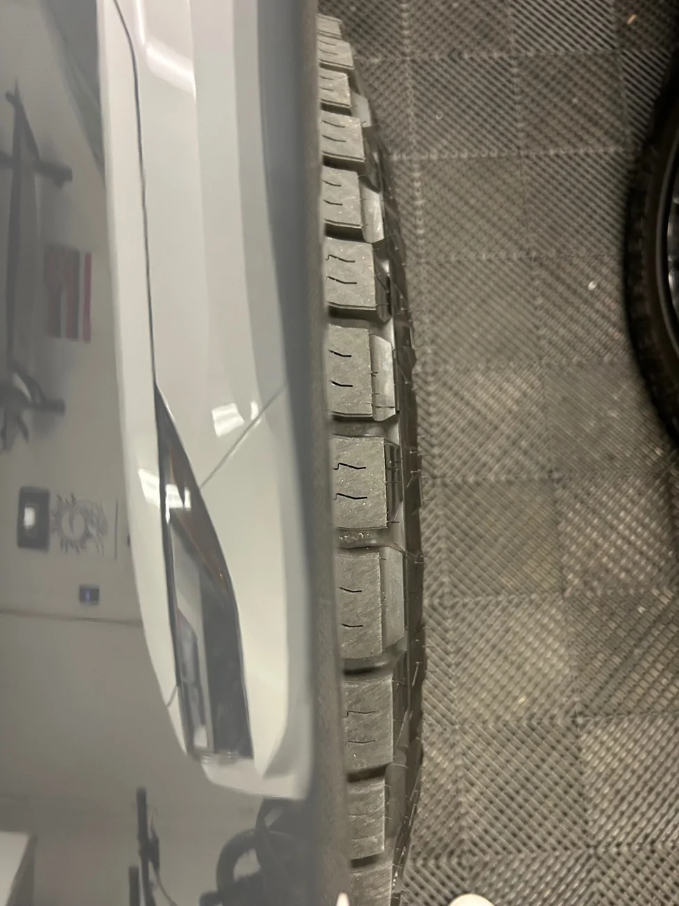

This is from the top of the front fender

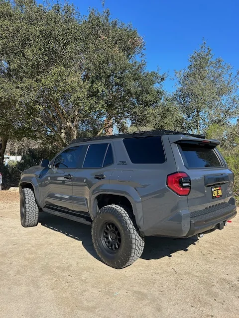

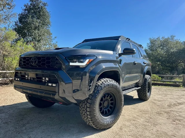

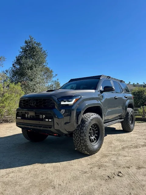

I’ve been working on this TRD Off Road build for a solid six months now. Lots of upgrades, a few changes and a couple different iterations of wheels and tires. Feel like it’s time to enjoy it for a bit…
Current mods:
ReadyLift 3" inch SST lift
TRD Pro billet upper control arms (UCA)
Differential drop
Skid plates to accommodate the differential drop
Wheels are 17x9 +12 offset Black Rhino Rapid wheels
Tires are 35" Toyota Open Country AT3 - 35x12.5x17 (super lightweight set up for 35s)
Seibon Carbon Fiber Hood wrapped in matte PPF
Limited Trim Headlights
Baja Designs fog pocket replacements
Baja Designs Squadrons behind the grill
Westcott Lo Pro roof rack plus roof top PPF
Katzkin black leather interior
TRD Pro side steps
NYTOP Axel Dump Exhaust and rear tow hook
SIXTH Intake
Sound system upgraded
