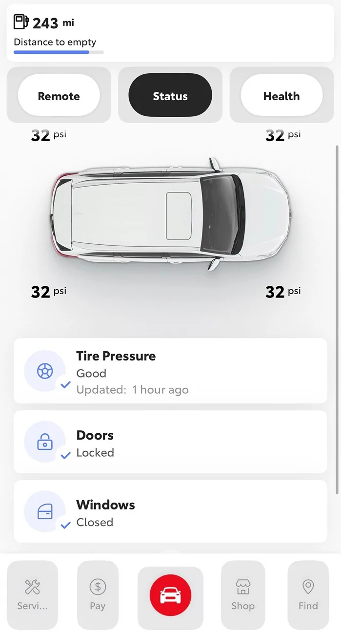

I have had a related problem but I'm not sure if it is the 12v battery or not (don't mean to hijack the thread) I have left my ORP Hybrid outside for 2+ week stretches 3 different l times this winter (work travel away from the cold in the Boston area). Each time I come back, the remote start never works, including from the mobile app (just times out). A normal key start works fine. I really wish they would add a battery health indicator to the mobile app. If they can get the tire pressure (see photo) from the 4R, why not the battery level? If the app could just provide the battery level, then if one was remote from the vehicle and got an alert about a low battery, one could remote start it to potentially charge it up.

It does show the charge status on the dashboard if you configure it to do so (I am assuming you mean the dashboard on the vehicle--if you mean the app, I agree--it could, and should, show more info.
