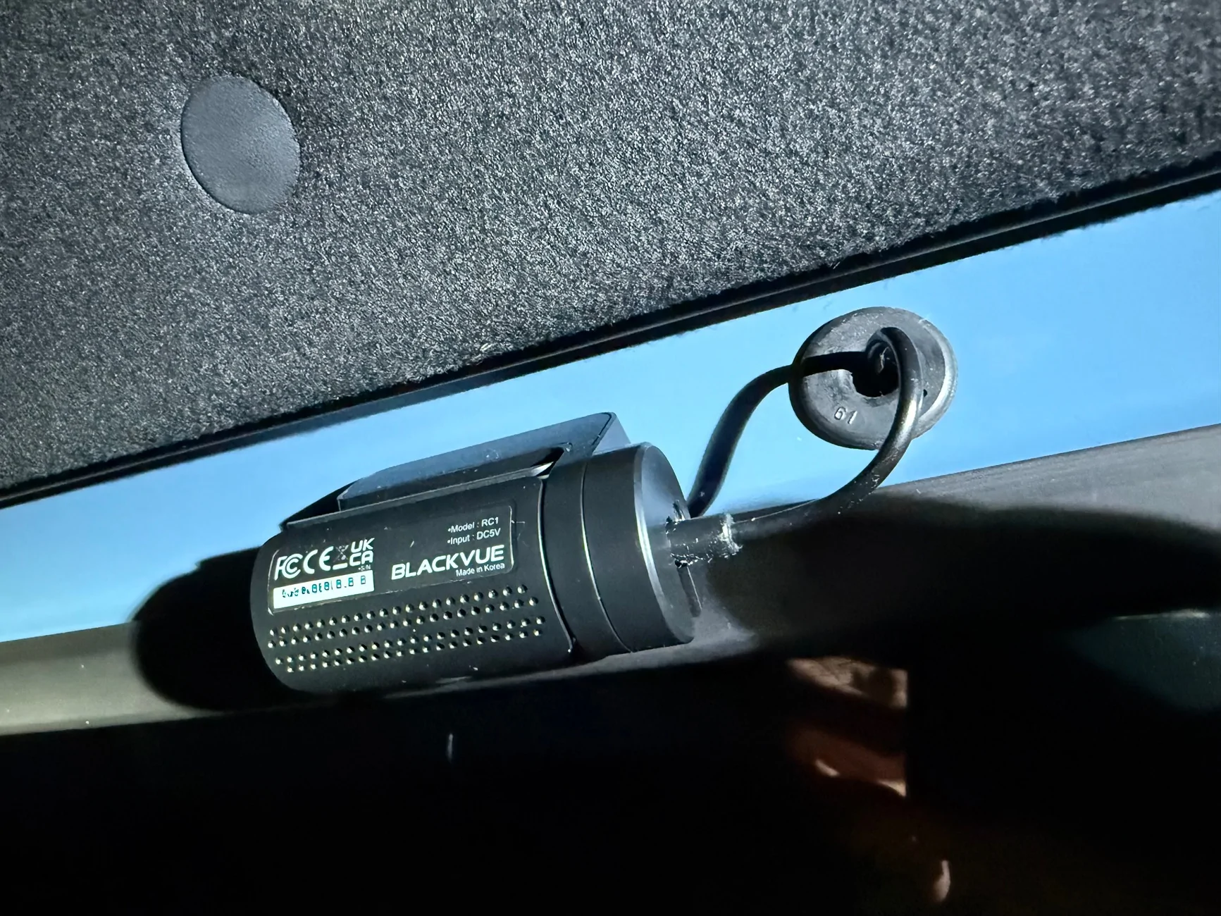

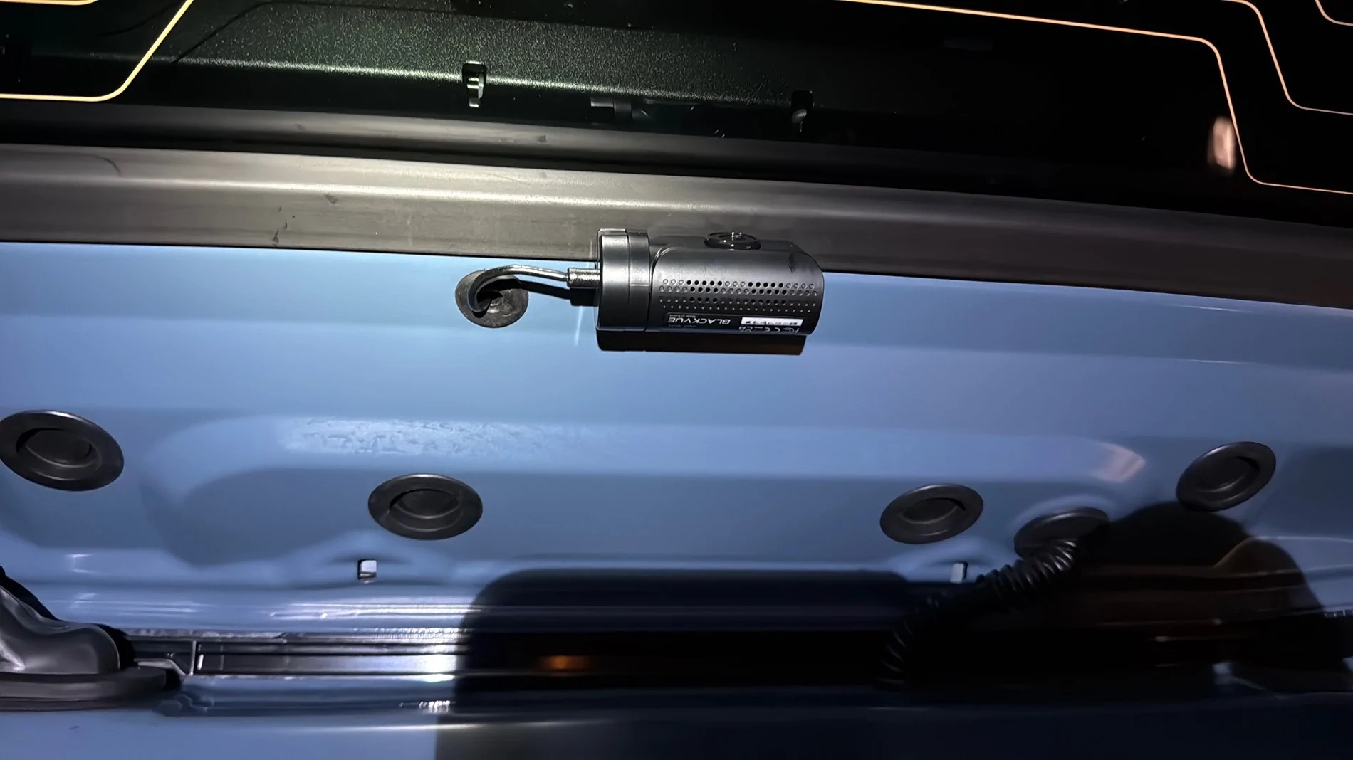

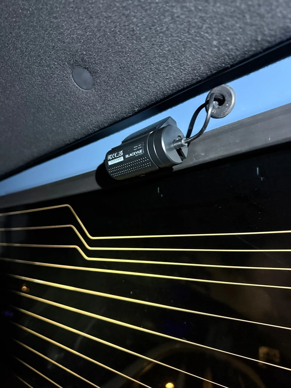

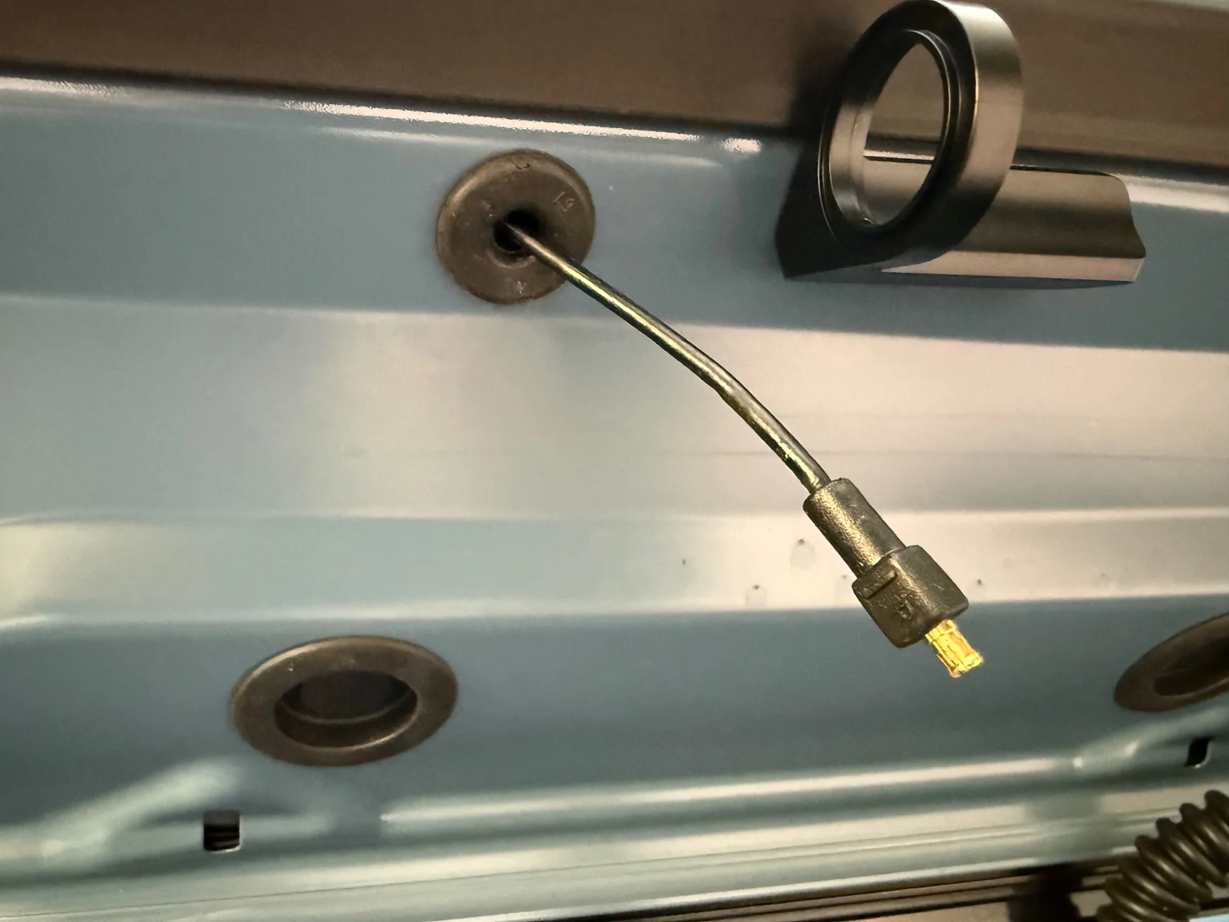

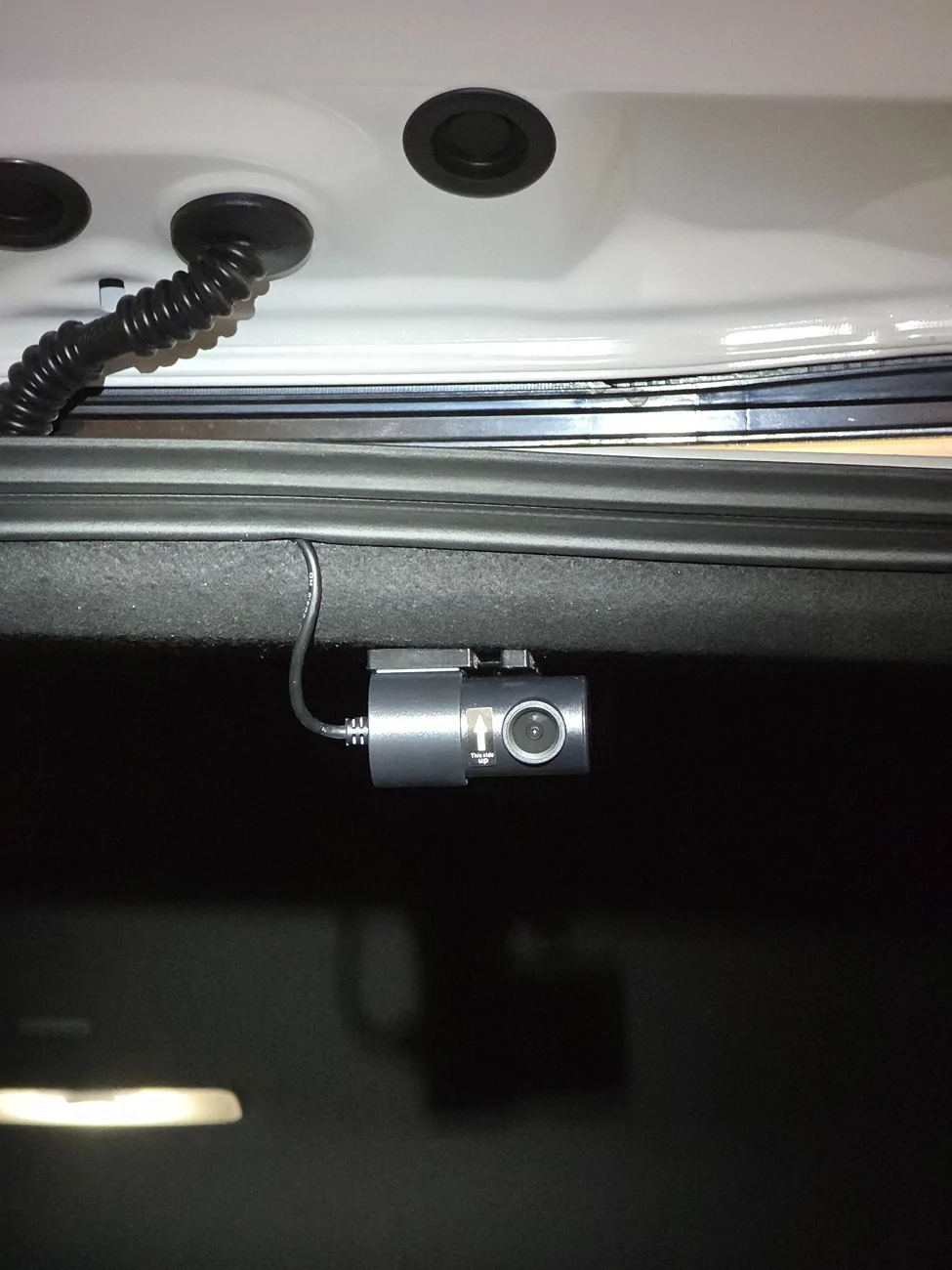

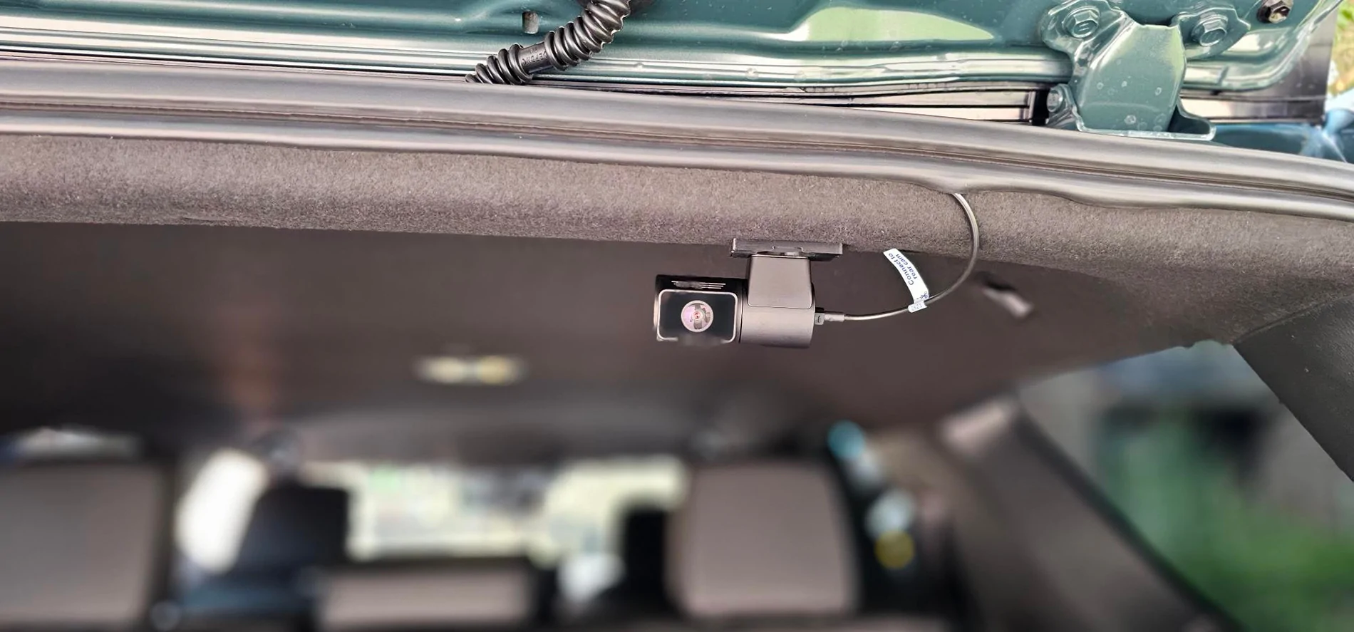

I really like keeping accessories on my 4Runner as OEM-looking and as discreet as possible. I donโ€™t like having cables or accessories sticking out and making the installation look aftermarket.
On the forum, I noticed that most people recommend using a mount that attaches to the rear roof area for the rear dashcam.
Personally, I didnโ€™t think that was a great solution. Not only does it look less OEM, but it also takes up valuable space. Imagine loading something large into the cargo area that fits perfectly, only to have it hit the camera because itโ€™s mounted on the roof. ๐Ÿคฆโ€โ™‚๏ธ
I thought there had to be a better way.

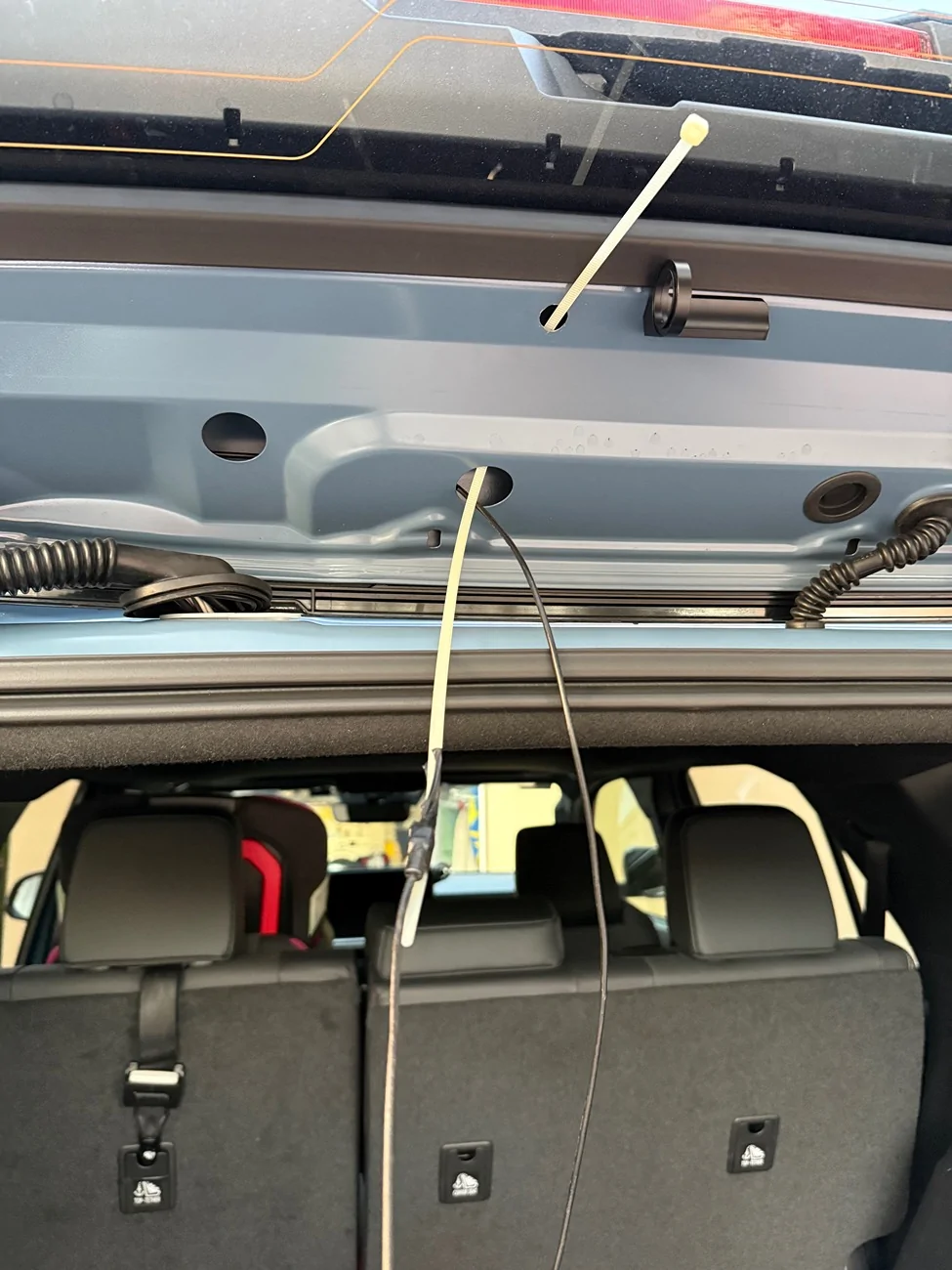

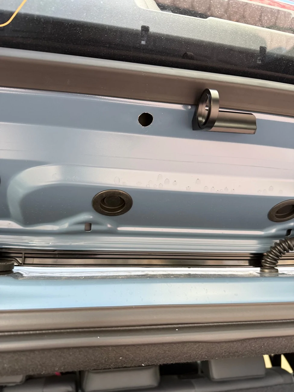

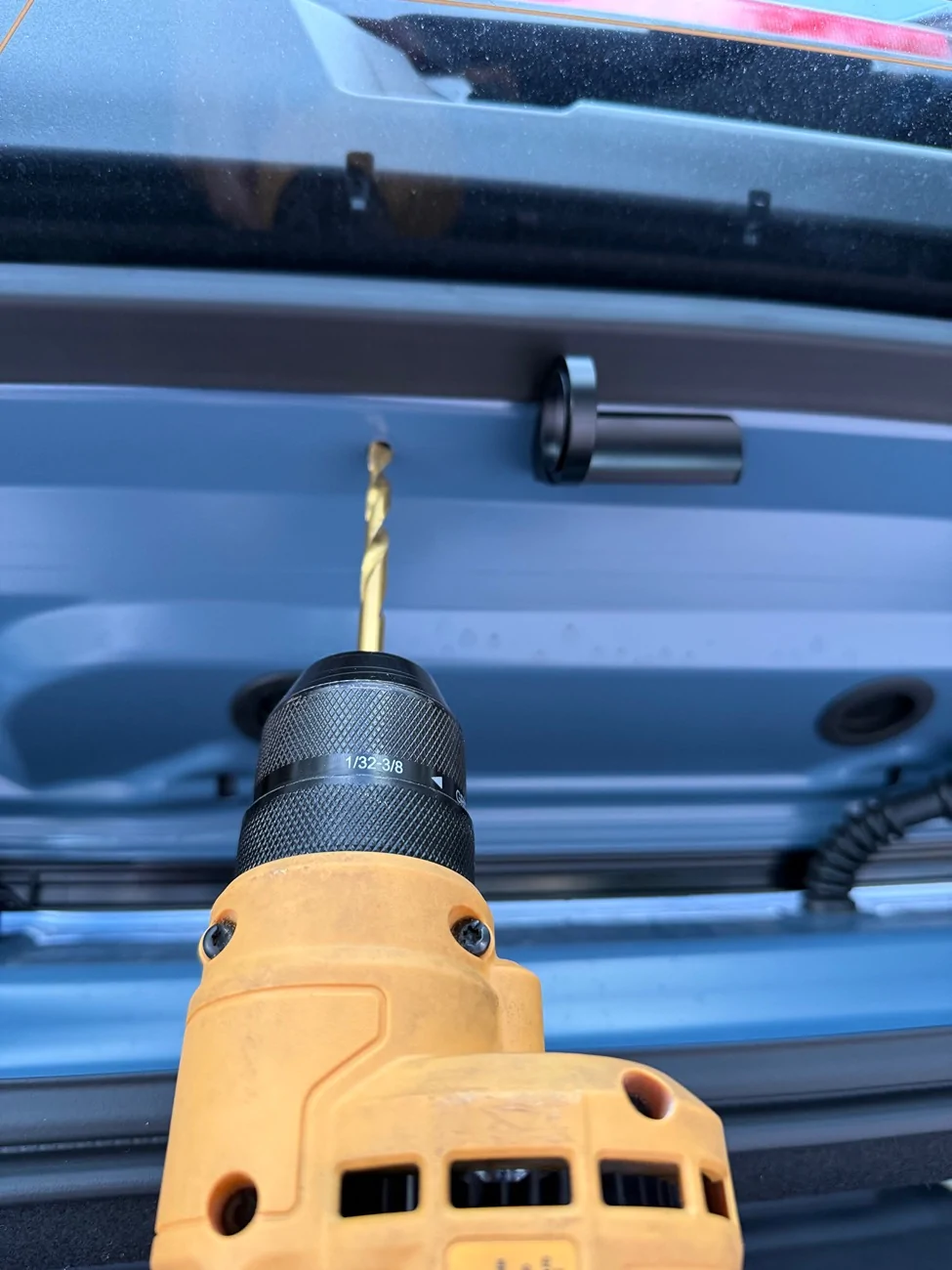

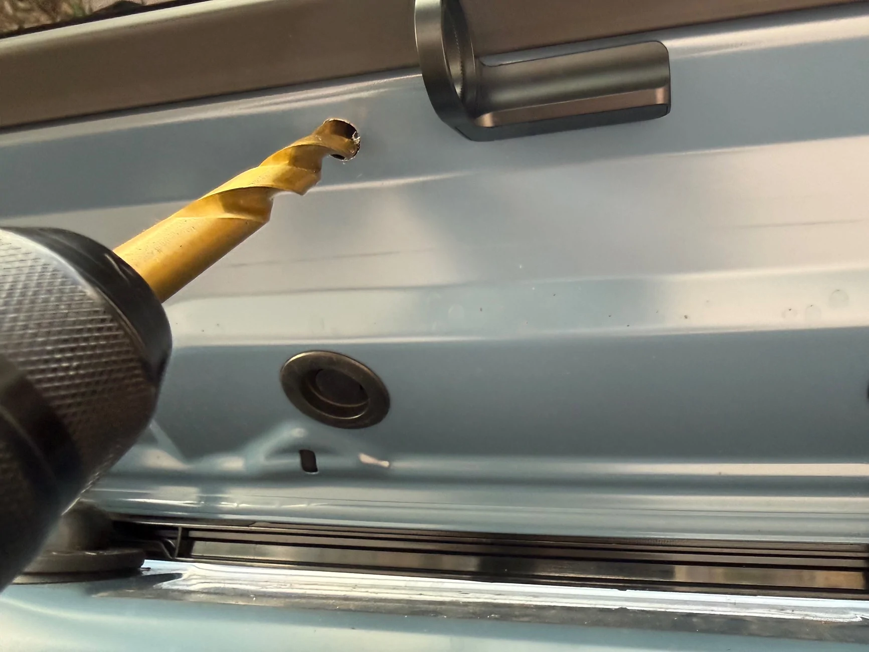

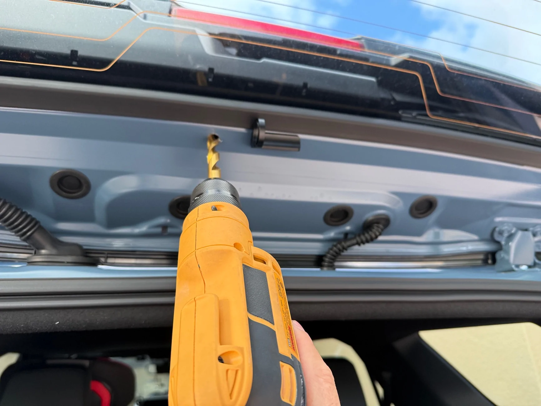

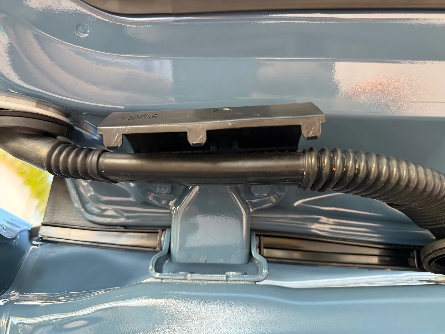

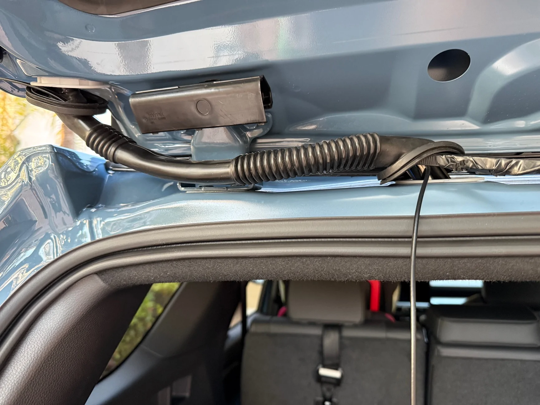

So I came up with the idea of mounting the rear camera directly to the tailgate and drilling a hole through the tailgate to route the cable inside.
I used a 1/2" metal drill bit and carefully drilled the hole. The result was exactly what I was looking for โ€” clean, discreet, and almost completely OEM-looking. ๐Ÿ‘Œ

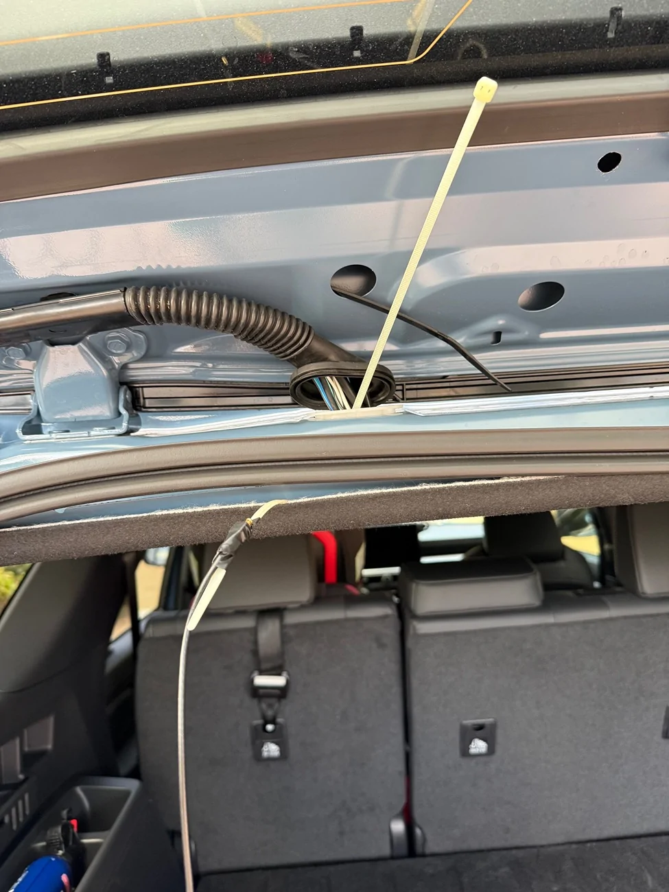

For my installation, I routed the cable through the larger plastic conduit where all the tailgate wiring runs.
BUTโ€ฆ after doing it this way, I realized there may actually be an even easier option: routing the dashcam cable through the smaller plastic tube that carries the water to the rear windshield washer. That route looks like it could be much easier for getting the cable through the tailgate.
Overall, Iโ€™m really happy with how it turned out. No camera hanging from the roof, no wasted cargo space, and a much cleaner look.
Sometimes the best solution is just thinking outside the box. ๐Ÿ˜Ž
What do you guys think? Would you drill the tailgate for a cleaner OEM-style installation?

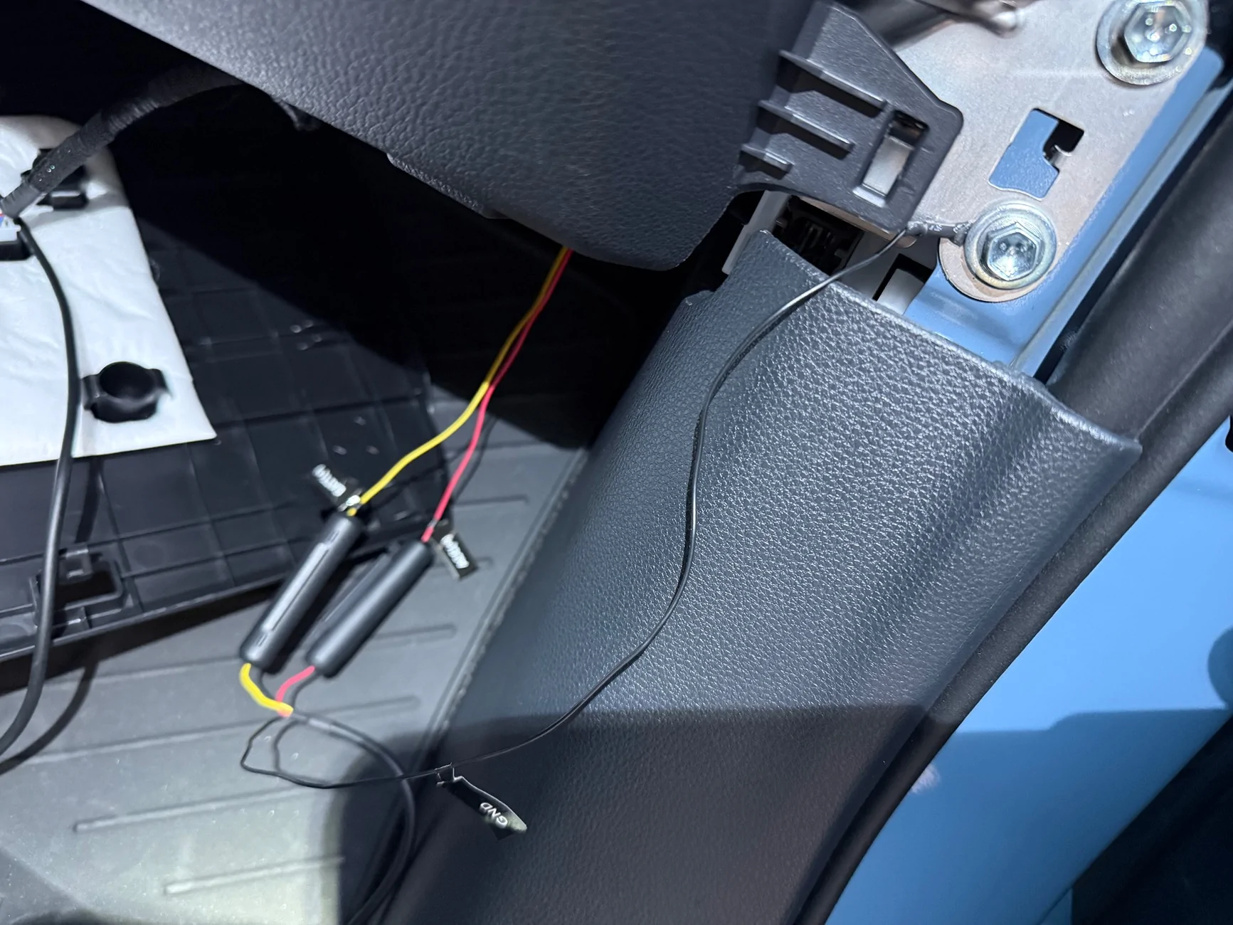

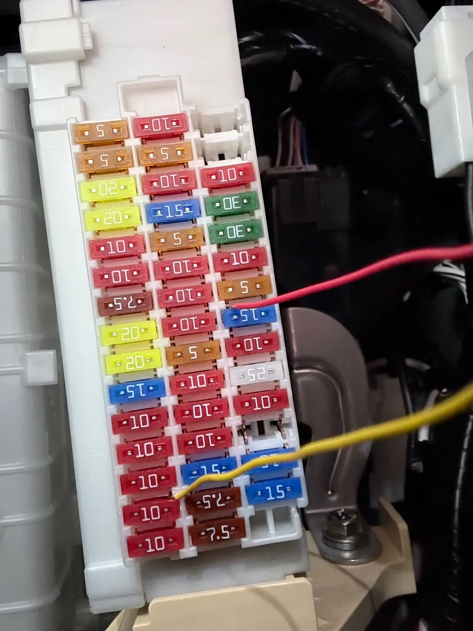

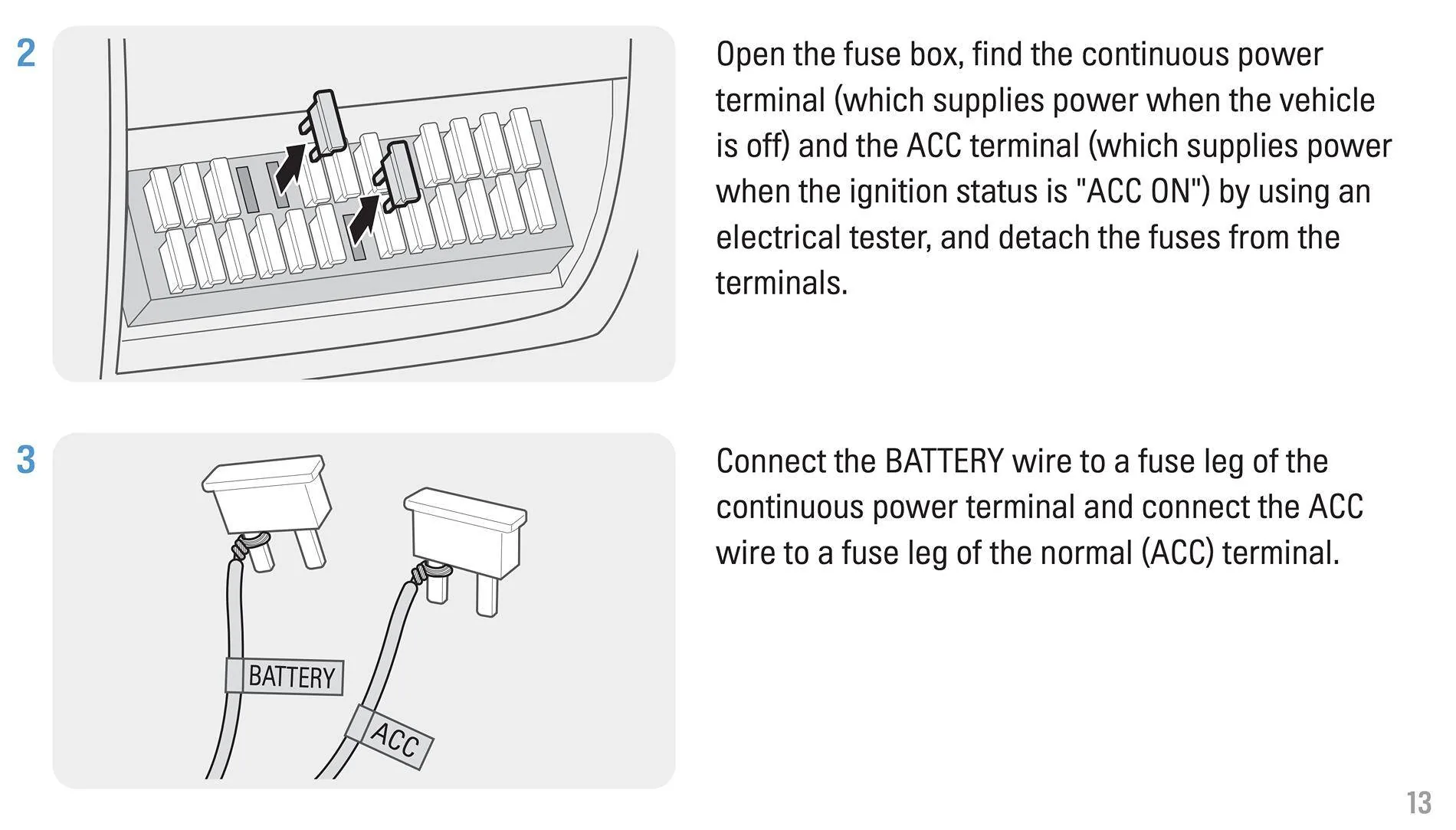

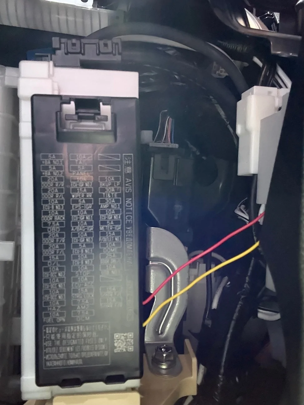

I also want to add that I installed the parking mode without adapters; I connected the wire directly to the fuse.
Are you on a hybrid or a gas 4runner? Also, which fuse box is this? I'm waiting for my unit to show up and I will need to hardwire it as well so I can have continuous monitoring. Was this fuse box on the passenger side?
Cheers!

Hi, yes, my 4Runner is a hybrid. That's right, the fuse box is on the passenger side, and the ground connection point is very close to the box.
Thank you good Sir. I'll keep this as a reference for which fuse to tap in. Cheers!

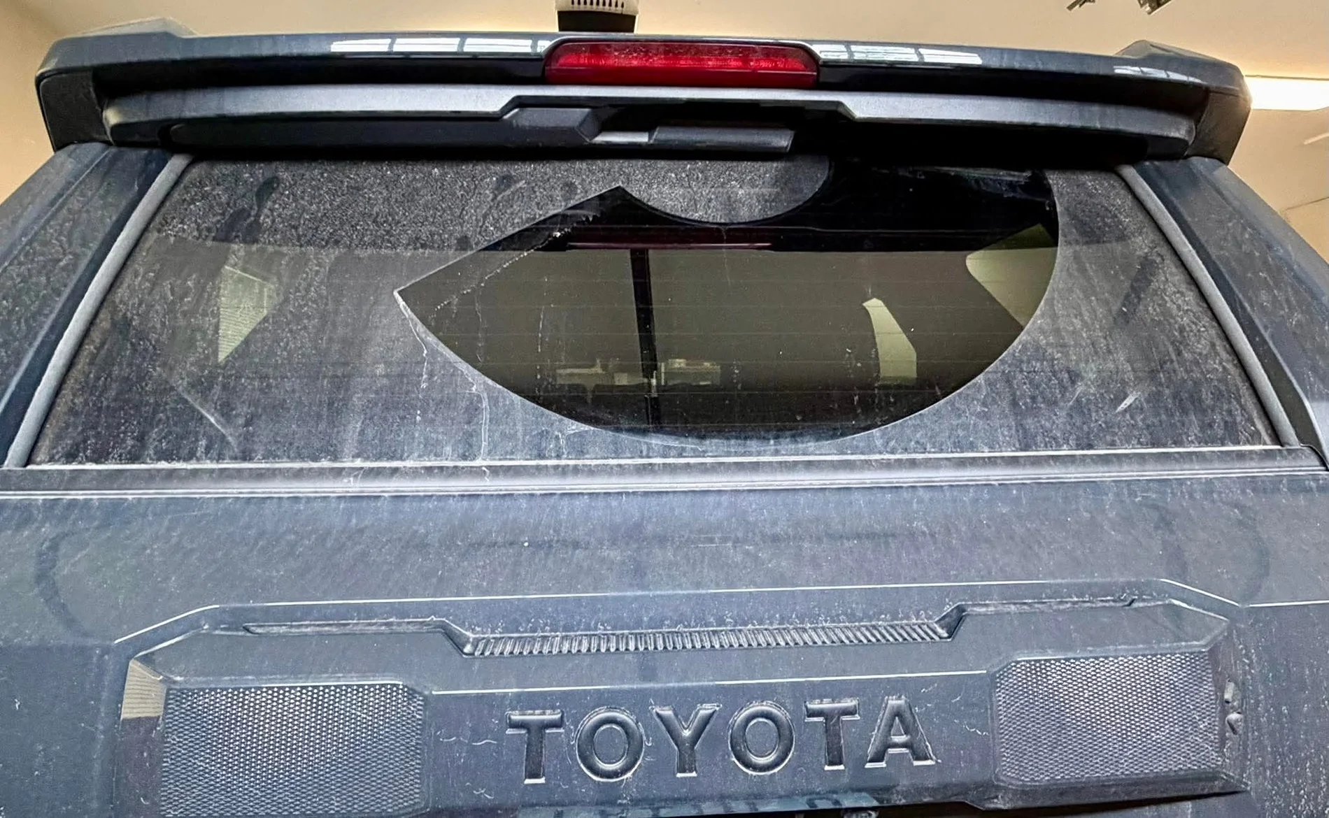

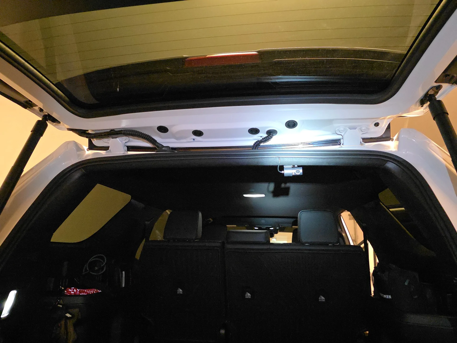

"clean & OEM" look.. Then proceed to drill into the lift gate ๐Ÿ˜‚
What's wrong with mounting on the headliner's clip?
Your solution is unique for sure, but what if you get rob while the tailgate is up when you're loading things into the rear? Your camera won't be able to see anything.
Having the rear camera on the headliner's clip ensure the rear is always visible to record. My camera is running on Dongar adapter even when the engine is off. I never hit it when loading stuff in there.

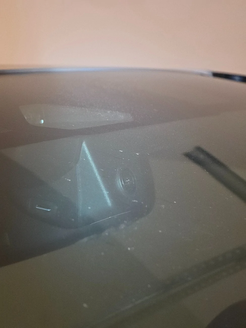

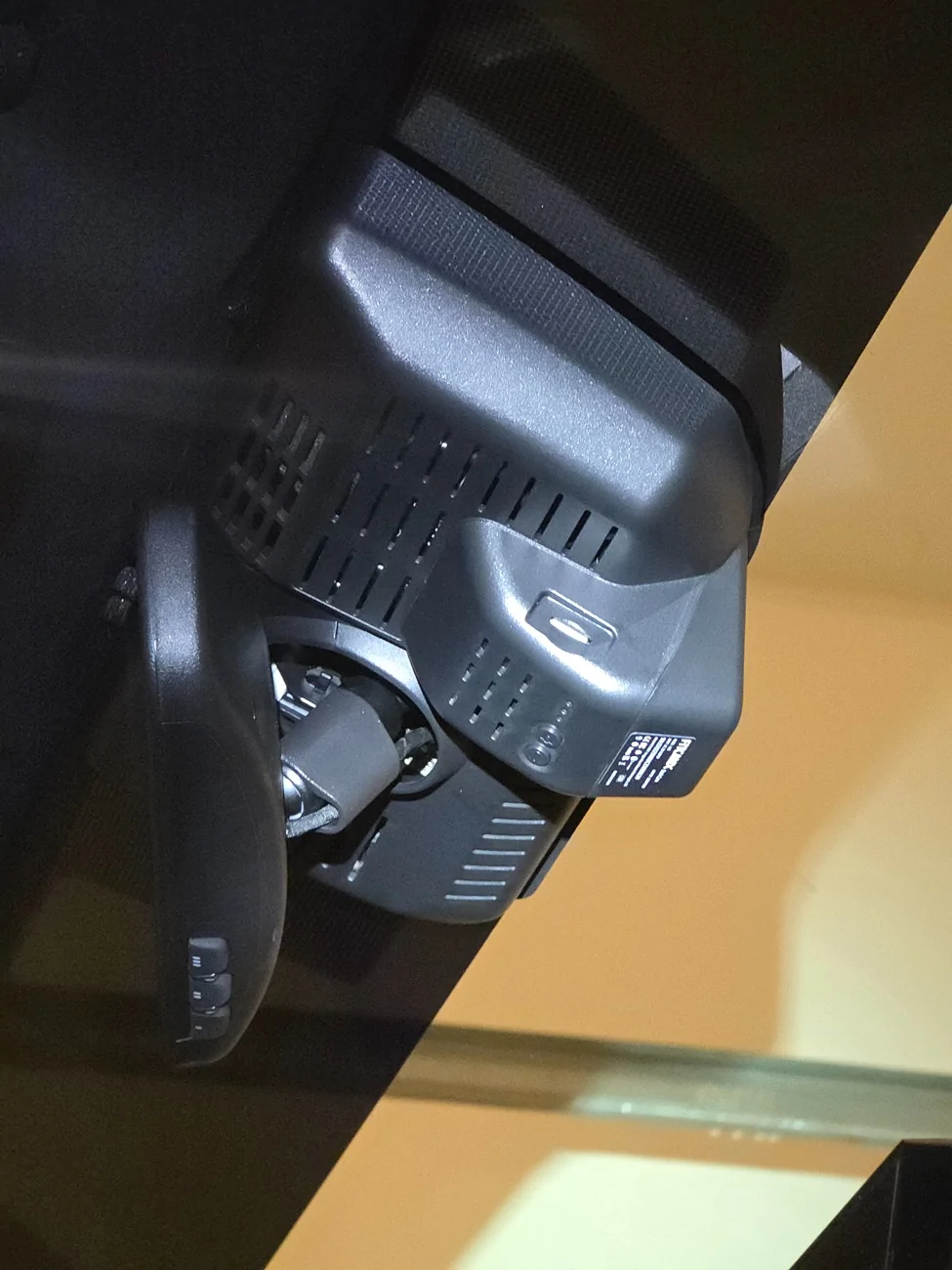

How do you have that rear camera wired, all the way to the front cam?
BonRunner
Dec 2, 2025
419
465
2026 TRD Sport Premium / WCP
Yes, I use the Fitcamx model, which is very popular & has clean OEM-look in front that mount under the rear view mirror. I run the wire for the rear camera under the passenger's headliner to the rear.

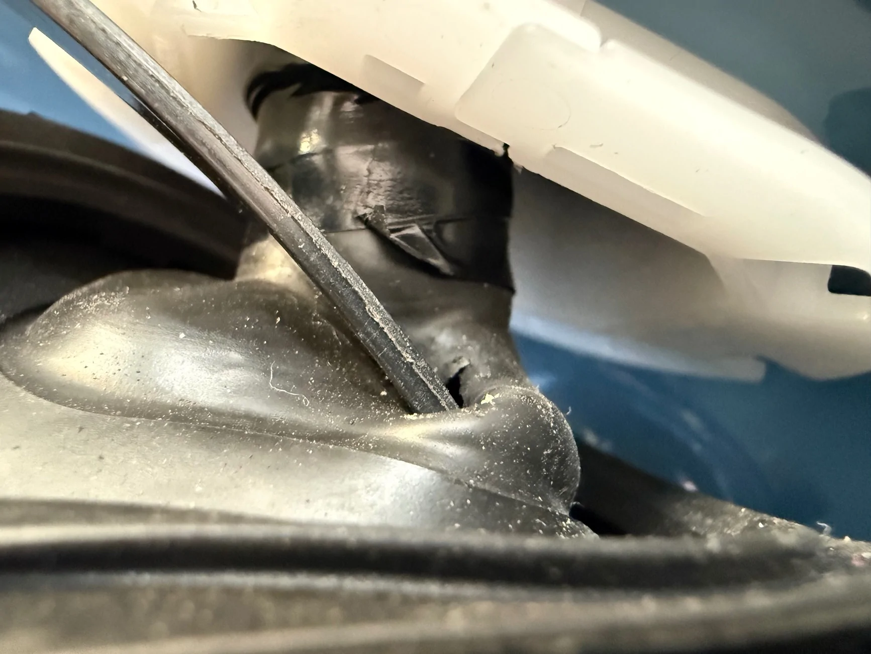

Not that location though. Because EVERY TIME after I wash my car and open the trunk gate, I can ALWAYS see pink soap suds accumulating over that location. I think the soap got pushed in by the high pressure gun during the rinsing process, cuz the soap dispensing method wasn't a jet of soap, it's from the foam brush.

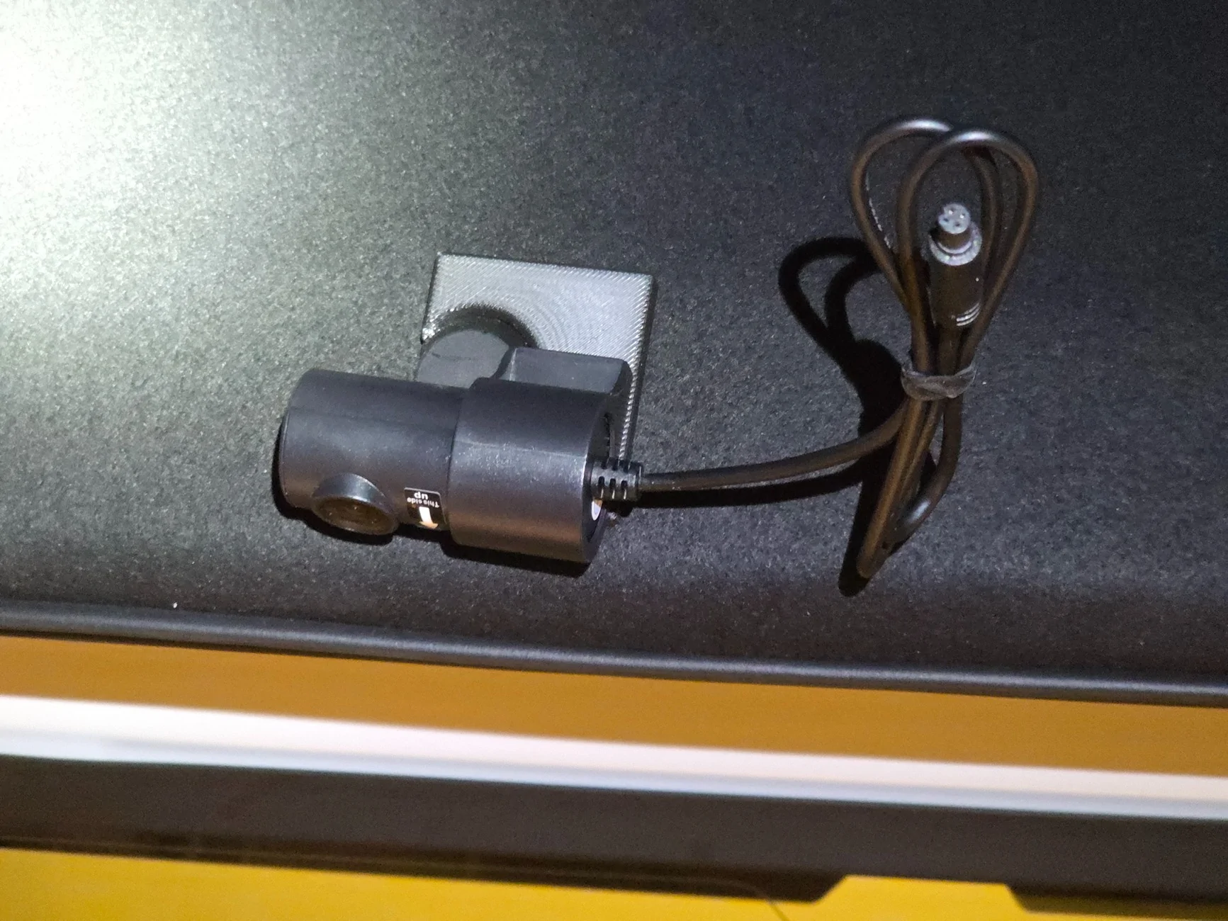

Mine is similarly mounted, same 3D-printed part, but I centered mine. No holes needed to be drilled and the way ours is mounted gives a better view IMO.
