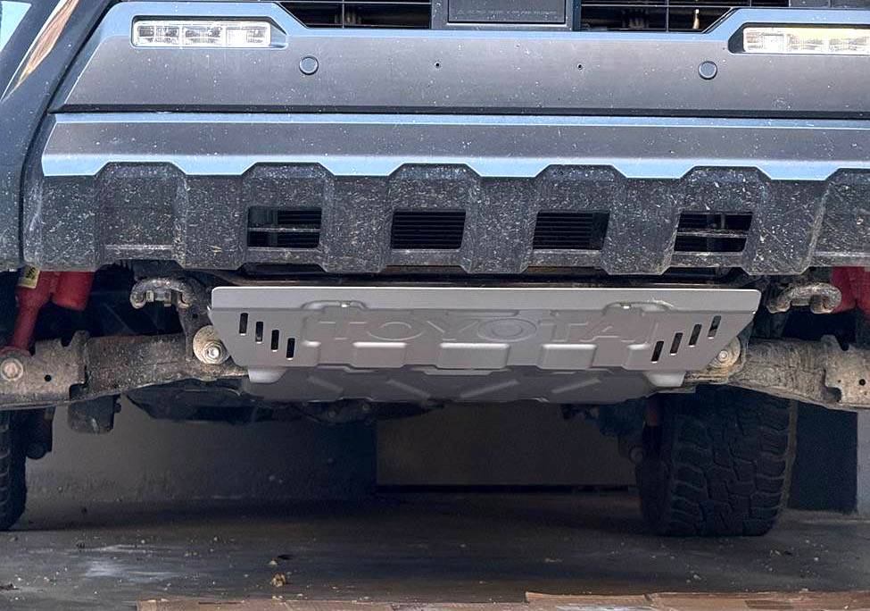

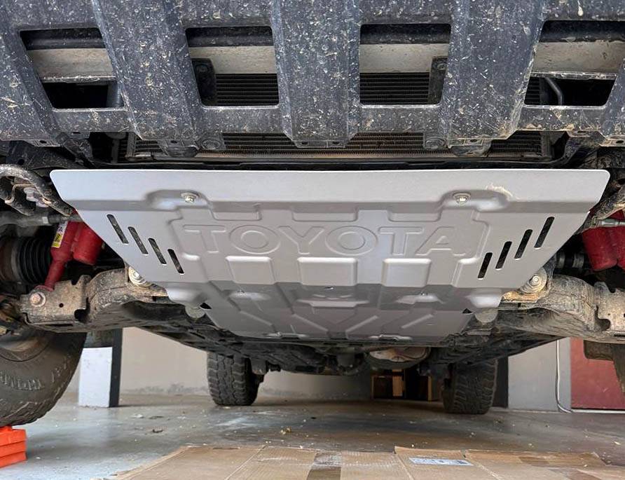

The Land Cruiser 250 front skid plate fits the Hybrid 2025 4Runner 6th gen. Here's photos installed on a Tacoma Off-Road, which has same skid plate fitment as the 4Runner.
It's identical to the Trailhunter skid plate, but it's stamped "Toyota" instead.
Part name: Toyota 2024 + Land Cruiser Front Skid Plate - Toyota (PT228-60242)
Part number: PT228-60242
2025 2026 4runner 6th gen Land Cruiser skid plate fits Hybrid 2025+ 4Runner 6th gen (installed on TRD Off-Road). Part number # inside Land Cruiser skid plate fits a 2025+ 4Runner 6th gen (installed on TRD Off-Road). Here's part
2025 2026 4runner 6th gen Land Cruiser skid plate fits Hybrid 2025+ 4Runner 6th gen (installed on TRD Off-Road). Part number # inside Land Cruiser skid plate fits a 2025+ 4Runner 6th gen (installed on TRD Off-Road) Here's part n

Yeah, NYTOP mentioned a while back that the LC250 shares skid plate compatibility with the 4Runner, but somehow not the Tacoma (slightly different placement of middle passenger side mounting hole). Interesting choices by Toyota.
Still trying to decide on skid plates - I like the coverage and look of the TH/LC plate but want some access holes

The Land Cruiser 250 front skid plate fits the 2025 4Runner 6th gen. Here's photos installed on a Tacoma Off-Road, which has same skid plate fitment as the 4Runner.
Land Cruiser skid plate fits a 2025+ 4Runner 6th gen (installed on TRD Off-Road). Here's part ...jpg's part ...jpg
Land Cruiser skid plate fits a 2025+ 4Runner 6th gen (installed on TRD Off-Road) Here's part n...jpg's part n...jpg
Awesome info!!!!!
FYI, this would only work on the Hybrid version of the 4Runner.
Damn, good tip. Is that because this skid plate extends all the way back to the hybrid specific trans crossmember?
