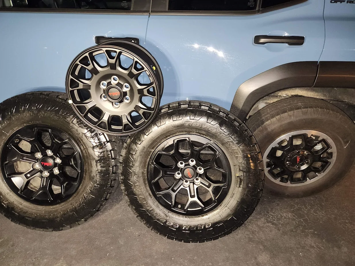

If you are going to stick with stock tire size (265/70R18) I think the PRO wheel (PT946-35240-2F) looks best and the extra offset (+20) adds just the right amount of poke (IMHO). However if you want to max out the tire size without rub you need to stick with close to stock offset (+55 on TRD OR wheels) which the TRD Flat Black option wheels (PTR56-35242-F1) provide (+45 offset). Here is a photo with all three wheels. I swapped the OEM 265/70 tires (Mich) to the TRD PRO wheels and moved the bigger tires to the TRD Flat black (which is without a tire in this photo) to get rid of rub with my big tires. (I gifted my son the OEM TRD OR wheels (and tires and spacers) for his 22 5G4R)

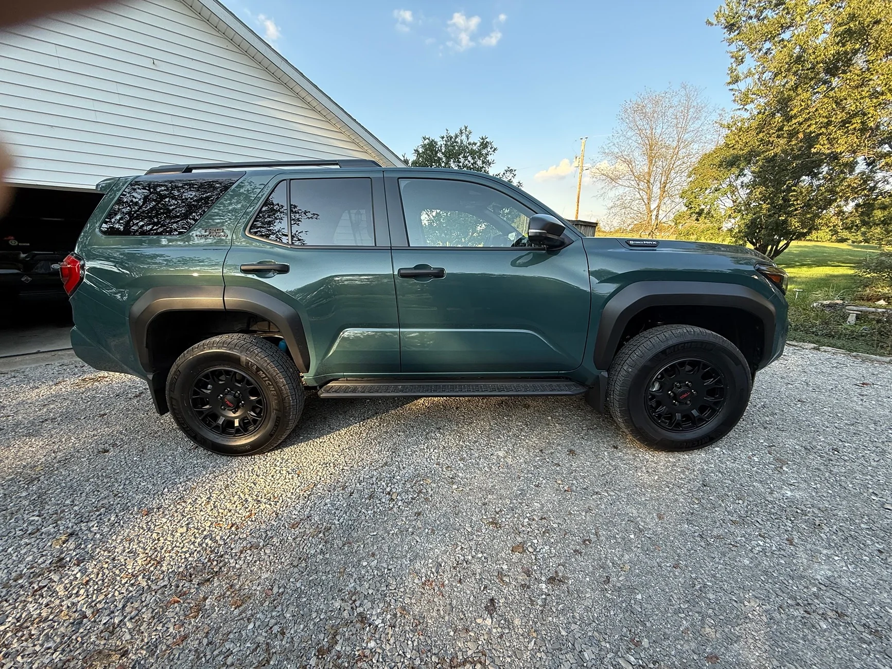

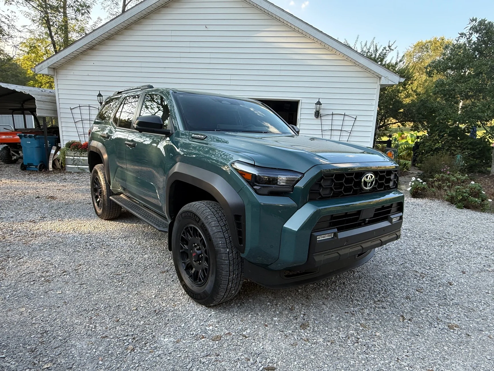

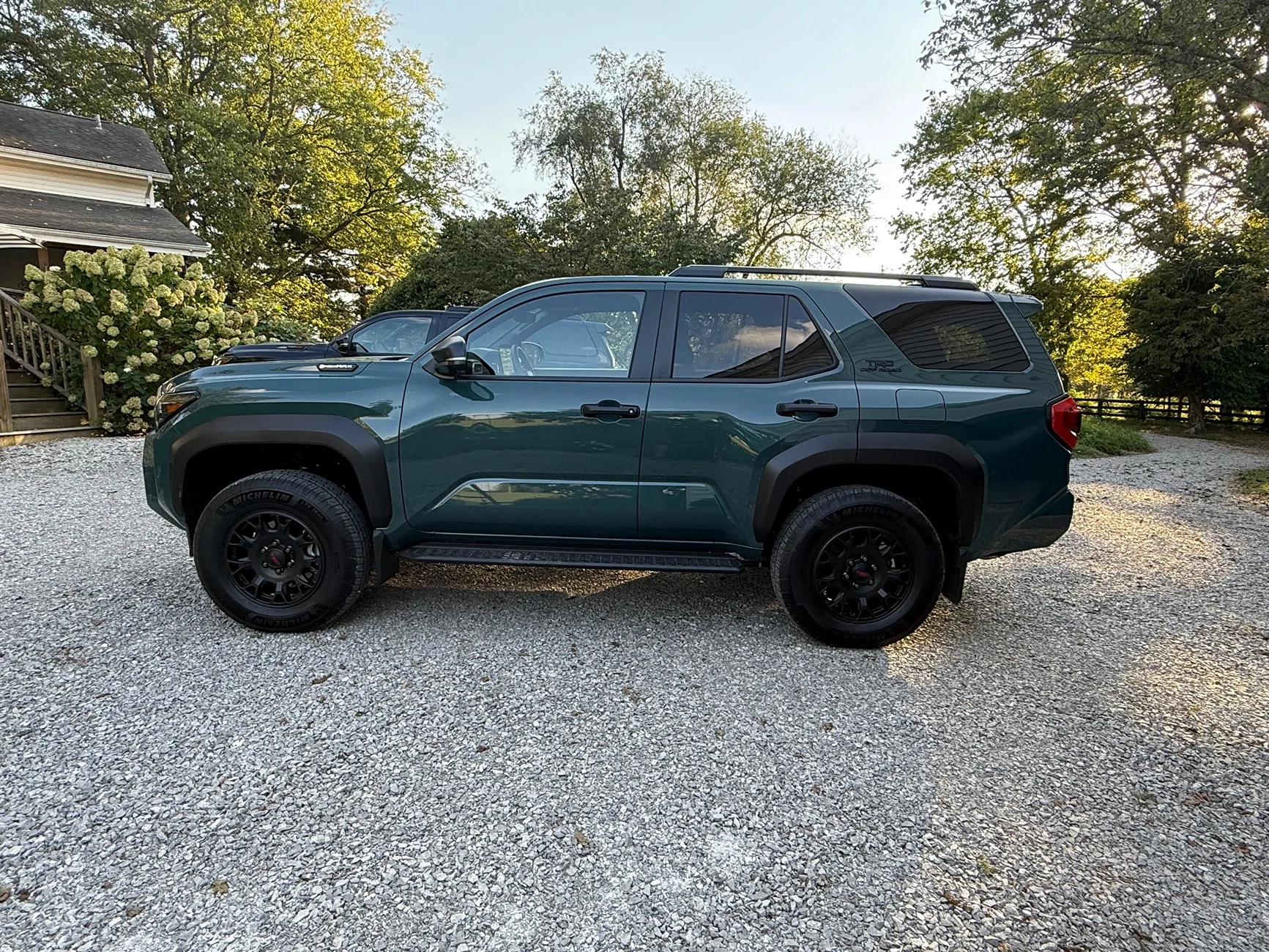

I replaced the OE wheels on Julie's ORP with the optional 18" TRD Option Wheel. Very happy with the choice. I reused the 265/65/18 Michelins. Last photo is the vehicle before the wheel swap and Westcott collar lift. Swapping the wheels seemed to change the color of the vehicle. $1325 for 5 from local Toyota Dealer
