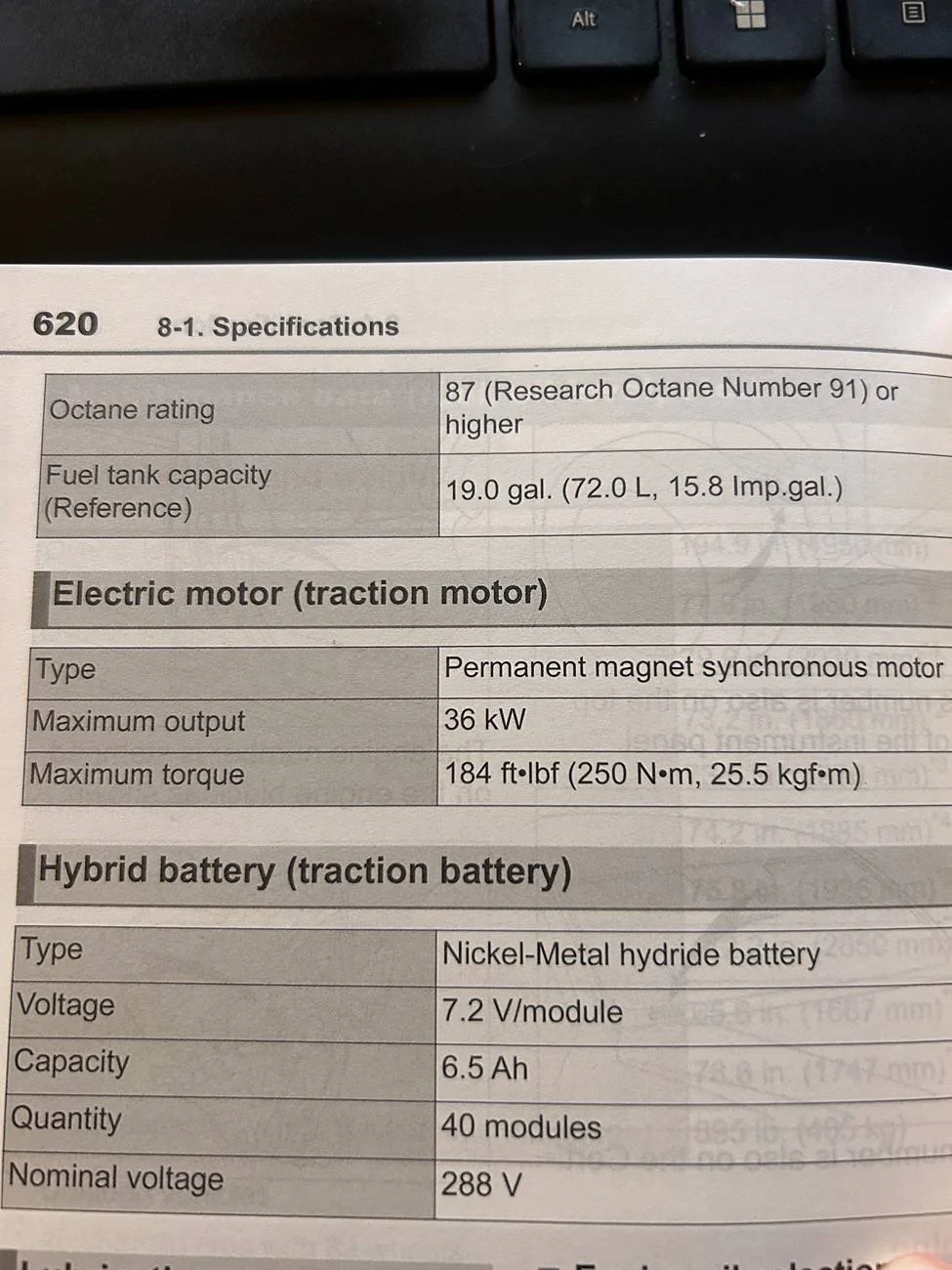

Maybe someone can explain to me what Octane goes into the IForce Max? The manual states 87 (research octane 91) or higher? So is it 87 or 91?

Hey Cory. Definitely a bit confusing! As for what I have been able to determine, it will take 87, but operates better on 91, with no ethanol. There are a few threads on here that talk about an additional 20+ horsepower and 20+ torque as well with the 91 or higher. That's all I got. Hopefully someone with a bit more knowledge will drop on in.

87 AKI
91 RON
AKI is the measurement used by the United States, which is an average of RON and MON.
RON is used in the rest of the world as the standard.
I’d use premium 91/93 AKI in the US personally, as the turbo can take advantage of it and it’s not much more $.

So just to reinforce, your owners manual is recommending 87 octane in the US since it's the AKI number shown on pumps.
Whether you might want to use higher octane is another discussion.
