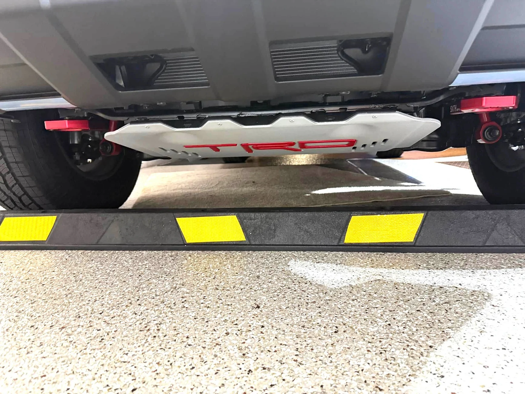

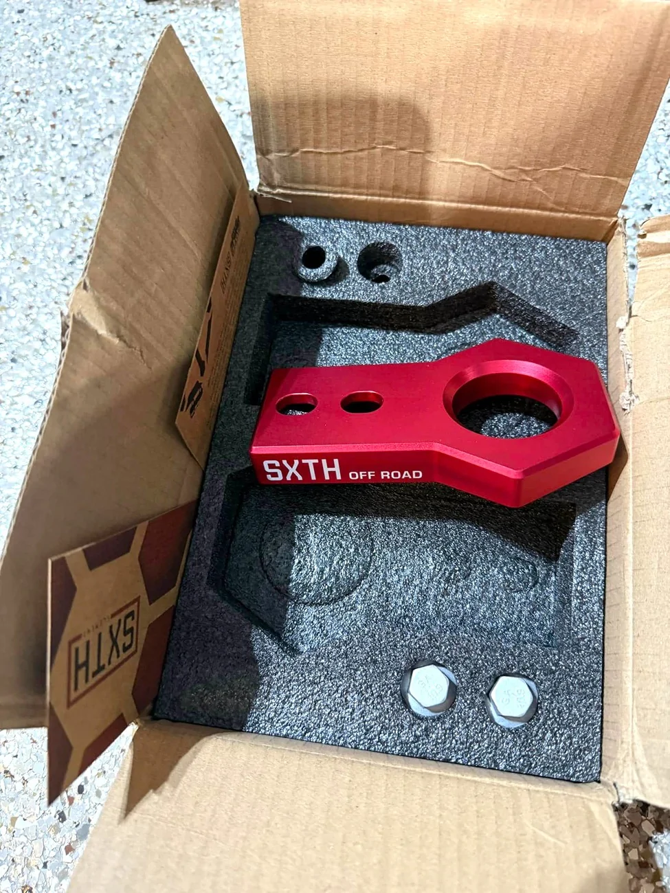

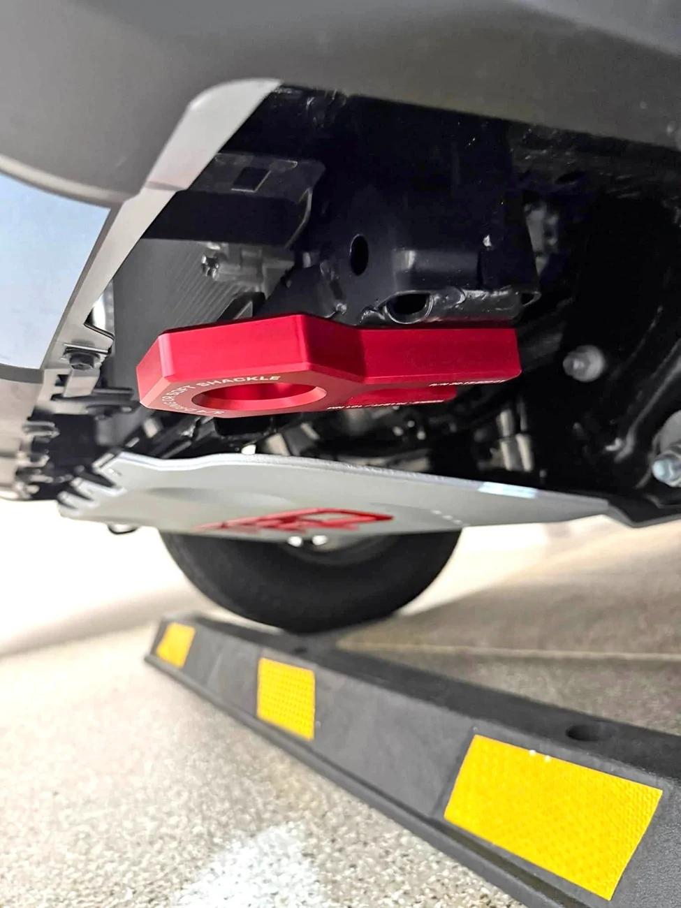

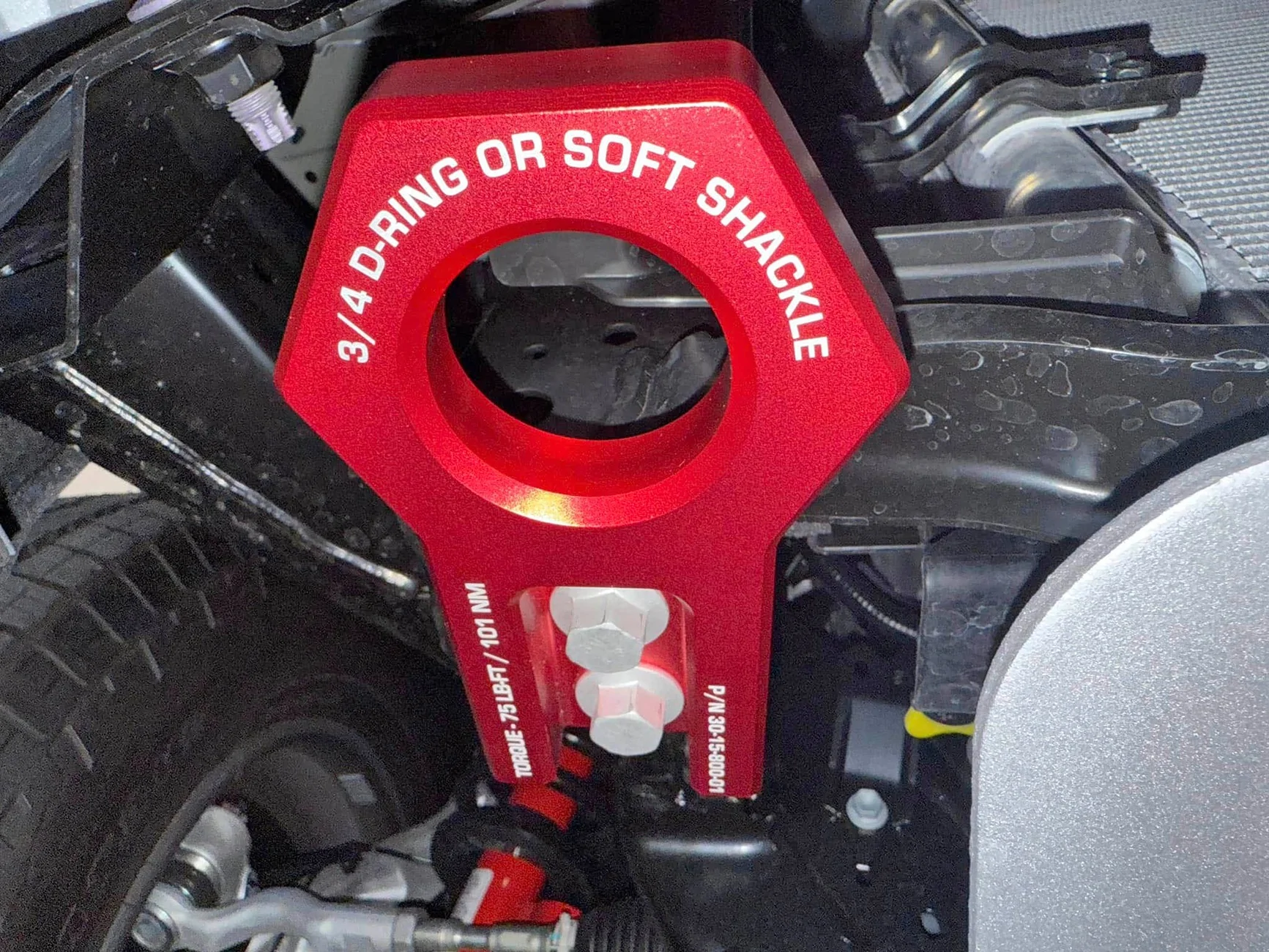

@SXTH Element recovery tow hooks / points installed look on 4runner 6th gen.
18mm torque wrench required. Torque to 75 lb ft for install.
Load capacity of 11,000 lbs in the direction of pull.
