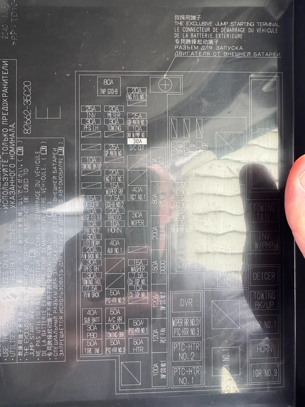

I don’t know if I can recommend the hardwire kit, as the other battery powered option mentioned above might be more convenient. If you chose this route I spent a lot of time checking fuses. The best options I found were:
RED (constant power) - HAZ (fuse for hazards)
YELLOW (ACC) - P/Outlet No. 1
Ground - Screw/Bolt
Unfortunately, the mini low profile fuses still protrude out too far so that you certainly won’t be able to put the fuse box panel back on, but you also won’t be able to completely snap the kick panel back in place. I can only snap 1/4 back on to hold it there. No issues with it falling off or anything yet but there’s going to be a little vibration under there.

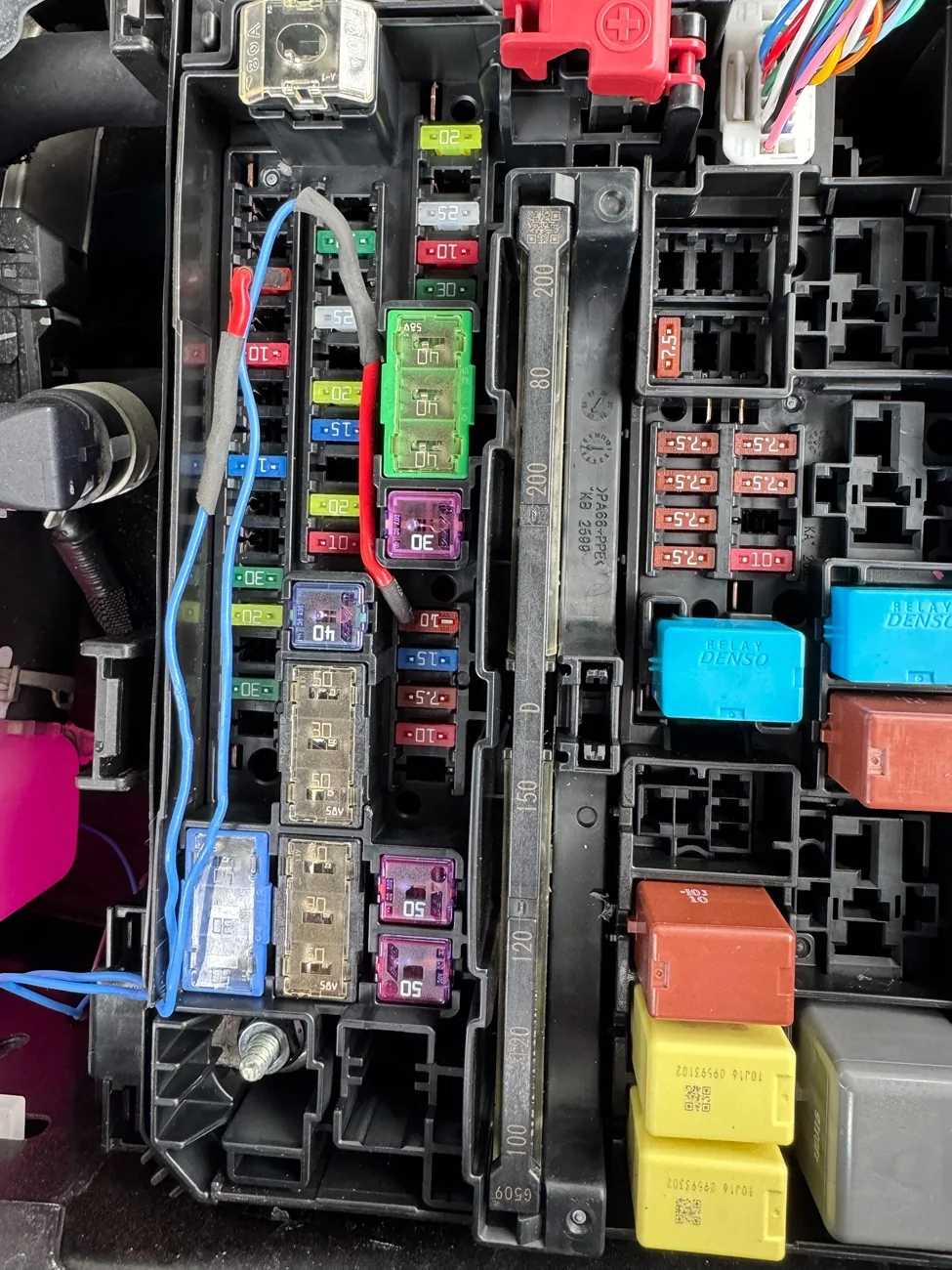

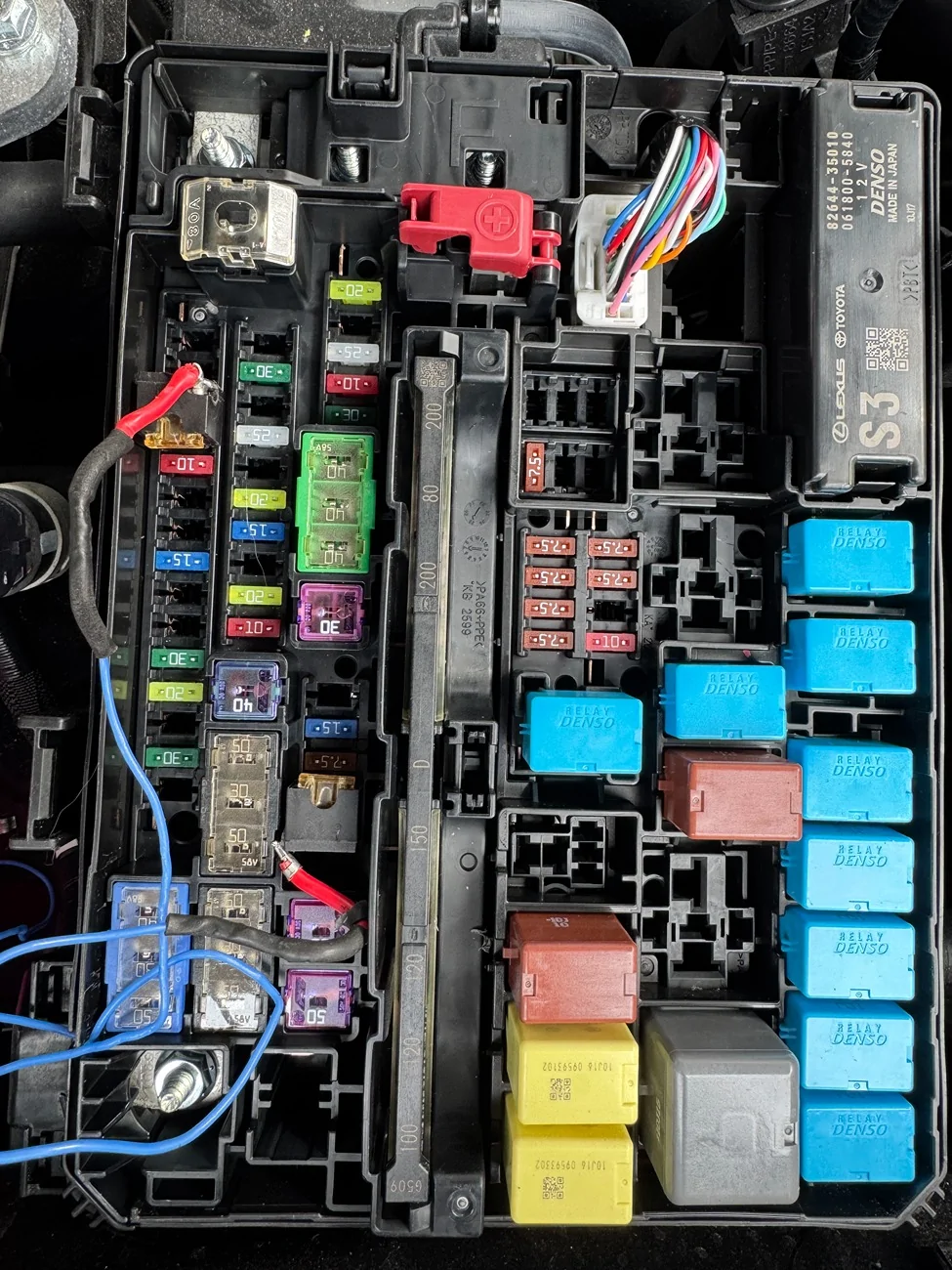

Hey guys- sorry for the delay. We literally just got it set up the right way this past weekend. I had it plugged in to the fuse box under the passenger side kick panel for the time being - waiting on warmer weather so we could get under the hood (since I am in NY and it's been very cold and the only person I know who gets this stuff is my step dad and there's no space to do it inside).

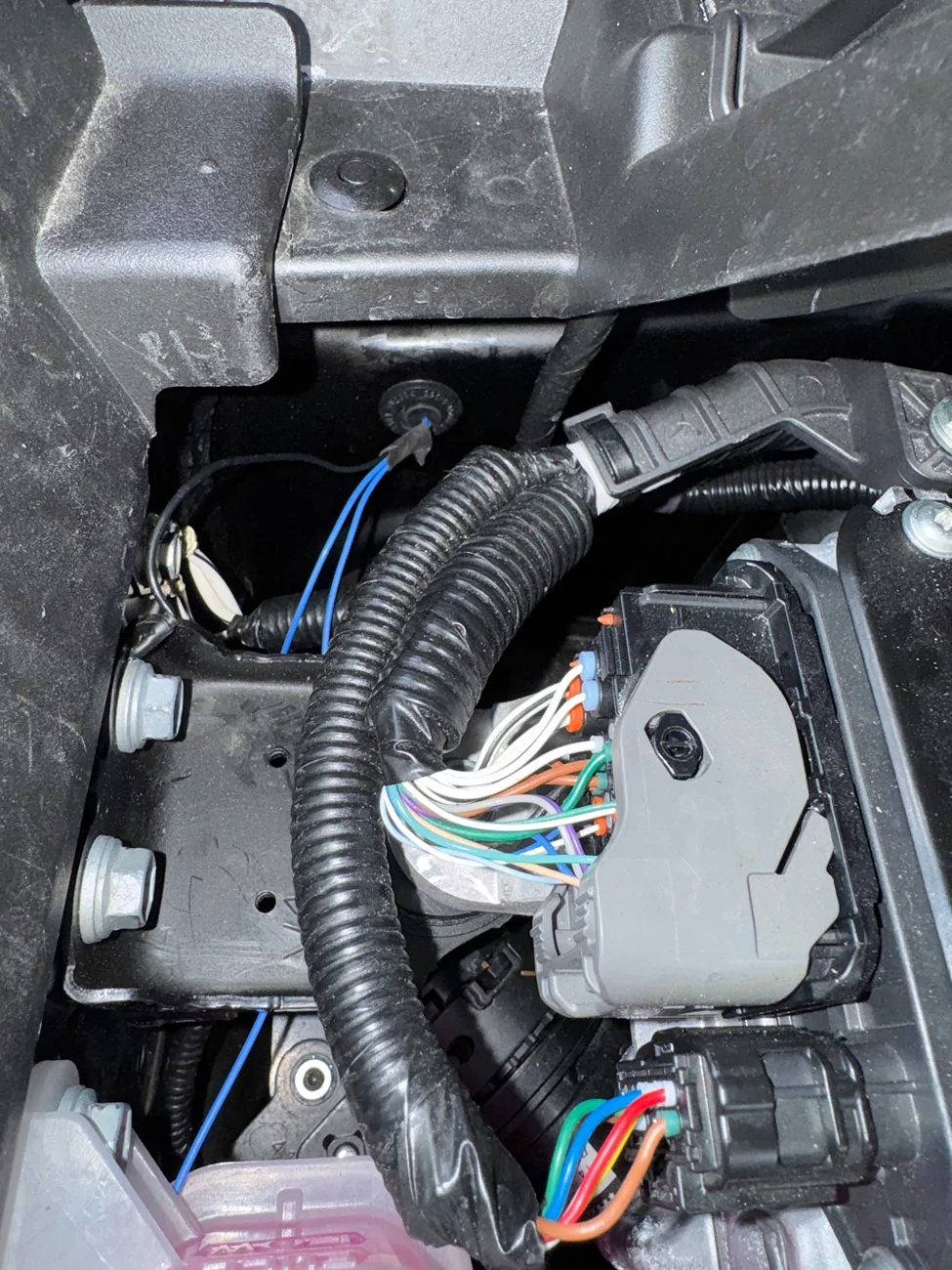

We managed to go through the firewall on the passenger side pretty easily, using the grommet in the top corner under the hood. Instead of using the wires provided, we tied in two smaller wires so we could keep the grommet in place (cutting a small slit to the center of the grommet) AND avoid cutting the fuse box cover. Theres a little notch they fit in nicely and (it's tight) but the cover clips in without cutting the wires.

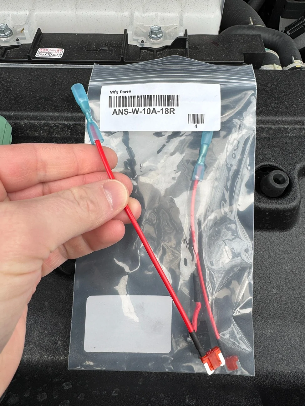

Then we went in to the fuse box on the passenger side (not drivers side). We found that the left bank of fuses is all constantly powered and theres another bank of fuses that we could use for ACC power. Frankly, there's a lot of ways to screw up some pretty critical systems in there so I would be very VERY careful. We chose two spots that were blank on the fuse panel cover AND we did not use the fuse tapes provided by VIOFO. Those fuse taps did not fit in to the ACC power bank. The ones we ordered came from a company called Optifuse. I am going to include some pictures.

P.S: Don't attach the ground to the bundle of ground wires that are already attached to a ground. Not sure but this may have caused an issue for us at one point. The picture attached shows where we put the ground.
P.P.S: I don't have a final picture of the set up. There's about 2 inches of snow on my car this morning but I'll snap another picture when I get a chance. I included a picture where we tried to use the fuse taps from VIOFO (which worked we just had to break a plastic piece to bend the wire and solder it back...yeah too much work)

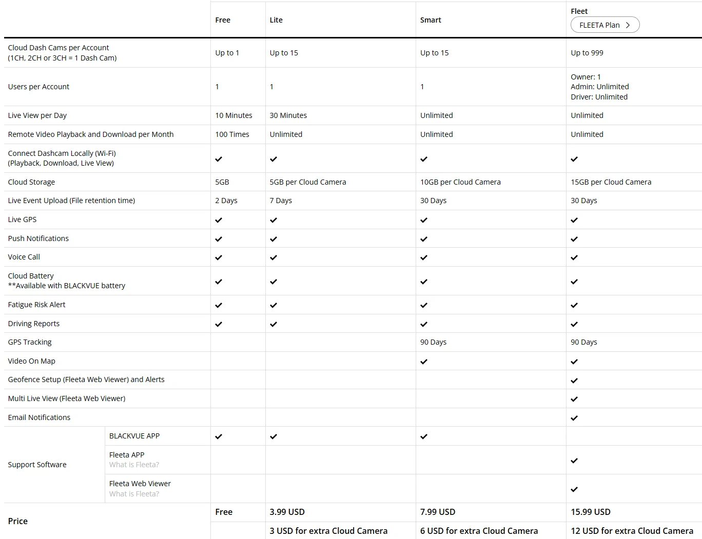

blackvue has cloud cams but they get spendy quick since you are roped into a propriety system. you have to pay for the LTE module and for the monthly sub (unless you go the free sub plan)
