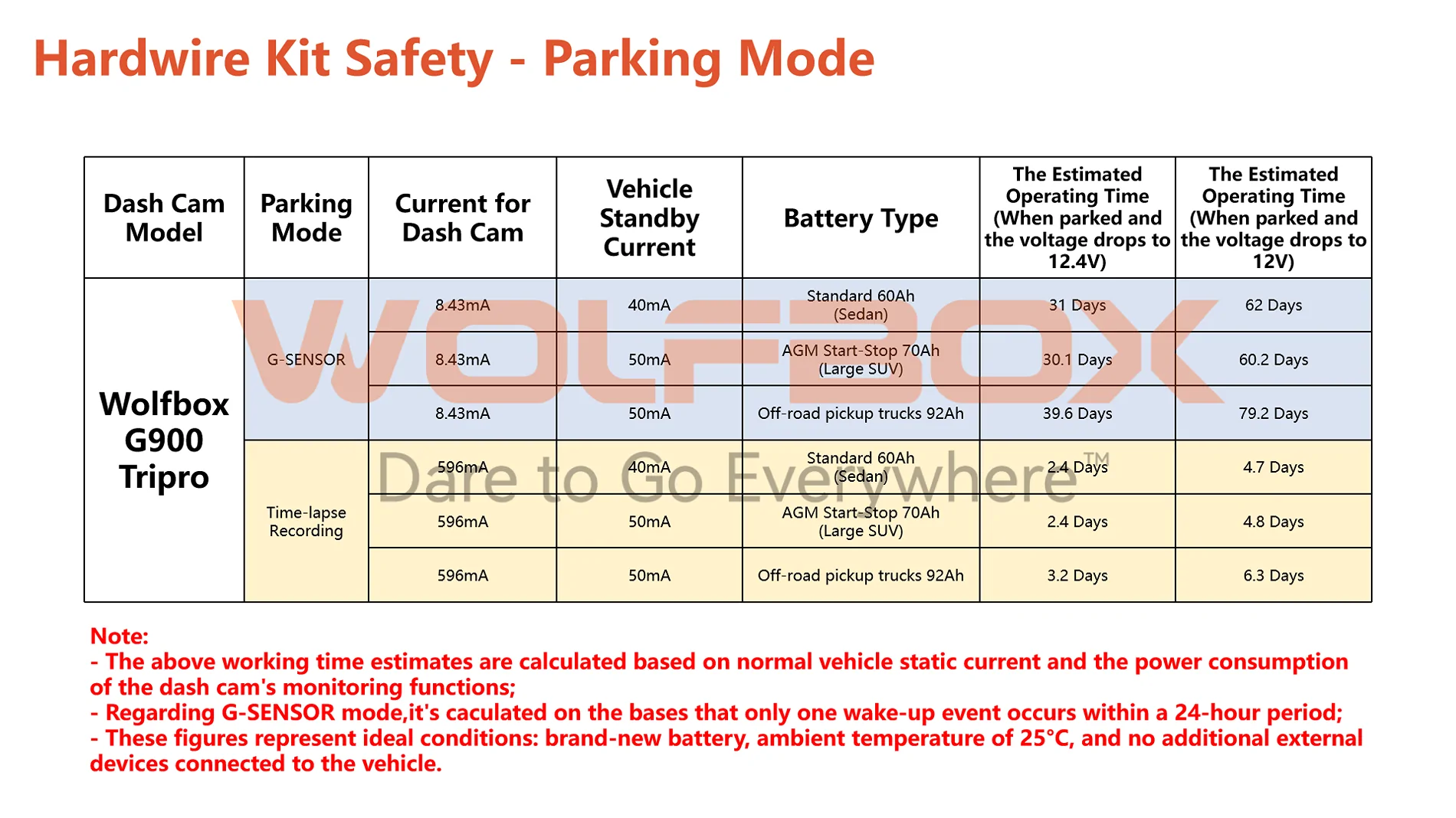

We’re back with Part 2 of our series on hardwire kit and installation! In this post, we’ll dive deeper into the topic. If you’ve already read Part 1, you’re well on your way to mastering the basics—now it’s time to build on that knowledge.
Make sure to read through this guide carefully, as it’s packed with valuable insights to help you achieve a smooth and safe installation.
2025 2026 4runner 6th gen Wolfbox: Knowledge on Hardwire Kit and Installation [Part 2] hardwire kit1

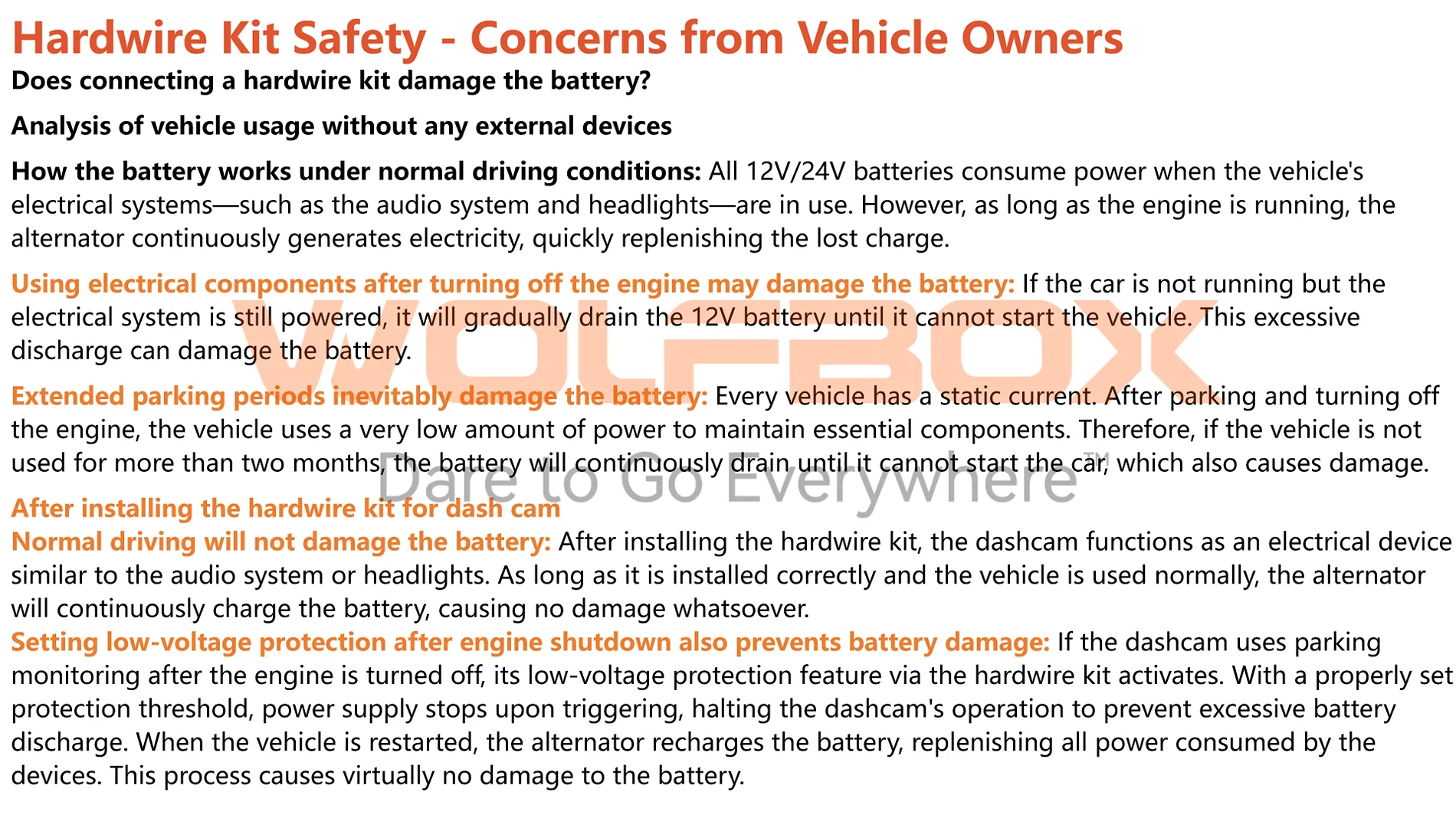

2025 2026 4runner 6th gen Wolfbox: Knowledge on Hardwire Kit and Installation [Part 2] hardwire kit3
2025 2026 4runner 6th gen Wolfbox: Knowledge on Hardwire Kit and Installation [Part 2] hardwire kit4
