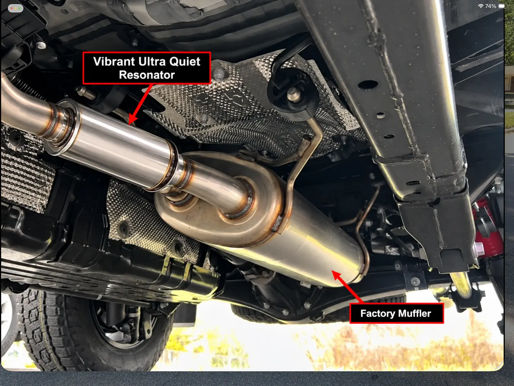

I've had that Experience with the TRD Exhaust on two older 4Runners with the 4.0 V6. What worked for me was to install a resonator in front of the TRD muffler. The Vibrant Ultra Quiet did the trick removing all drone and took the overall tone down a bit.

They come in several OD. I used the three-inch mounting in front of the muffler

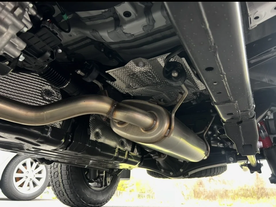

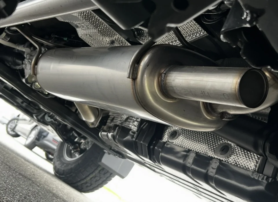

I have been reading about resonators, drone tubes and J-Pipes being fitted to your factory exhaust system to eliminate the drone sound. I am not looking to replace the factory exhaust with an aftermarket cat back system but rather lean towards modifying the current one.
I need to find a competent muffler shop that has experience with combating drone with precise calculations vs welding on a tube and hoping for the best. I am considering asking a shop to cut the factory short capped pipe at the rear of the muffler, add a 20“ to 30” stainless steele J pipe that turns and flows back towards the front of the vehicle and runs parallel to the muffler Inside of the frame rail. I would have them weld on the cap that was previously cut from the factory short pipe.
This could prove to be an economical modification that would keep the factory exhaust intact. Of course I would consult the installer for his expert opinion prior to any changes to be made.
I think I may pick up a 2” diameter flexible insulation tube from the hardware store so I can hold it up and bend it on the shape, direction and position I am thinking as a visual example.
Any thoughts about adding such a pipe and your thoughts about a better idea or spot to add a J pipe or drone tube? I am not sure adding a resonator will correct the drone? I know the other models have that muffler/ resonator at the rear past the rear axle. Is this Toyota‘s answer to eliminating drone from the exhaust?
Ultra Quiet Resonators - Vibrant Performance
Got this put on a few weeks and I am very happy with the results.
