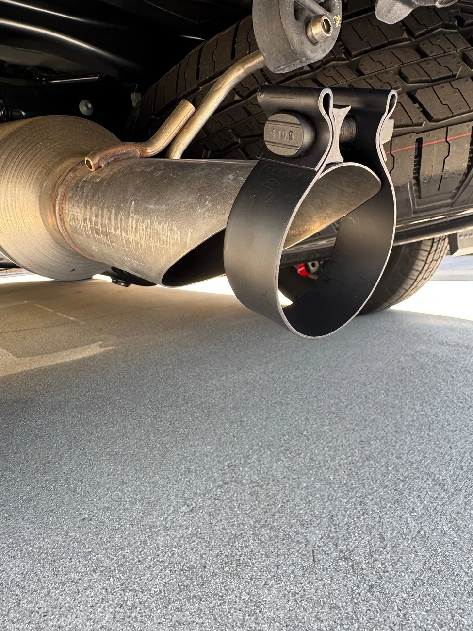

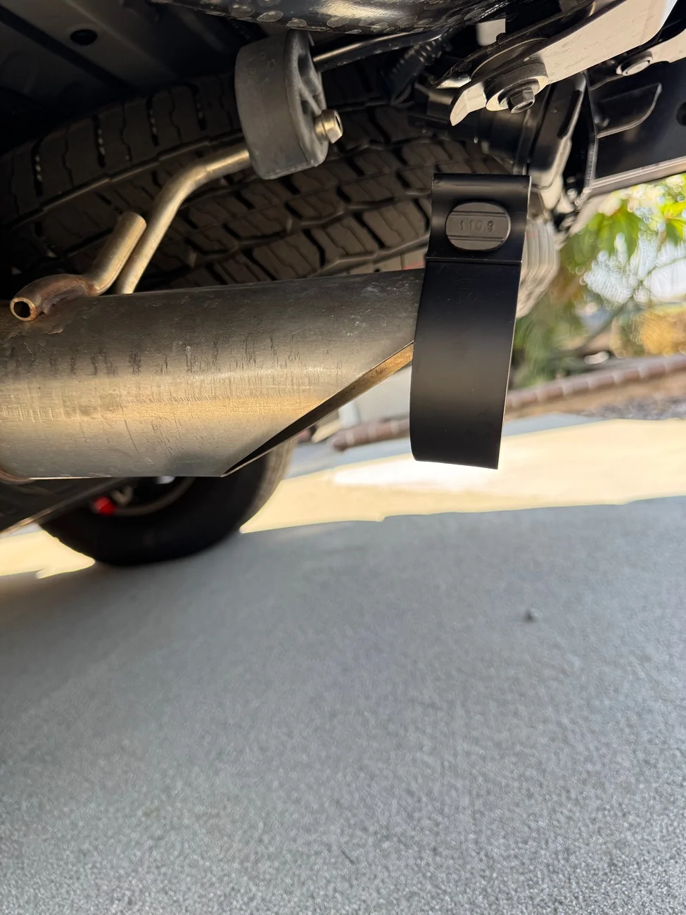

Does the black clamp fit over your pipe?
I have the Pro and I was able to make that fit. At first it seemed like it was way too small but the pipe being cut at an angle makes it seem like it is way bigger than it is. I simply spread the expansion notches just a little with a vise and it resulted in “what seemed like” huge gains. Then the tip slid right on the pipe and I clamped in place.
It did not 😕 not wide enough. Just the tip 🫢
2025 2026 4runner 6th gen Black Exhaust Tip Installed on TRD Pro (part number: PT932-89180-02) IMG_3002
2025 2026 4runner 6th gen Black Exhaust Tip Installed on TRD Pro (part number: PT932-89180-02) IMG_3001
