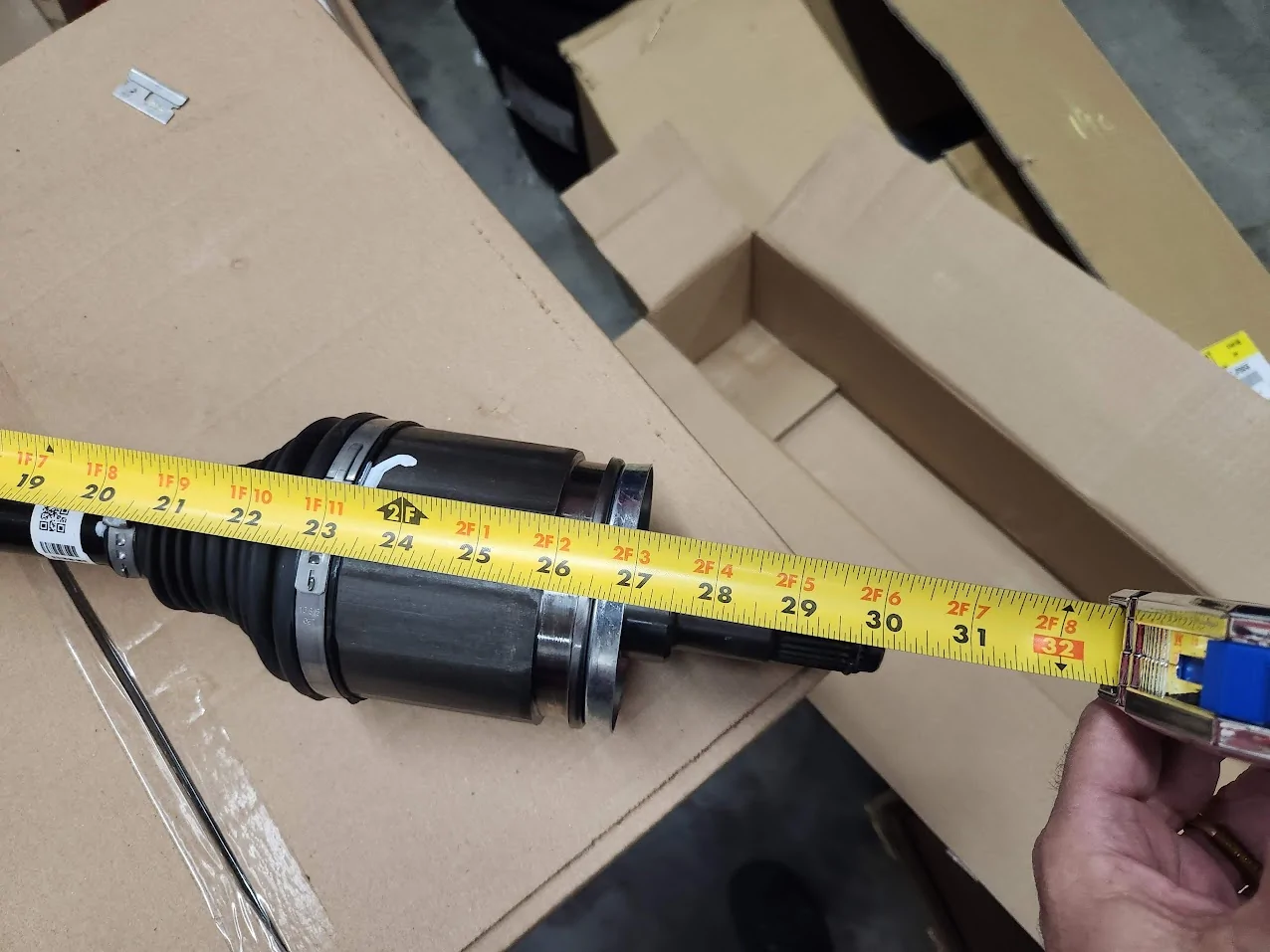

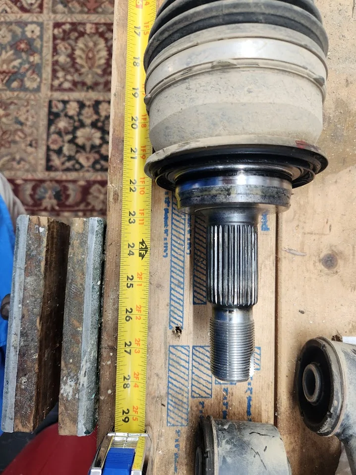

The TRD Lift Kit ( Part Number: PTCCY-89310/89320) does come with axels that are longer than those that came off my TRD ORP.
I do not know whether the THunter/Pro come with the longer axel or not but here is the part number for the axels from the TRD Lift Kit installation guide - you might find the stock THunter part number by searching Toyota parts site to see if its the same.
SHAFT ASSY, FR DRIVE, RH 43410-AK020
SHAFT ASSY, FR DRIVE, LH 43420-AK020
Axel length difference: about 2 inches (30" - 28")
Stock TRD ORP Axel:

TRD Lift Kit Axel:

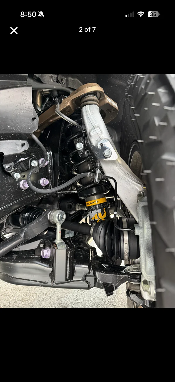

Havent got around to installing. From what I can tell based on pics, the TH and ORP axles are the same
