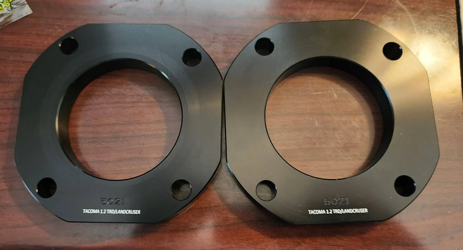

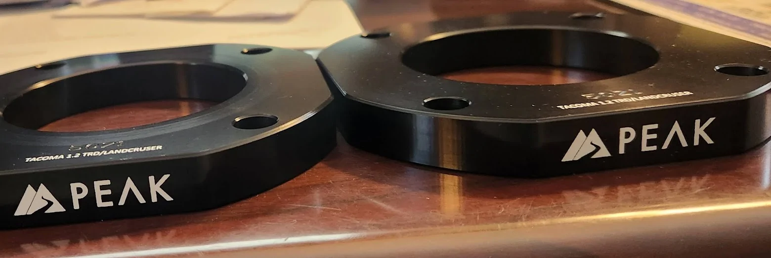

I installed these: Peak 1.25" leveling kit (5/8" spacers - which I measured)
Worked great. Seemed fairly level to me and NO issues with any of the TSS features or cameras angles that Toyota tells you to worry about with lifts. And this is with 285/75R18 (34.8") tires. I think the spacers might have helped a bit on rubbing.
And I'm giving you these details and pics below in case you might want to buy them from me used ($50?) since they will be coming off next week as I'm having the TRD Lift Kit installed. If interested, DM me. There is nothing to wear so I don't think miles create any degradation.

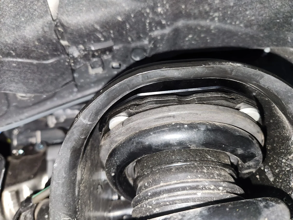

Installed on 20Sep25 (about 11.5K miles ago). You can see it hiding up there at the top of the strut assembly.

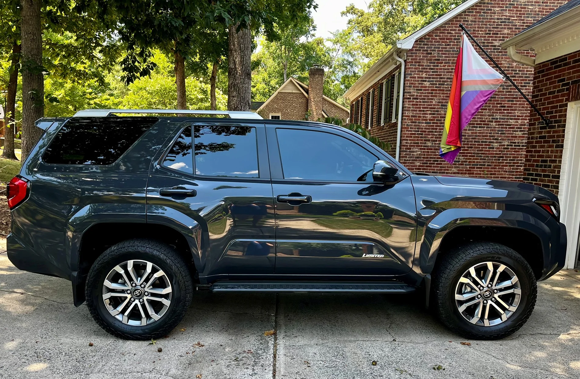

Limited Hybrid with Westcott 2.5"/0.75" level on 33" tires. Wheel wells both now sit at 38". You definitely notice when you get in. Only had it leveled for a day now so can't comment on ride/MPG hit. I lost about 1.5MPG with the bigger tires (Cooper Road+Trail 275/60/20).
