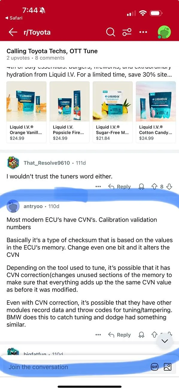

That is the same thing they said about the Audi, VW and BMW tunes until the manufacturers caught on and they began scanning for ecu flash count and things like boost requested and boost applied. They also said you could flash back to stock and be undetectable but it didn’t pan out when people started having issues and requested warranty work after ECU tune flashes.
I hope that the OTT guy proves me wrong - maybe Toyota is more flash friendly?
you are correct, still have the audi, and tuned vag’s in the past. Recall seeing a post of OTT #s posted by there people, as well arguing the theory of it being undetectable. Probably on the Taco forum, i’ll link it here if i find it.

It is undetectable until they detect it. Flashes are discoverable, no way around it.
If you blow a turbo or piston or break a piston rod and you are delivering more boost than the factory ECU tune calls for, do you think that the Toyota warranty will cover it??
