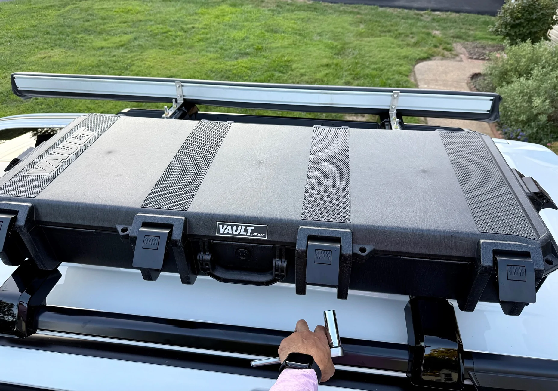

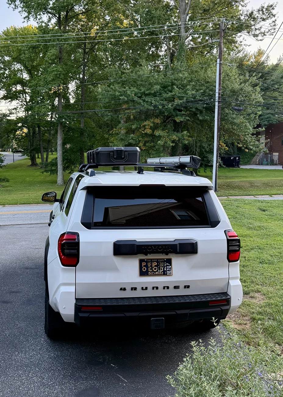

I ordered some t-nuts from a Yakima roof rack kit from etrailer since I couldn’t find any hardware for the oem rack.
https://www.etrailer.com/Accessorie...UIcTB5n0wmIs7oyQwblh0_BoIq6xgtghoCj_IQAvD_BwE
They worked out nicely with the 90 degree mounting brackets that came with the Roam awning.
Had to add two more nuts to get the brackets high enough to clear the plastic end caps.
I wish I had better pics but these were from a few months ago.

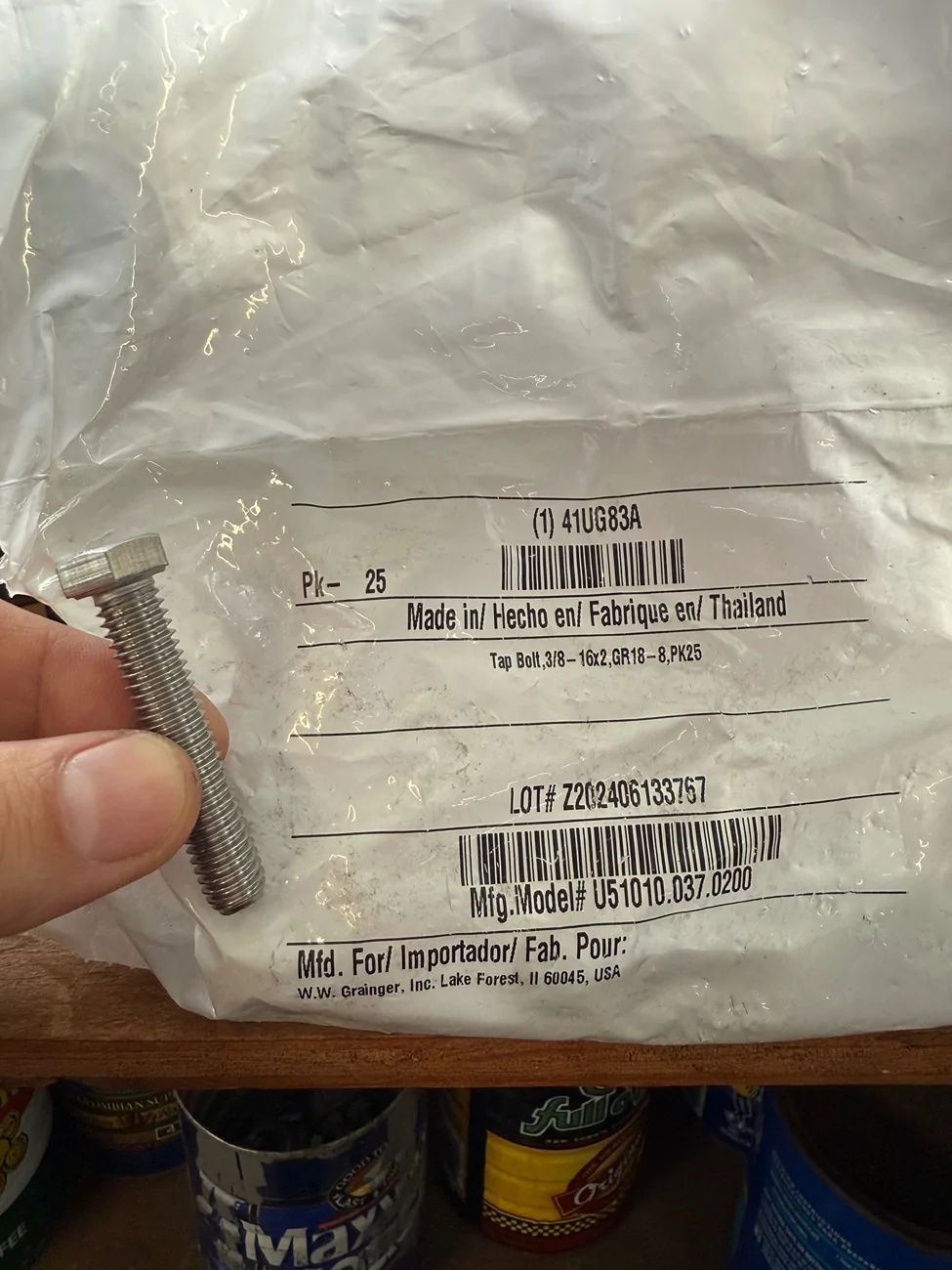

I need to correct my op. Now that I remember correctly, The Yakima t-bolts were what I used to mount the Pelican Vault Box not the awning. Awning hardware was a little more difficult. I bought 3/8-16x2 bolts, angle ground off half the head height, added a washer that also needed to be trimmed to fit into the oem roof rack channel. That is where I added extra nuts to allow for the plastic end caps.

No drilling through the crossbars. The hex head bolt along with a washer (I had to trim the washers to fit - making them more oval shaped) fit into the t-channel. I kept the rubber gasket in place. It’s a tight fit, but it works. Bolt length will be subjective to your application but 2” long works for my awning brackets.
