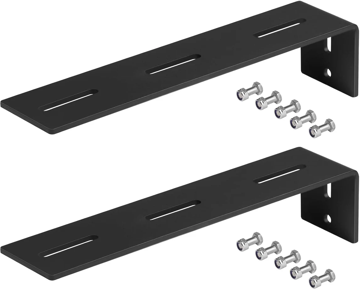

  1. Remove plastic covers from rails. The purpose is to allow me to have a flat surface going into the t-slots. I don't think these serve any purpose other than looks.
  2. Add 2 x awning bracket that is 13 1/4" long. 7" will remain on t-slot, and the other 6 inches will sit past the rails so they are free and clear from obstruction. 4 t-bolts per first 7" of the bracket. Face the 90 degree angle downward.

Awning bracket:

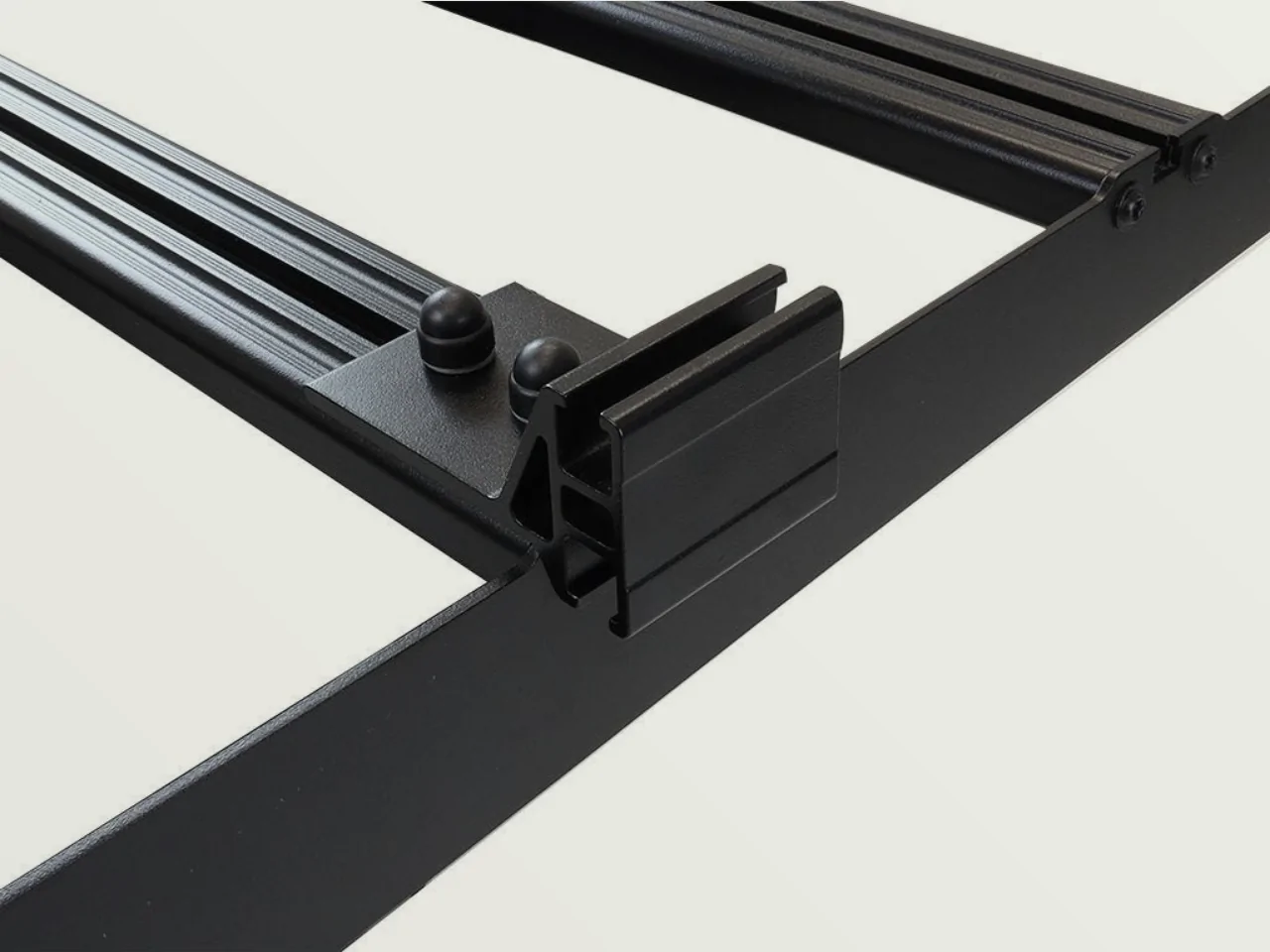

Slimsport attaches to the last slot before the bend in the awning bracket above:
2025 2026 4runner 6th gen DIY Awning setup for 2026 OEM Rails and Crossbars - Critique my design before I buy! 1787026645901-4k

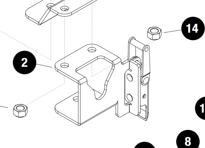

Quick Release drawings. Item 2 is what I connect to the Slimsport:
2025 2026 4runner 6th gen DIY Awning setup for 2026 OEM Rails and Crossbars - Critique my design before I buy! 1787026768114-o9

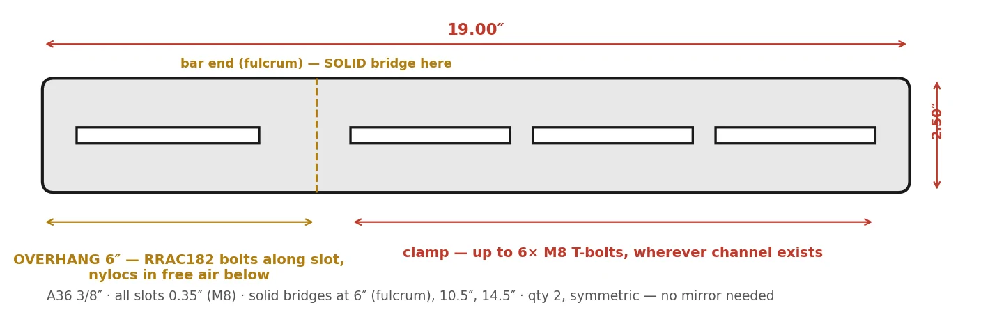

2025 2026 4runner 6th gen DIY Awning setup for 2026 OEM Rails and Crossbars - Critique my design before I buy! 19-inch-flat-awning-bracket
Or I could make my own bracket? Like this, all flat, but 6 t-bolts instead of 4???
