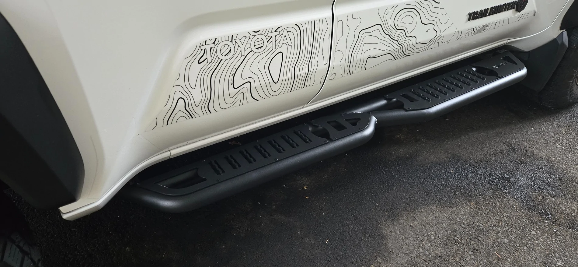

I removed my stock Rock Sliders on my '25 Trailhunter and installed the DV8 Off Road side steps and I couldn't be happier!!! Sturdy, bigger step surface and more affordable !! Super simple install too. Well worth the purchase!
2025 2026 4runner 6th gen Running Boards / Rock Sliders recommendations for TRD Pro 20260103_131001
2025 2026 4runner 6th gen Running Boards / Rock Sliders recommendations for TRD Pro 20260103_131036

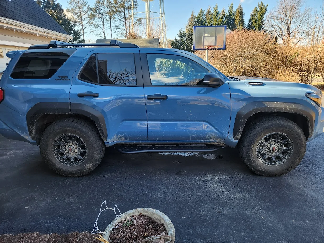

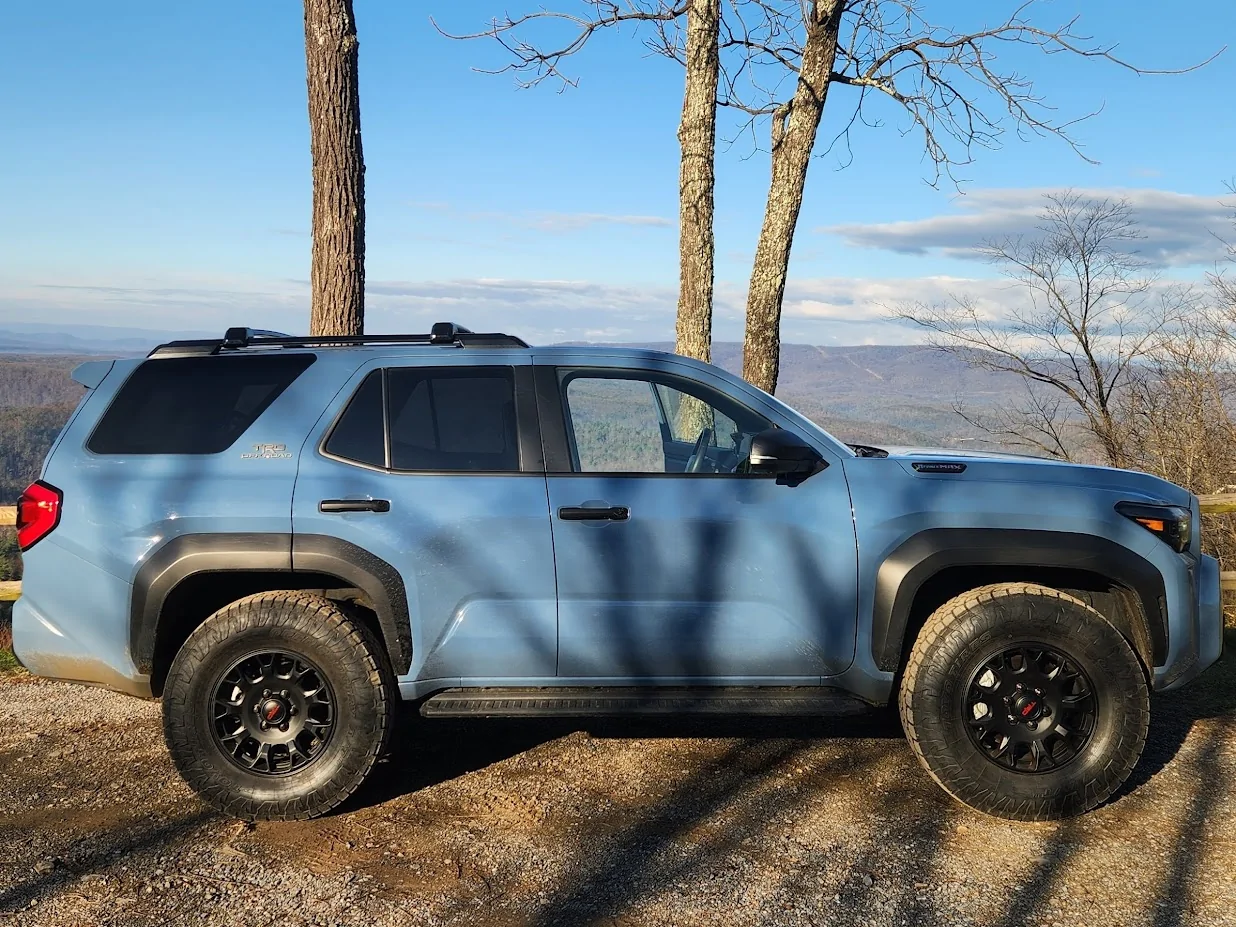

I had the stock running boards on my TRD ORP and really liked them. Mine will be for sale as soon as I clean them off and get them posted - so if you are not planning to rock crawl and need the extra protection of rock rails I'd recommend finding a set of takeoff running boards (lots get posted here but location matters since shipping can be prohibitively expensive - but I'd be willing to send you mine for ... $125 + shipping?) If you do want rock sliders there are a number of choices. I went with Cali Raised because they ship free and that made a huge difference (>$400) in total cost vs. other similar choices I was looking at. And since you have a Pro that should have the threaded holes in the frame installation should be a breeze. Here are photos of my TRD ORP with Cali Raised Step Edition sliders with step platform and same vehicle with the OEM running boards. I like them both.
Cali Raised sliders:
2025 2026 4runner 6th gen Running Boards / Rock Sliders recommendations for TRD Pro 20260119_115932
OEM Running boards:
2025 2026 4runner 6th gen Running Boards / Rock Sliders recommendations for TRD Pro 20251123_084542-EDIT

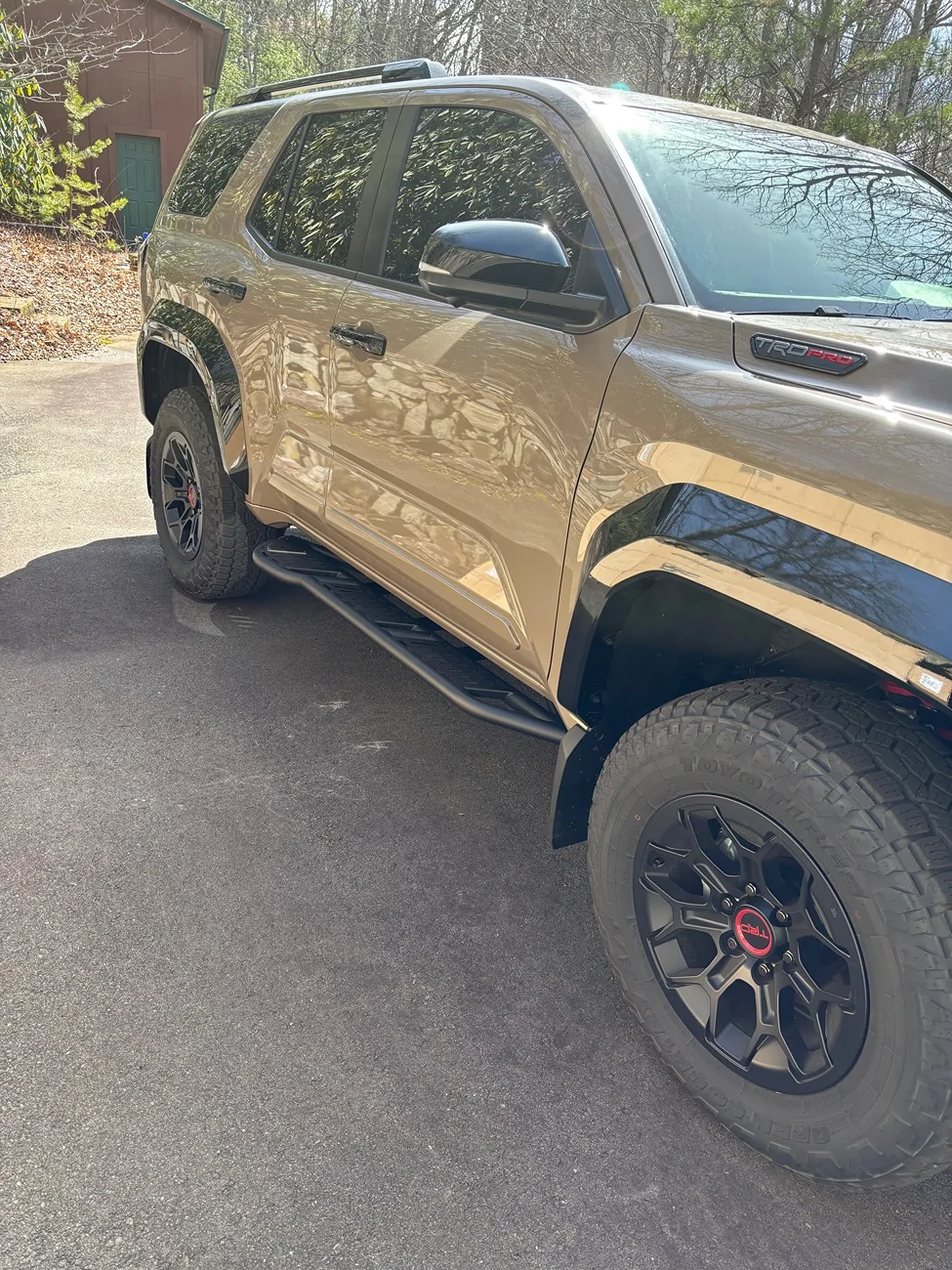

Funny, I just finished installing my Westcott Designs sliders an hour ago!
I went with Westcott because their build quality is top notch and I liked their design. Expensive, yes. But so was the truck.
If you have no intention ever of heading off road I would say a slider set is not for you. Go with running boards.
If you MIGHT use it for some offroading and you want a platform to step on for entry into the Pro, then consider what I installed:
DOM steel. TIG welded. With kick out. Zero degrees. With top plates. Black powder coat.
A zero degree slider with top plates is fine for use as a step.

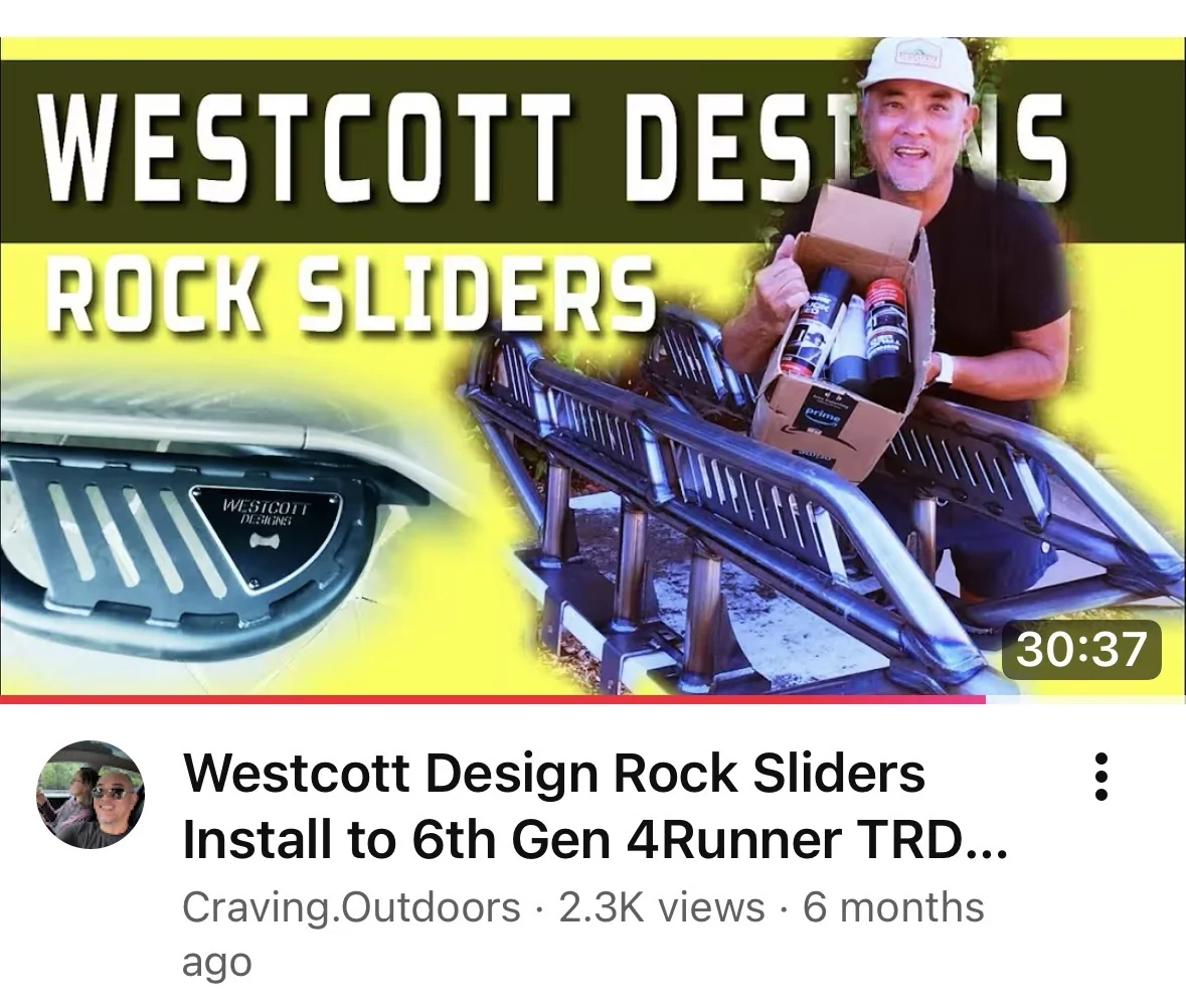

If you do decide to go with Westcott and plan to install them yourself, beware: they did not include any printed instructions and the Westcott website has no video for a 2025 4Runner install. But there is a YouTube video created by fellow forum member Joe (“Craving Outdoors” is the channel) and that video helped me immensely!
Plus you will need to install 4 RivNuts (2 on each side) so you’ll need an installation tool for that ($50-$70 Amazon). And you will need to jack up the side of the truck as you install those to give you clearance to use that tool.
Good luck and enjoy that Pro!!

what makes them "raised" sliders? Do they sit higher than typical running boards but can be used as sliders?
MikeD
Jun 4, 2025
374
263
Cali Raised is the name of the company. They have "step edition", and (I think) "trail edition "

Assuming the person next to you does not have a door that starts above the slider, seems like those would also offer some door ding protection over the factory sliders on my TH.
