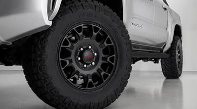

The ORP wheels come with +55 offset, while the TRD pro has +20 off set. Will replacing the wheels of an ORP with the full black wheels of TRD pro change the offset?
I would like to keep the +55 offset but would want full black wheels similar to the ones in TRD Pro. Please advise.
Yes

You will want the 18" TRD wheels, not the pro. The pro wheels will give the truck a much wider stance.
Part No: PTR56-35242-F1
