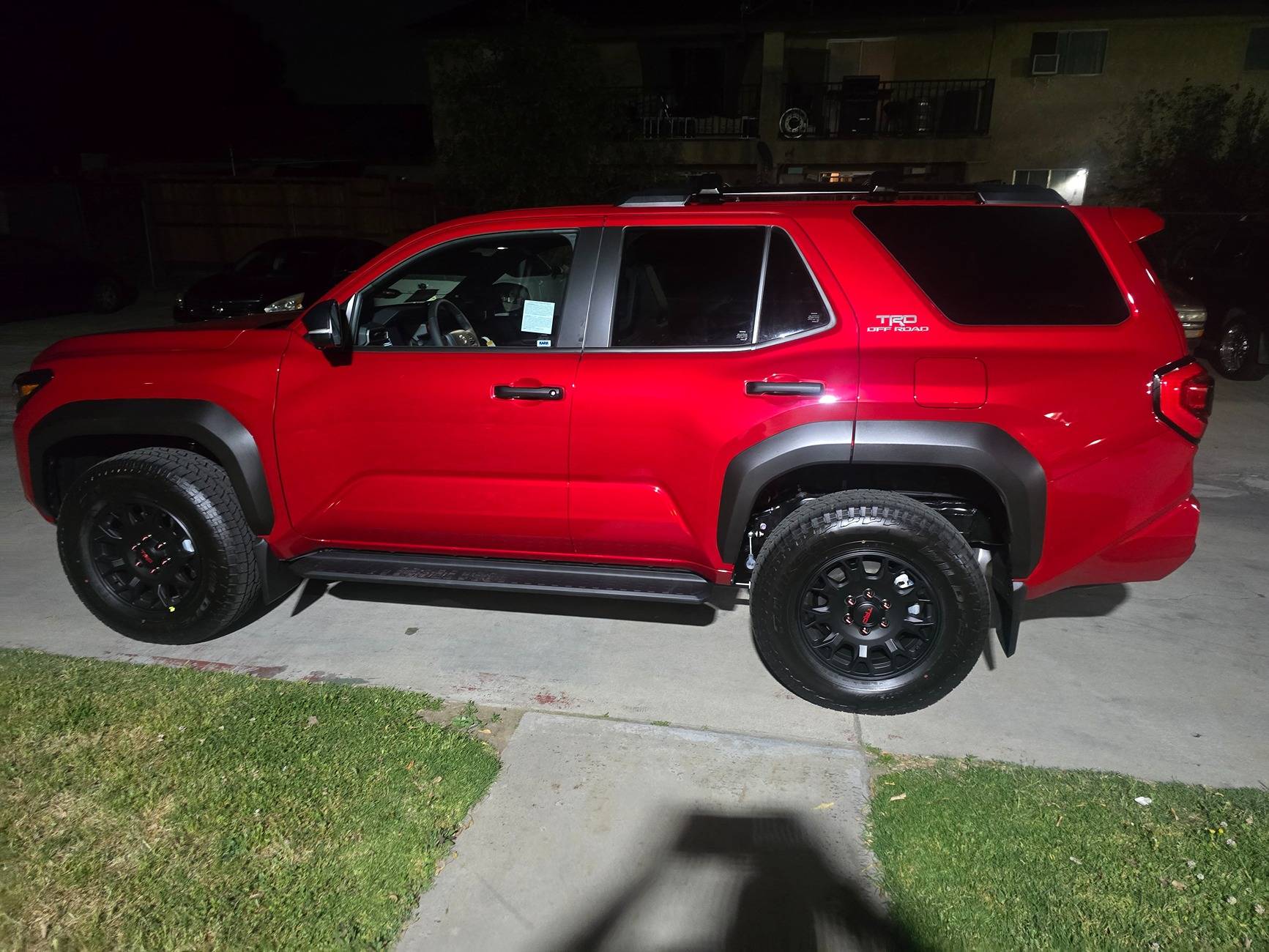

Hello All,
I got a new TRD ORP and was wondering if anyone knew what the performance was on the 18" rims. They came with the 4runner. I want to do some easy to moderate off roading in the future and I was wondering if i should keep these or get some methods 703's with 33" inch tires. Any thought will help me out. Thanks in advance.

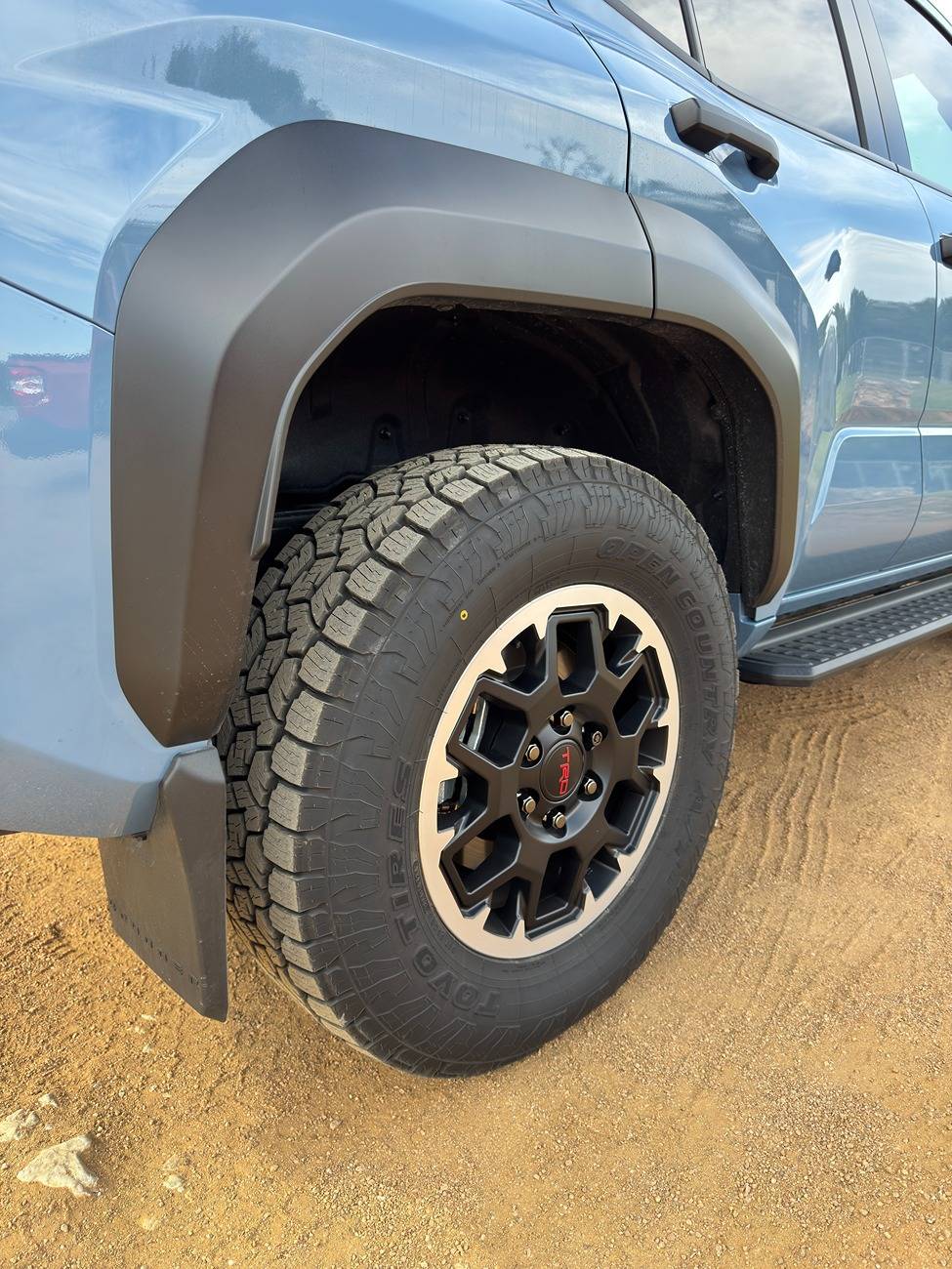

Hello All,
I am on the way to get an ORP. Did you get a full black wheel as in this picture? I was told o will get one that is black and some bright metallic finish.
The wheels came with the 4runner. They are the 18 inch TRD black matte wheels.
