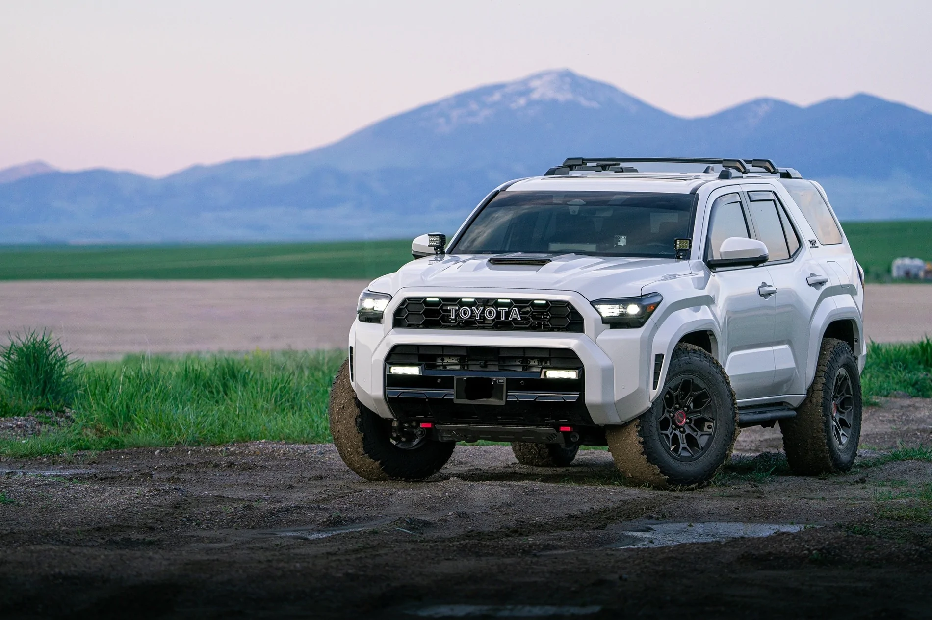

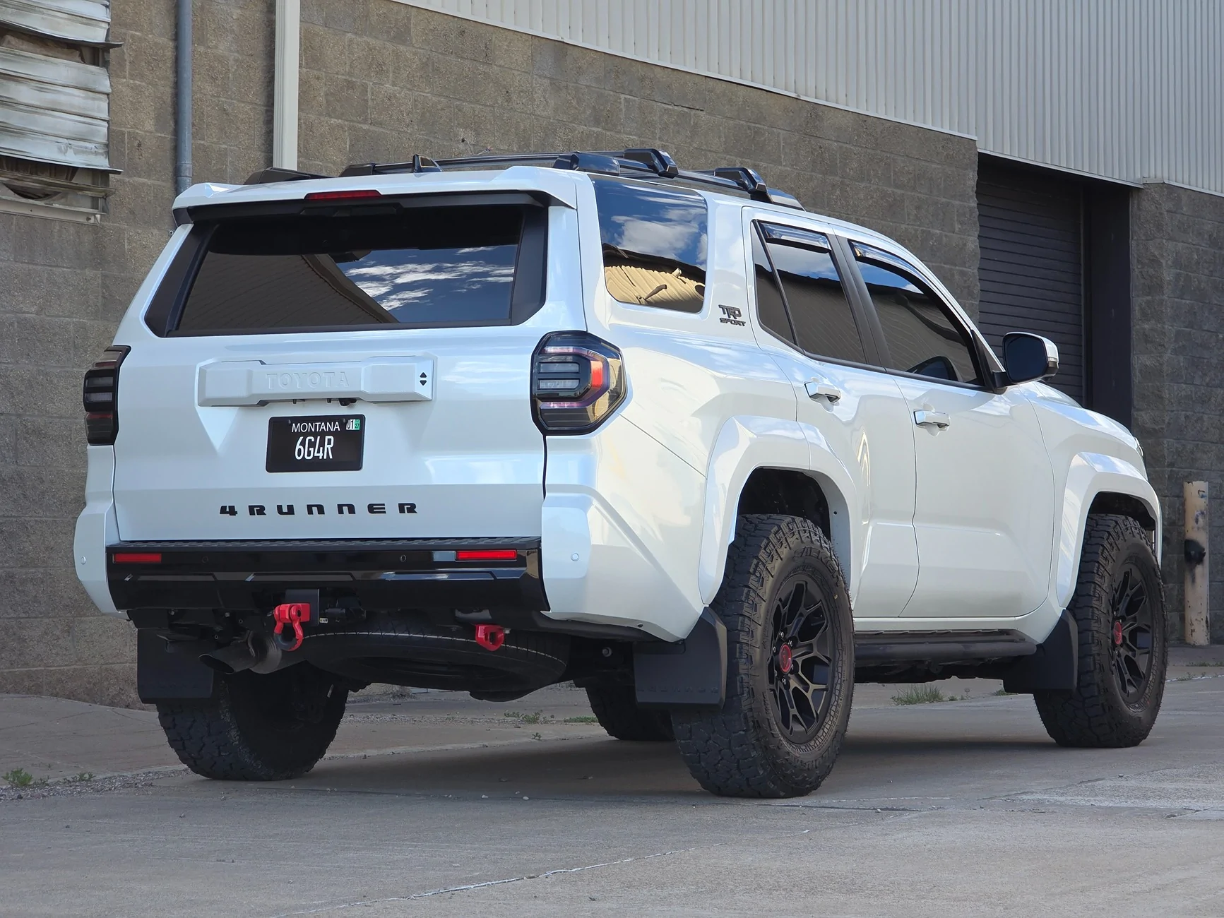

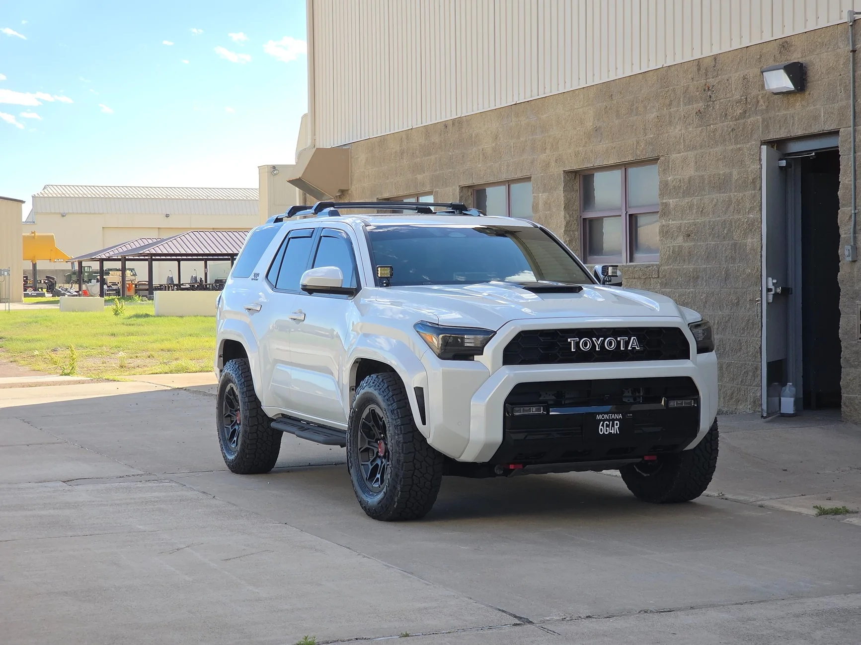

Thinking of getting the TRD pro wheels with +20 offset for my SR5. Can I run 275/70r18 without rubbing on stock suspension with NO lift. All the answers I’m finding include a lift.
BonRunner
Dec 2, 2025
505
579
2026 TRD Sport Premium / WCP
Yes, they'll fit. I have them on now, Falken Wildpeaks AT4W. Front mud flaps will rub, so remove them. No lift.
I have on Pro trim mud flaps. They are slimmer & wider. No rub!

Thanks! How’s the articulation of the front suspension and wheels when you off road? Does they hit the body?

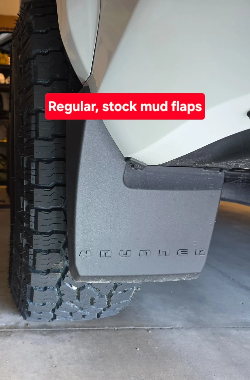

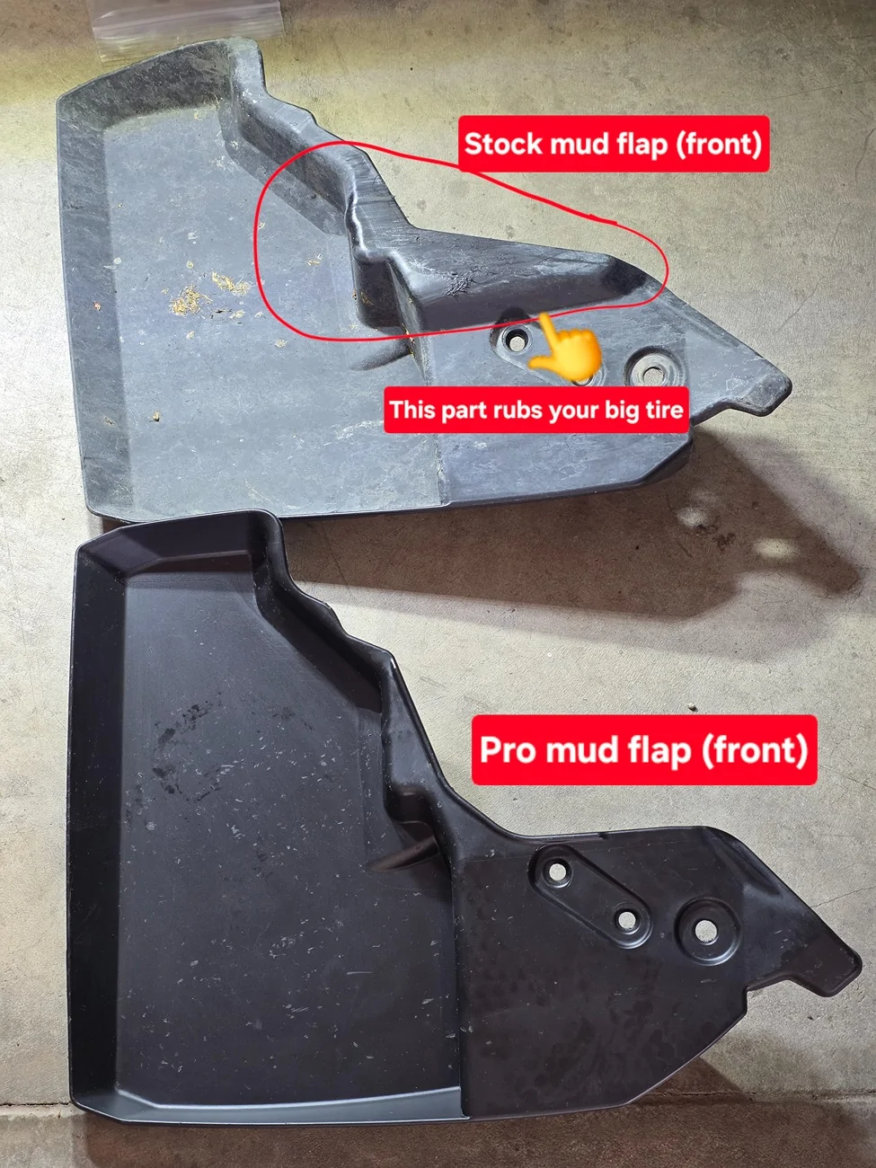

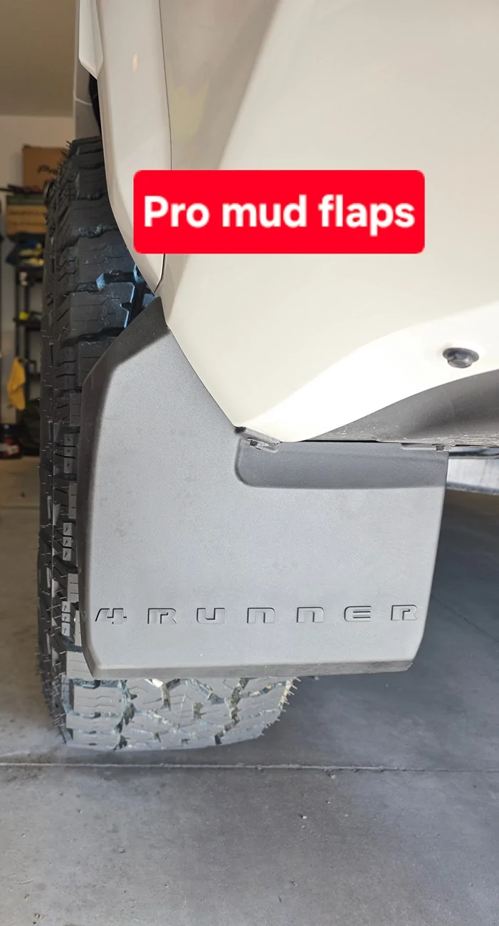

Hello, I like your mud flaps you mentioned you have the pro trim mud flaps? I was told they will stick out. I have not seen them in person but yours seem to cover the offset difference for the front and rear wheel. Are those Factory oe Pro mud flaps? Thanks in advance
BonRunner
Dec 2, 2025
505
579

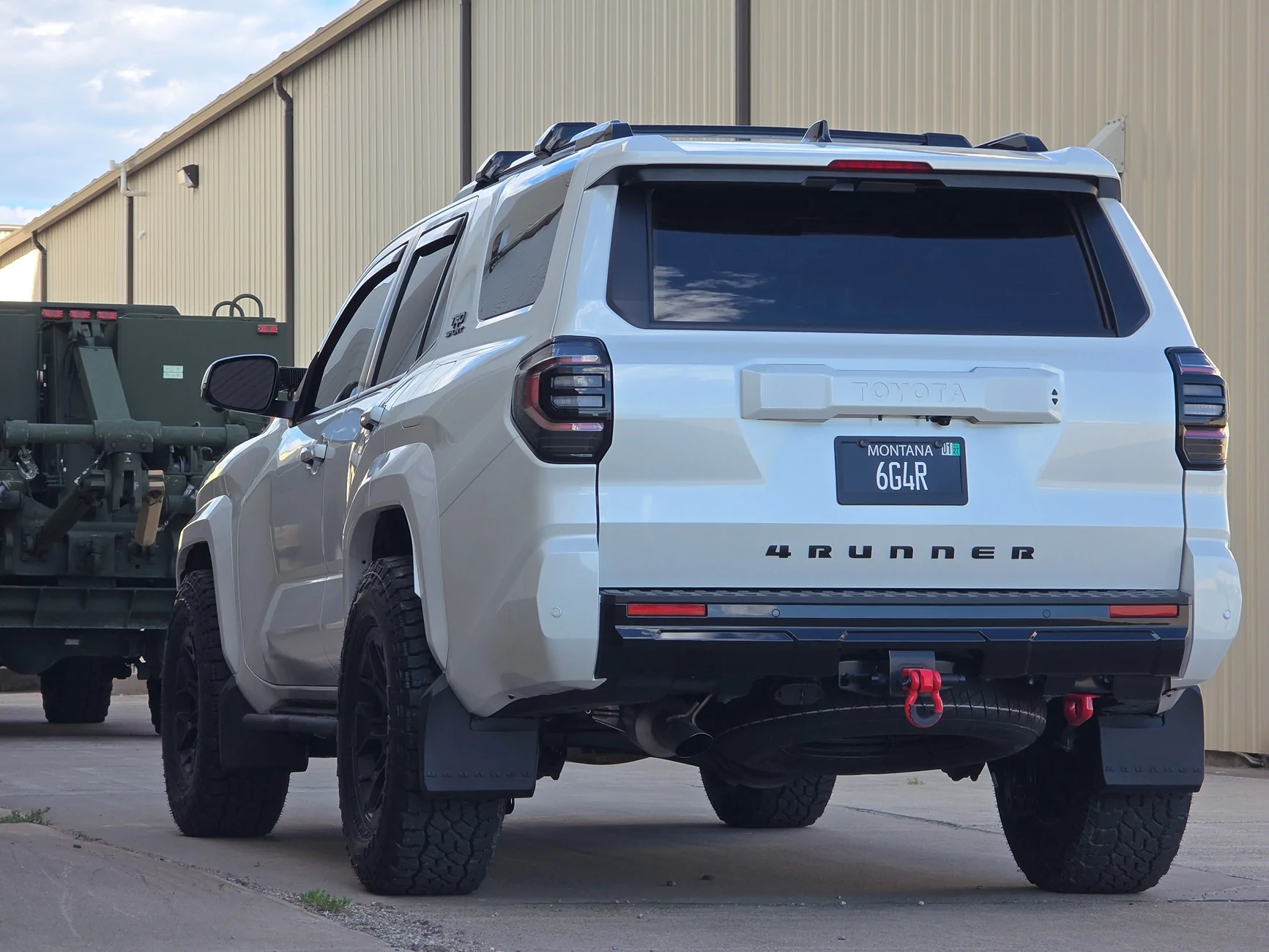

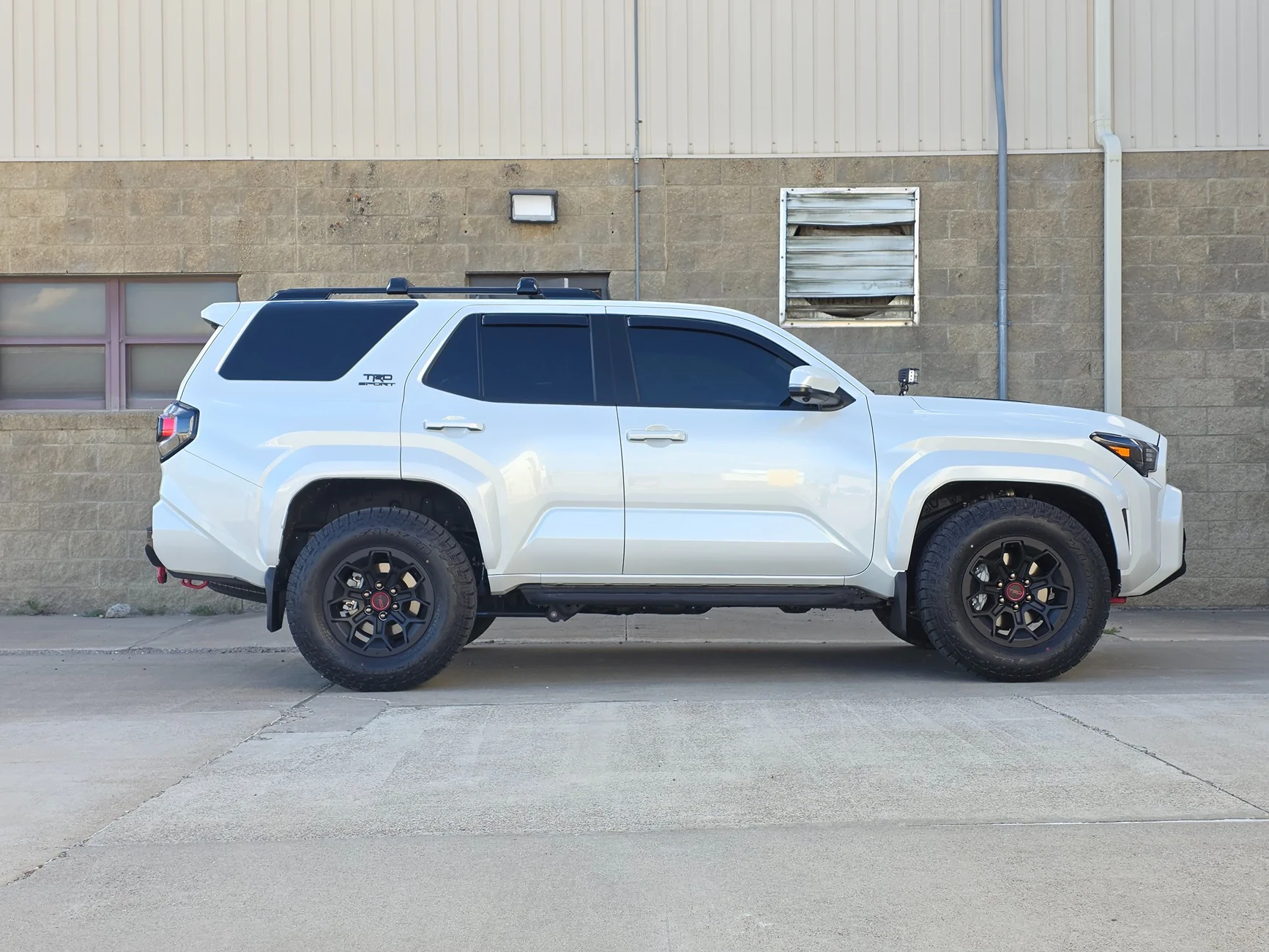

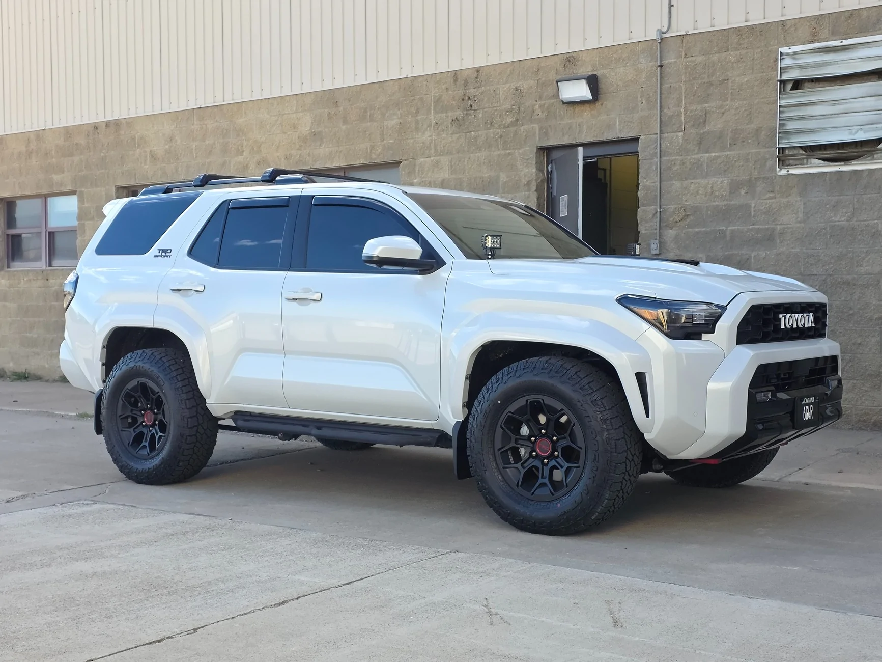

As I said, I have the Pro mud flaps. You buy them from Toyota. They come stock on Pro/Trailhunter trim. All other trims have standard flaps. They are wider & slimmer. They won't rub your big tires (I have 275/70/18; 33.5" tires). The rub is mainly on the front set. Rear doesn't rub. Stock flaps looks smaller too. Pro flaps have wider coverage. See pics below:
