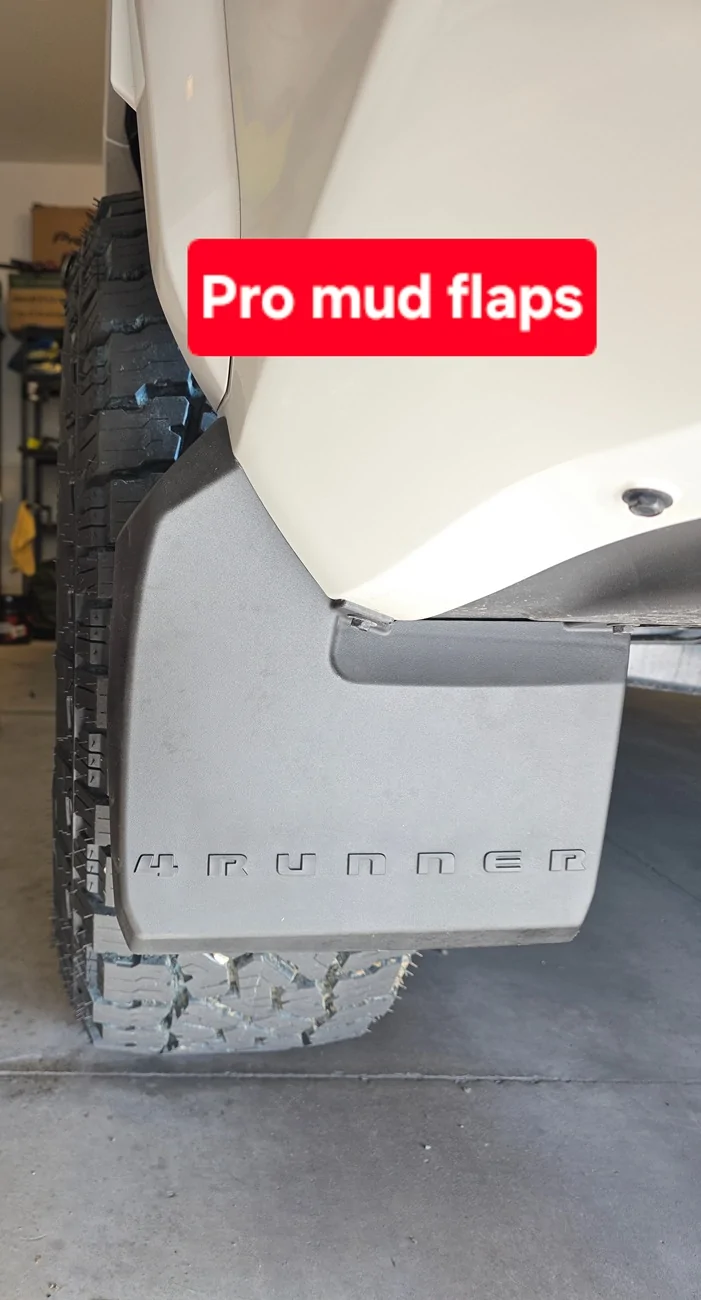

General Tire Grabber aTx come in C rating for 275/70/18. In addition, they will rub on your front mud guards unless you install the oem mud guards from a TRD Pro or Trailhunter. These are only 1' wider but have a flush fit against wheel well.
Yup, my 275/70/18 Falken Wildpeaks AT4W rubs on stock mud flaps. Installed Pro flaps which is wider & slimmer = no rub!
