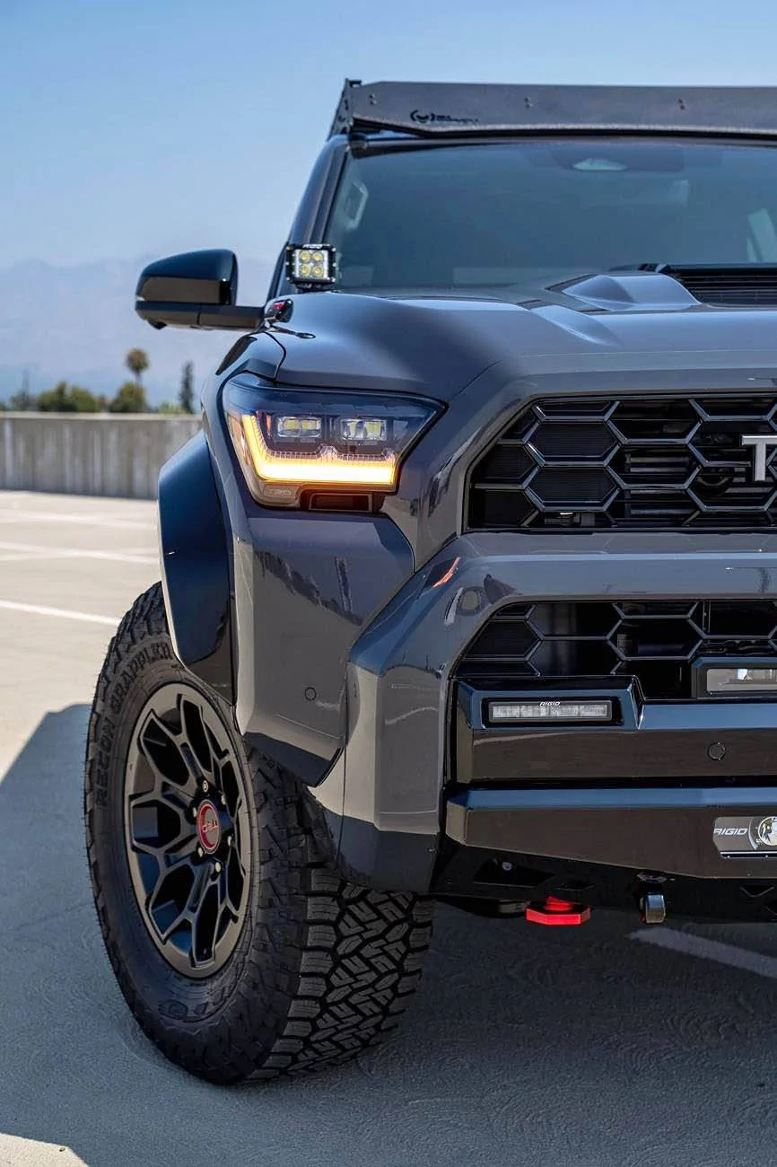

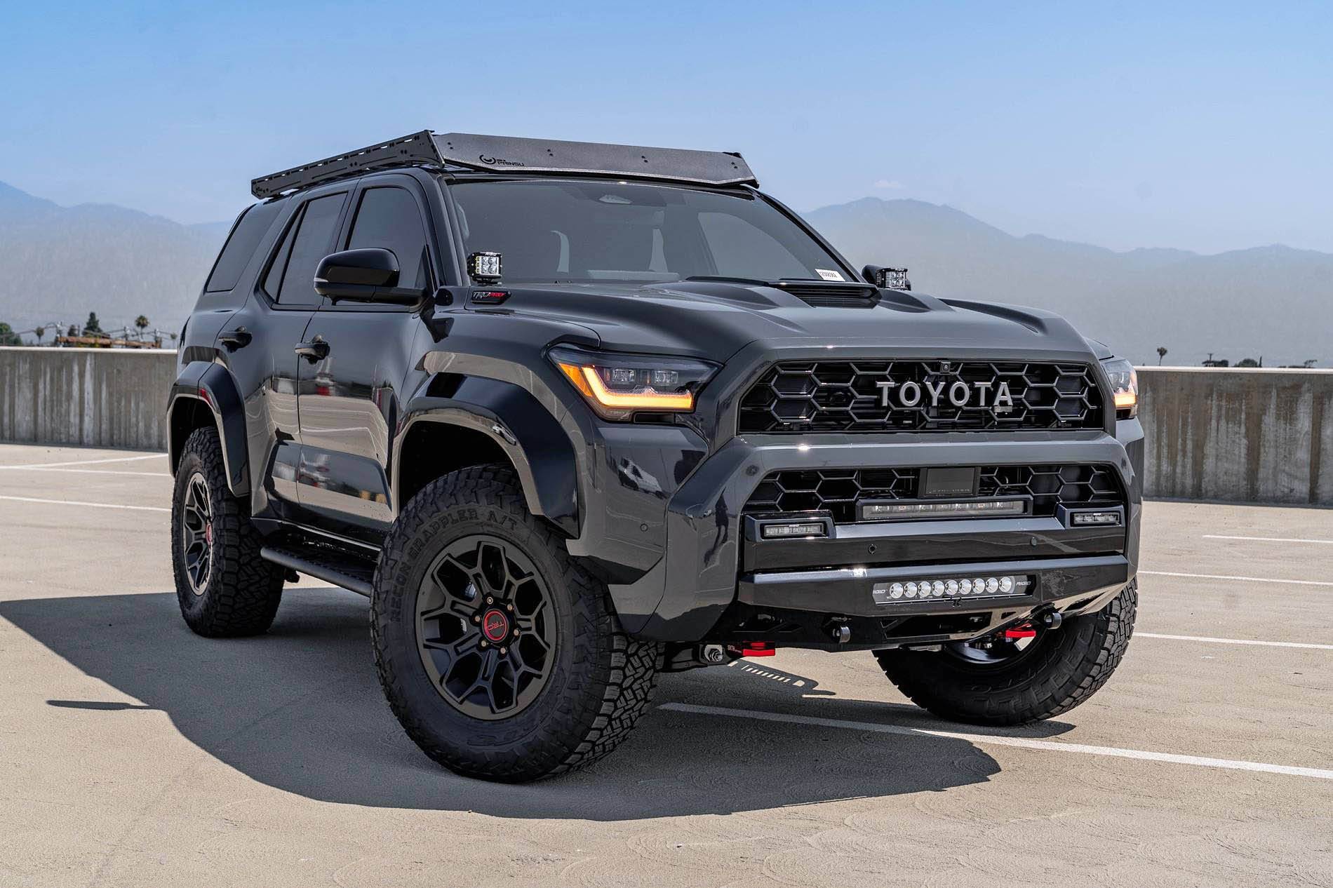

Amazing build and inspiring. Having 295s any rubbing at speed bumps while wheels turned? I’m getting 295-70-18 Toyo RT on my stock trd pro wheels today and hoping removal of the mud flaps and crash plate will do it for me as well.
Thank you, I appreciate the kind words. No rubbing issues at all and I don’t even have my lift yet. Just removed the crash plates and no issues. Just be aware that I believe the RTs are heavy and E loads. The ride will be extremely rough. Just an FYI.

Were you still able to still run the TRD skid plate??
Not at the moment. The holes on the bumper are slightly off from the frame holes. It will
take a little bit of drilling to open the holes to match up. I may or may not put it on.

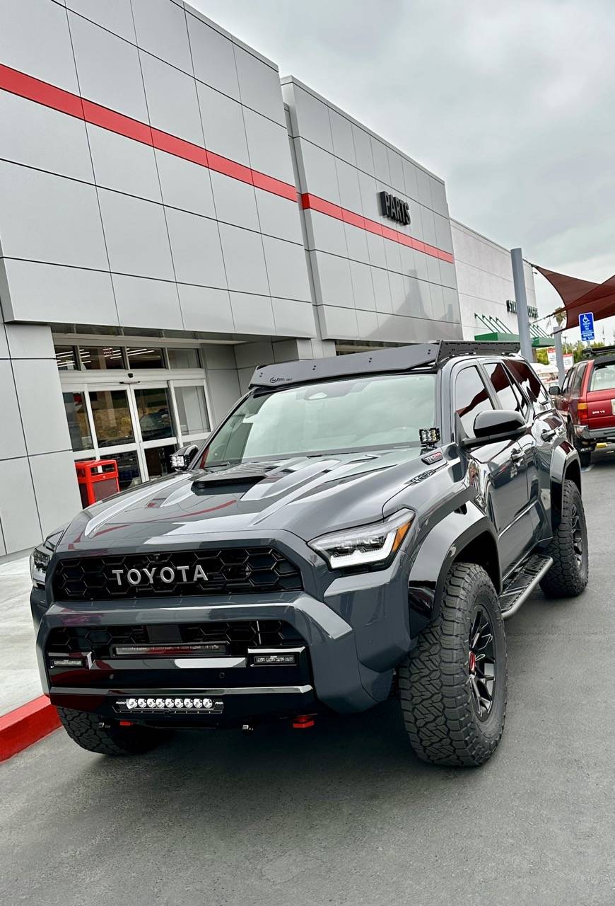

i just installed on my trd pro. Install video coming soon. I opted for no light bar but put a warn 12k lb winch. The light bar bole is perfect cause it allows me to get my hands up to the winch to release the winch clutch.
Yeah, I understand. My remote worked all of about 15 seconds. I did have the light installed and can’t get to the clutch or hard wire the remote without removing the grille entirely. I don’t know yet if it’s a short or if it’s the remote of the Warn winch. They are apparently notorious for going bad. We will get it squared away though. There’s a way to relocate the control box under the hood or mount in front of the radiator, so it looks like that will be my next mod. 🙄
Do yourself a favor and order a pack of those plastic button fasteners. I’ve already lost two of those just trying to figure out how I am going to make all of this work.
