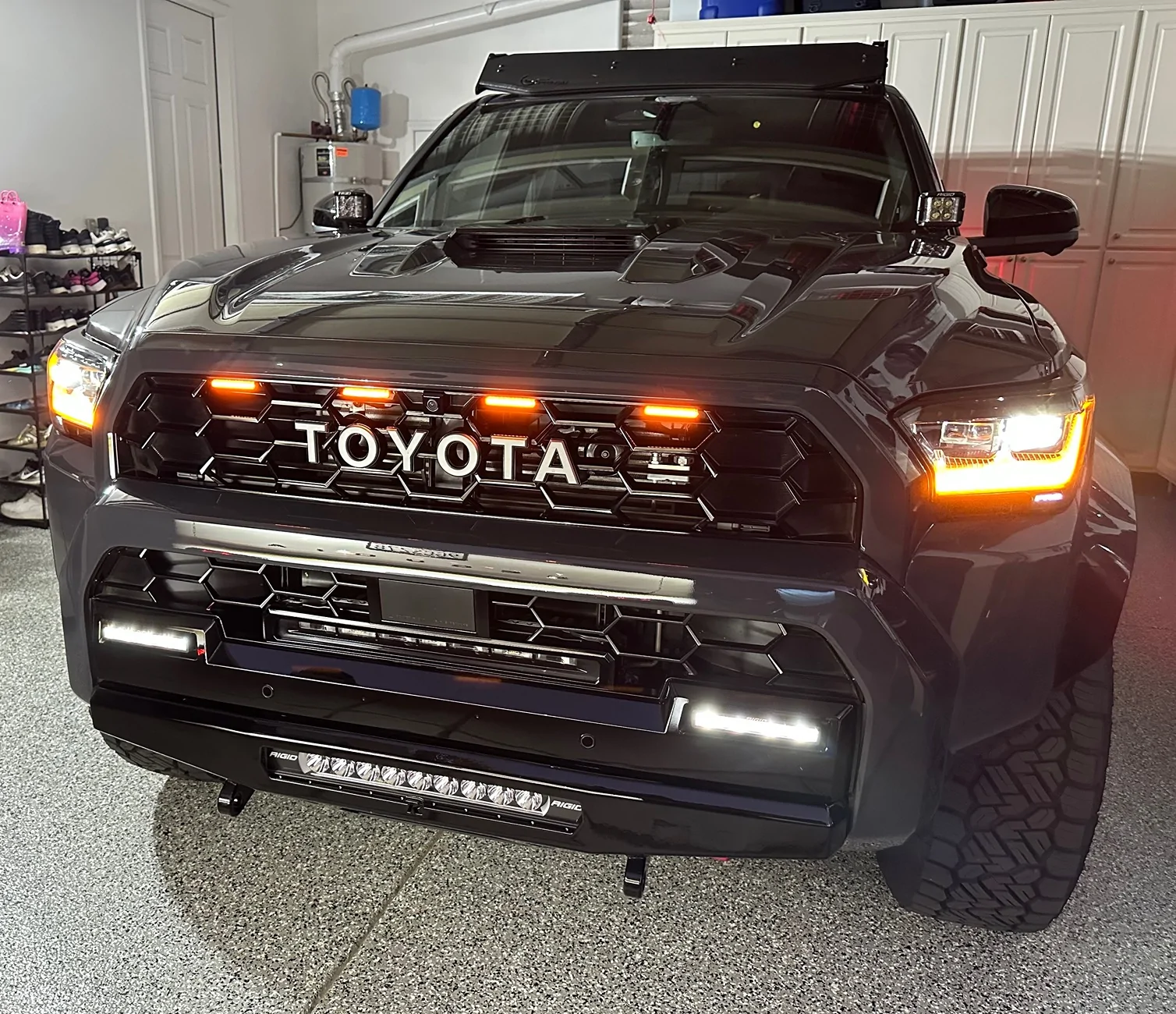

Yeah, I understand. My remote worked all of about 15 seconds. I did have the light installed and can’t get to the clutch or hard wire the remote without removing the grille entirely. I don’t know yet if it’s a short or if it’s the remote of the Warn winch. They are apparently notorious for going bad. We will get it squared away though. There’s a way to relocate the control box under the hood or mount in front of the radiator, so it looks like that will be my next mod. 🙄

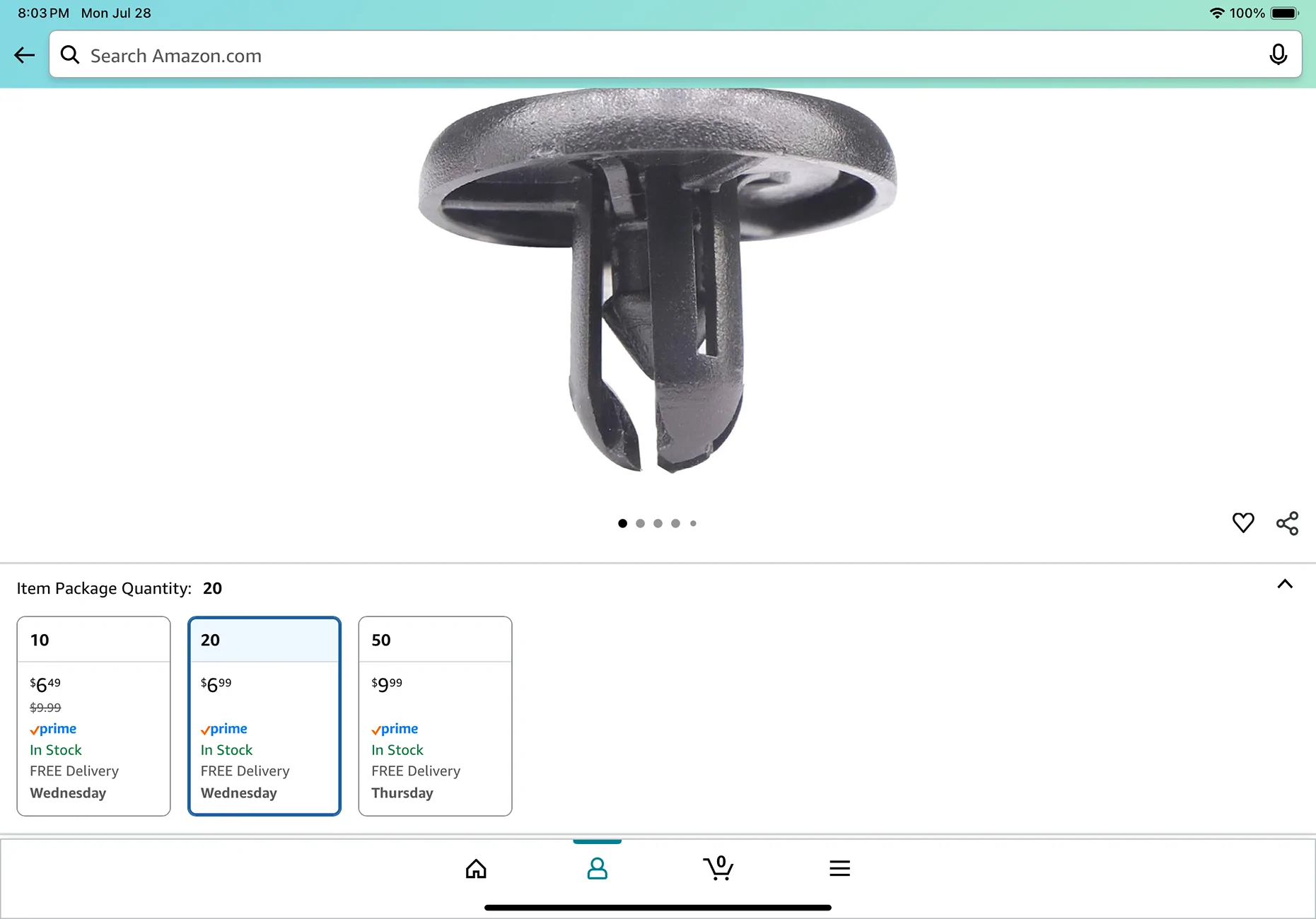

Do yourself a favor and order a pack of those plastic button fasteners. I’ve already lost two of those just trying to figure out how I am going to make all of this work.
haha. Already lost one myself. Good luck with your troubleshooting and fix. Let me know what you do.

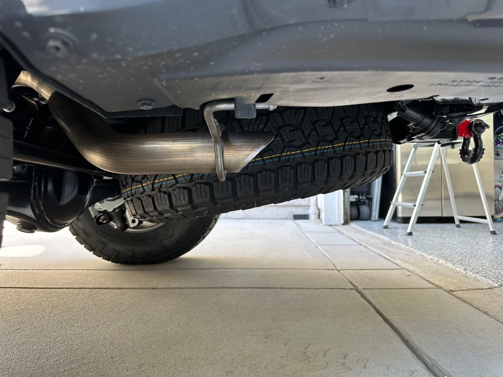

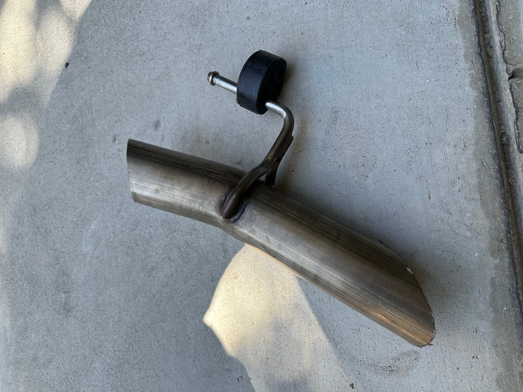

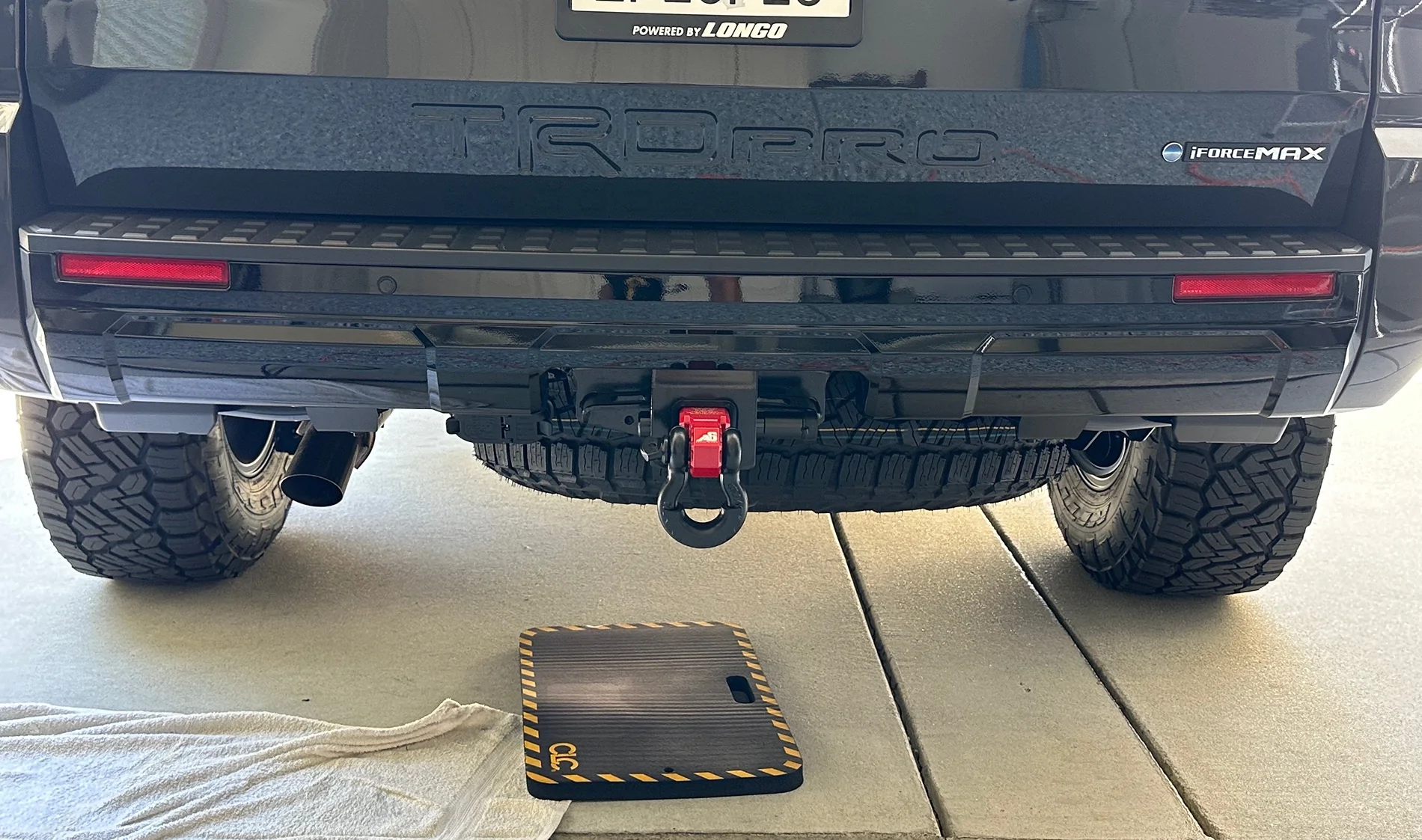

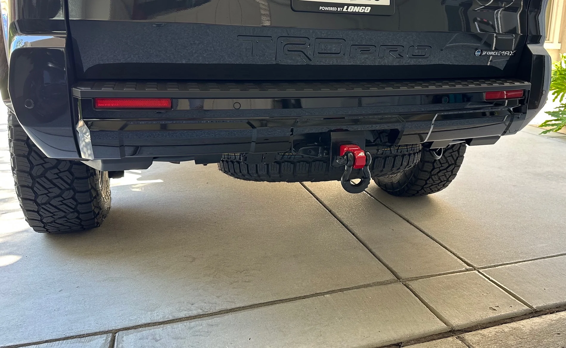

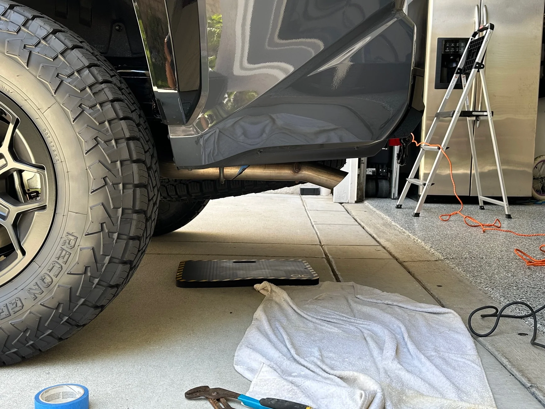

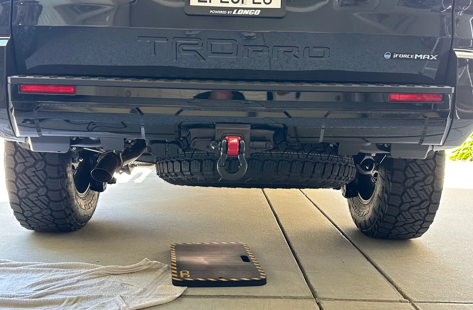

Cut off the hideous muffler dong. Took about 30 mins to cut it the way I wanted it and sand/buff it smooth. Cut off about 14". Can't see it anymore and it cleans up the back very nicely.
Before...
2025 2026 4runner 6th gen Papadop88's Underground 2025 4Runner TRD Pro 6th Gen Build IMG_0100

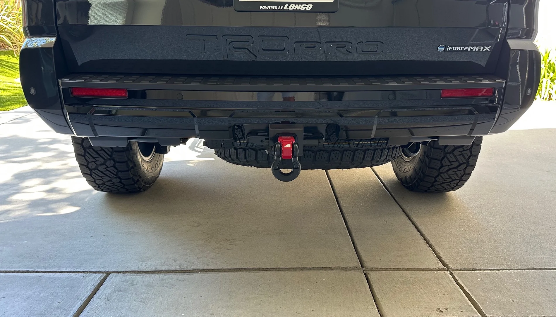

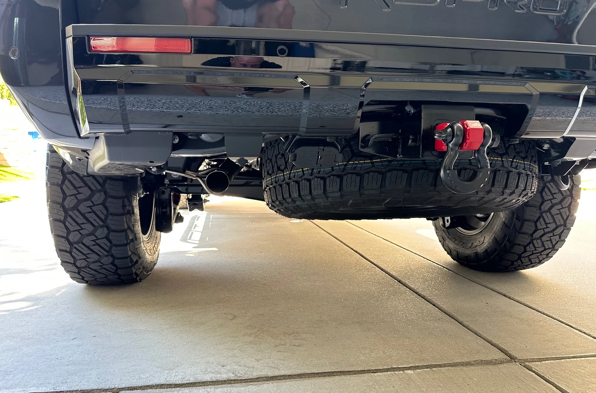

After:
2025 2026 4runner 6th gen Papadop88's Underground 2025 4Runner TRD Pro 6th Gen Build IMG_0103

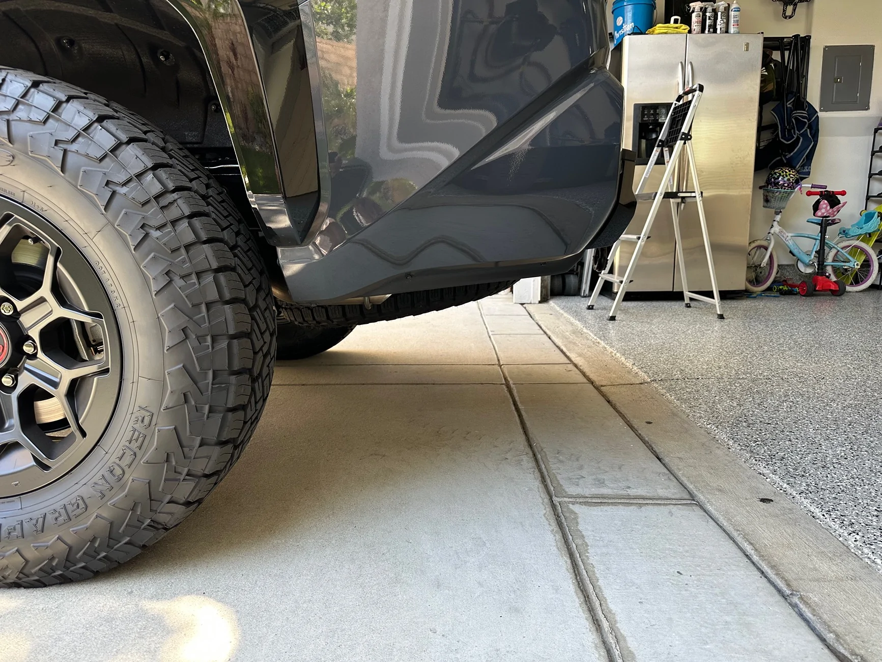

Some more pics:
2025 2026 4runner 6th gen Papadop88's Underground 2025 4Runner TRD Pro 6th Gen Build IMG_0101
2025 2026 4runner 6th gen Papadop88's Underground 2025 4Runner TRD Pro 6th Gen Build IMG_0102
2025 2026 4runner 6th gen Papadop88's Underground 2025 4Runner TRD Pro 6th Gen Build IMG_0104
2025 2026 4runner 6th gen Papadop88's Underground 2025 4Runner TRD Pro 6th Gen Build IMG_0105
2025 2026 4runner 6th gen Papadop88's Underground 2025 4Runner TRD Pro 6th Gen Build IMG_0106
2025 2026 4runner 6th gen Papadop88's Underground 2025 4Runner TRD Pro 6th Gen Build IMG_0107
2025 2026 4runner 6th gen Papadop88's Underground 2025 4Runner TRD Pro 6th Gen Build IMG_0108

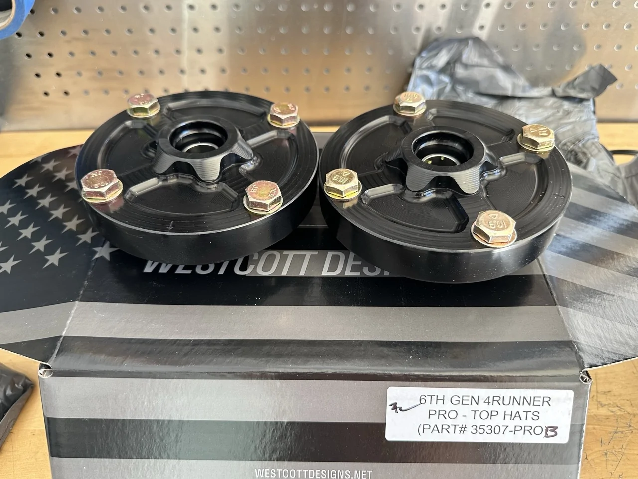

So, the day has finally arrived. I was one of the first, if not the first to pre-order the Westcott Designs collar lift kit months ago and they finally arrived. So for those of you who ordered this kit for the Pros, they should be shipping out to you soon.
Here was the issue. When WD was R&Ding these for the Pros and Trailhunters they realized the bolts on the stock top hats weren't long enough once you put the collar on, so they went back to the drawing board. Not sure why Toyota did that with the 4Runners when the Tacomas clearly didn't have the same issue. Nonetheless, WD designed and built these 1" top hats out of billet to get these collar lifts to work.
The top hats arrived today. The rest of the lift kit comes on Tuesday. Here's a couple pics of the top hats. They seem to be extremely overbuilt and solid. Beautiful design and anodizing, per the usual from Westcott Designs.
2025 2026 4runner 6th gen Papadop88's Underground 2025 4Runner TRD Pro 6th Gen Build IMG_0307 Larg
2025 2026 4runner 6th gen Papadop88's Underground 2025 4Runner TRD Pro 6th Gen Build IMG_0308 Larg

Those look pretty damn trick. 1” front and anything for the rear.
These hats come with the whole kit for the Pros, so yes, there will be rear pucks along with the pre-load collars coming on Tuesday. I only want a small lift in the front so might only put the top hats on with the rear .75" puck in the rear.
