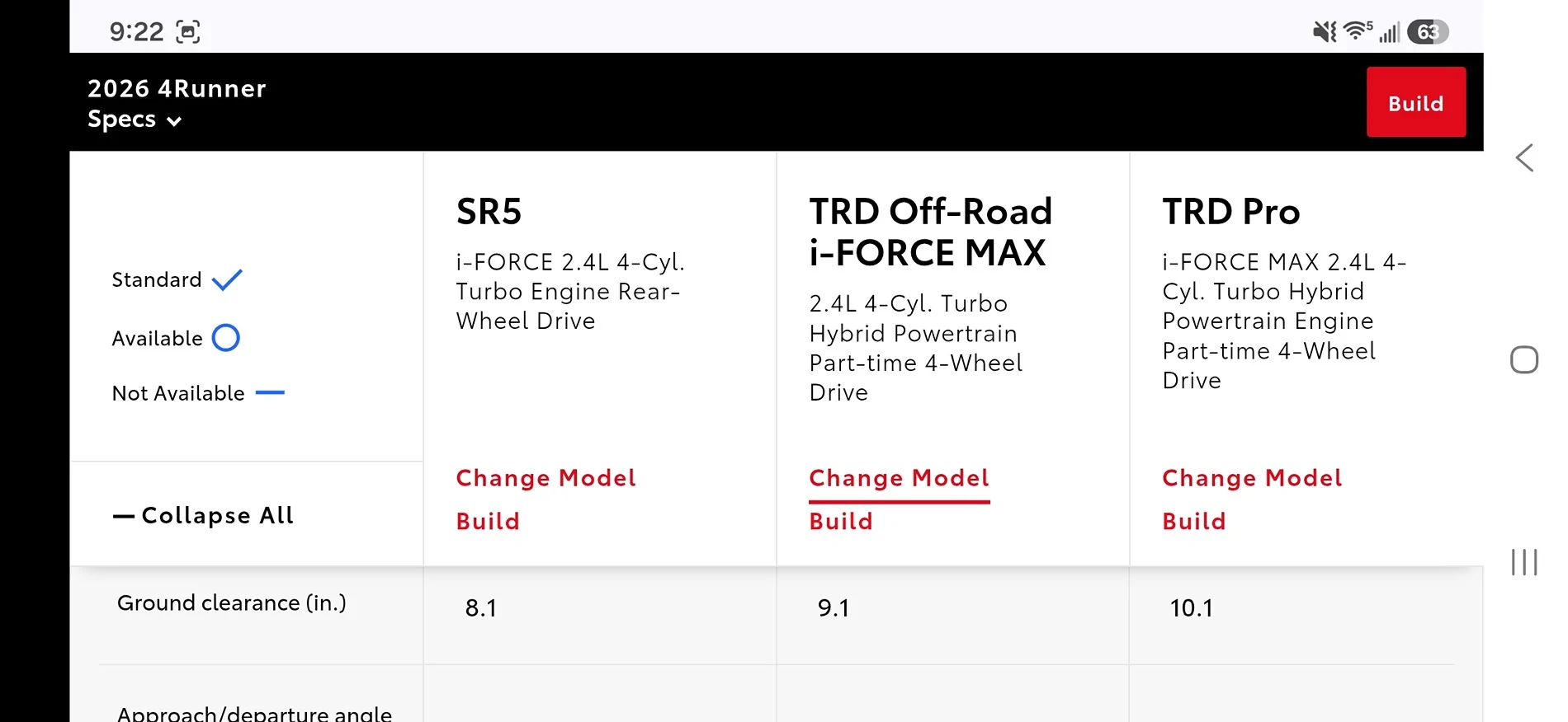

Somehow its got 1" lift but only .4" taller than an ORP and 1.4" taller than SR5 and this is what is says when you search this s what chatgtp comes up with.
2026 4Runner TRD Pro Suspension Upgrades:
  • Factory Lift: Approx. 0.5-inch higher than TRD Off-Road, utilizing specific TRD-tuned springs.
It seems like the clearance would partially be due to from what I can tell the pro doesnt come with an air dam.

Yeah, look at the specs on the Toyota website.
That's ground clearance not lift, I'm looking for actual lift values.

I guessing the .5 value I found I is difference between the PRO and TRD Off road, the rest are likely just tire size difference. That is assuming the height spec on Toyota is correct. I can say it was on the TRD off road. I physically measured a couple before I bought to insure everything would fit in garage. I guess it would be interesting to get someone with a bone stock Pro to verify the height.

Honest question: what does "actual lift values" mean? Wouldn't it have to be relative to something and wouldn't ground clearance be at least a proxy for what the relative measure must be related to? I'm really not trying to be argumentative. I seriously want to understand. (Also ref this post I made on related topic: Real/Practical Differences between TRD OR and PRO/TH Suspensions
Would not over all height be a better measurement since it's also listed on the Toyota Website? Ground clearance is 1" between the PRO and ORP but the overall height is only .4". That tells me it's not purely the height of vehicle that making the ground clearance difference. They use same tire size so it's the easiest comparison and you can compare hybrid to hybrid.

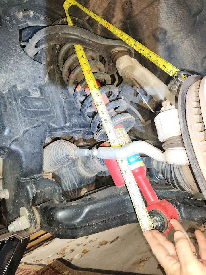

I've researched your question of "actual lift value" without success. So I decided to measure my TRD ORP Bilstein shocks - this is measured at "full droop" without tire/wheel mounted so it's probably not very helpful but it is a data point.
What would be interesting for this discussion is a measurement of stock THunter & PRO & TRD OR & SR5 shock lengths under "curb" load. (recognizing that there are differences in weight between the trims). I may go crawl under a THunter at the local dealer and do this:>)
(BTW - Since this is a THunter originated thread, I am also curious how the THunter Old Man Emu set up differs from the OME MT64 kit 2135. Am going to ask ARB)

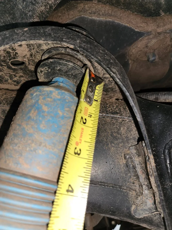

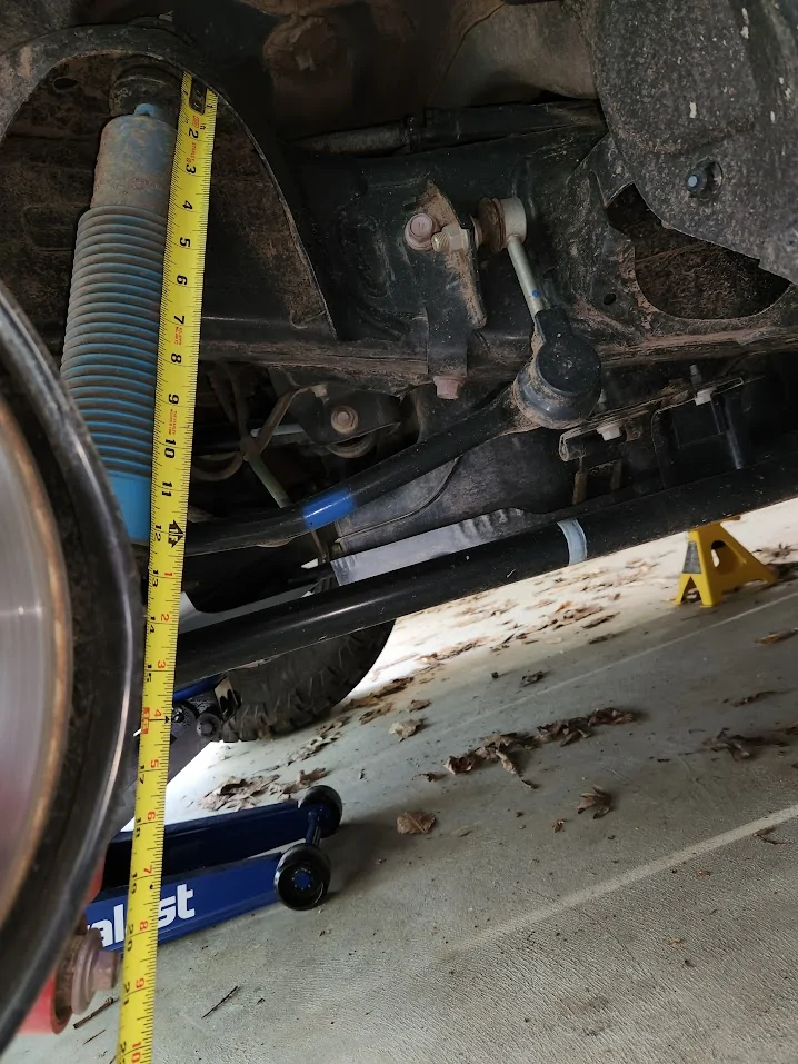

But, FWIW (not much?) the TRD OR front and rear shock lengths while mounted and '"drooped":
Rear: 20.5"
2025 2026 4runner 6th gen Overlook Package ordering available for 2026 4Runner 20260417_125853
From bottom of upper mounting location:
2025 2026 4runner 6th gen Overlook Package ordering available for 2026 4Runner 20260417_125651

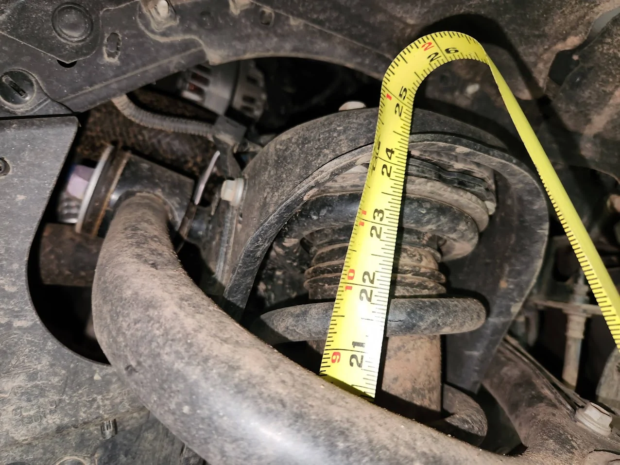

Front: ~23.5" to top of spring:
2025 2026 4runner 6th gen Overlook Package ordering available for 2026 4Runner 20260417_102844
2025 2026 4runner 6th gen Overlook Package ordering available for 2026 4Runner 20260417_102857

Although it is argued that ground clearance has issues because of tire size differences, since the stock THunter, PRO and TRD OR have the same tire size, it seems to me that the ground clearance number between them is pertinent. My current hypothesis is that the 1" specified difference between THunter & TRD OR comes from the length of the shocks - hence my (flawed) measurements and suggestion for better measurements of the different trims.
If my logic is flawed, can someone point that out and explain why? Thanks
