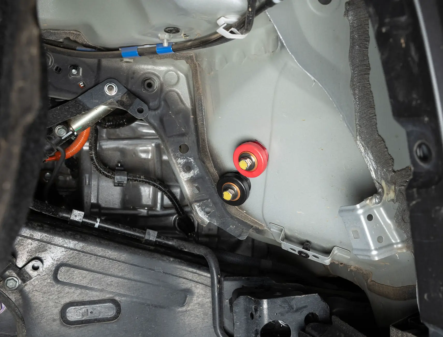

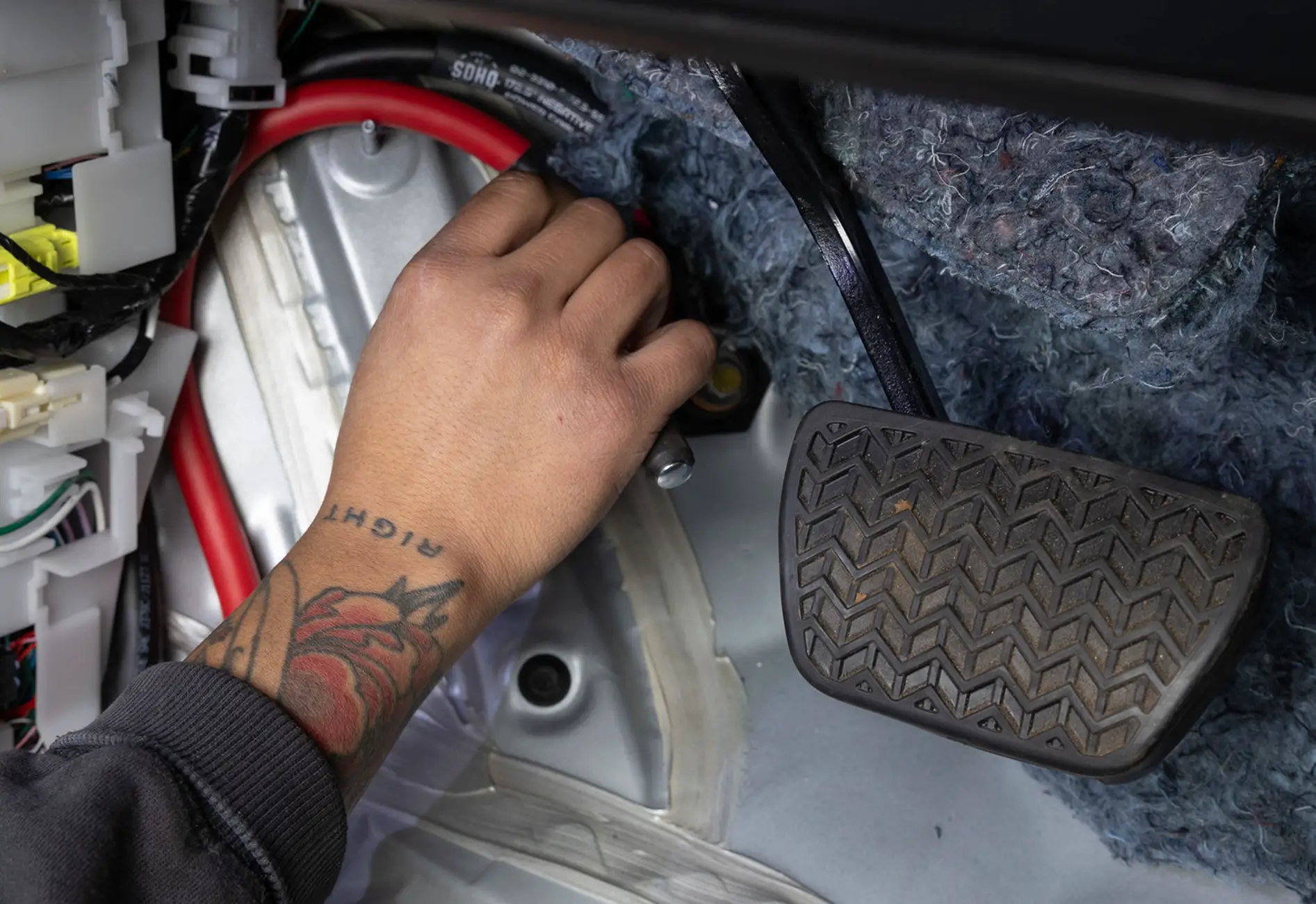

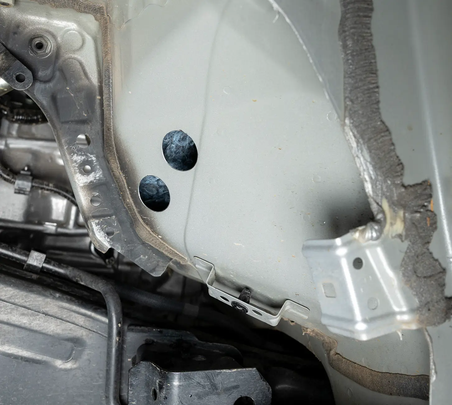

I love your setup, this is a great rig you have. I have a question. When seeing up the SDHQ power relocation kit, did you run the wire from the battery to the engine bay through the firewall? Rr did you follow the instructions in the kit and do the drilling etc. that it shows?

Hi @OvrLnd99,
Yes, it ran under the trim, as described in the install manual, and then punched through 2 holes that were drilled into the metal behind the driver-side wheel well to bring clean power up to the engine bay. You can see that in these photos. The connector hardware that mounts through the holes is solid weather-sealed with gaskets, so no concerns. I recommend doing it that way.

Thank you for the response and feedback. I appreciate you providing the details and all the write up information you provided. I am looking at doing a very similar build.
