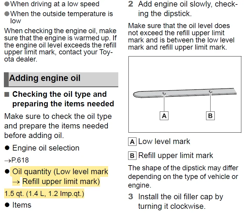

just a reminder that the amount of oil between the low and high divots is 1.5 quarts

Oh interesting… does the 5.9 qts in theory land at the upper divot? If so, would it be best to under fill a bit to avoid going over the 5.9qt limit?

doesnt say in the manual but i am guessing the top divot is 5.9 and the low is 4.5 (the manual states the gap between the divots is 1.5 qts)
its better to be slightly over filled than under filled if you are worried about the lesser of two evils.
highlight is mine (not the manual's)
