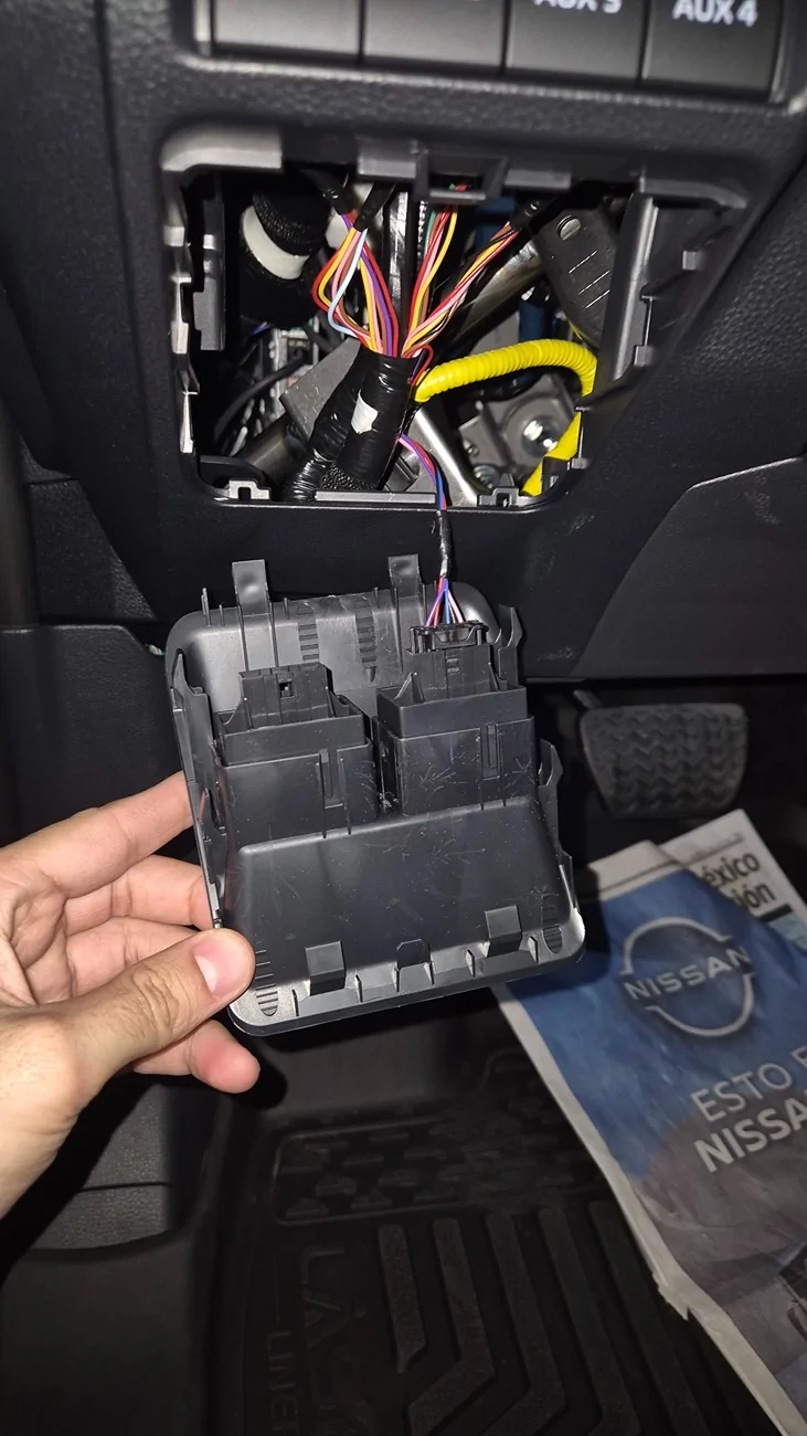

4runner limited 2026
Same here, lights installed but then I saw that on some trims there's a switch to control the cargo area lights ...
I opened the trim where the switch is supposed to be ( on my limited wasn't included) and found a connector..
I suppose that it's ready to connect the switch's but wondering if anyone have done this in the past?
