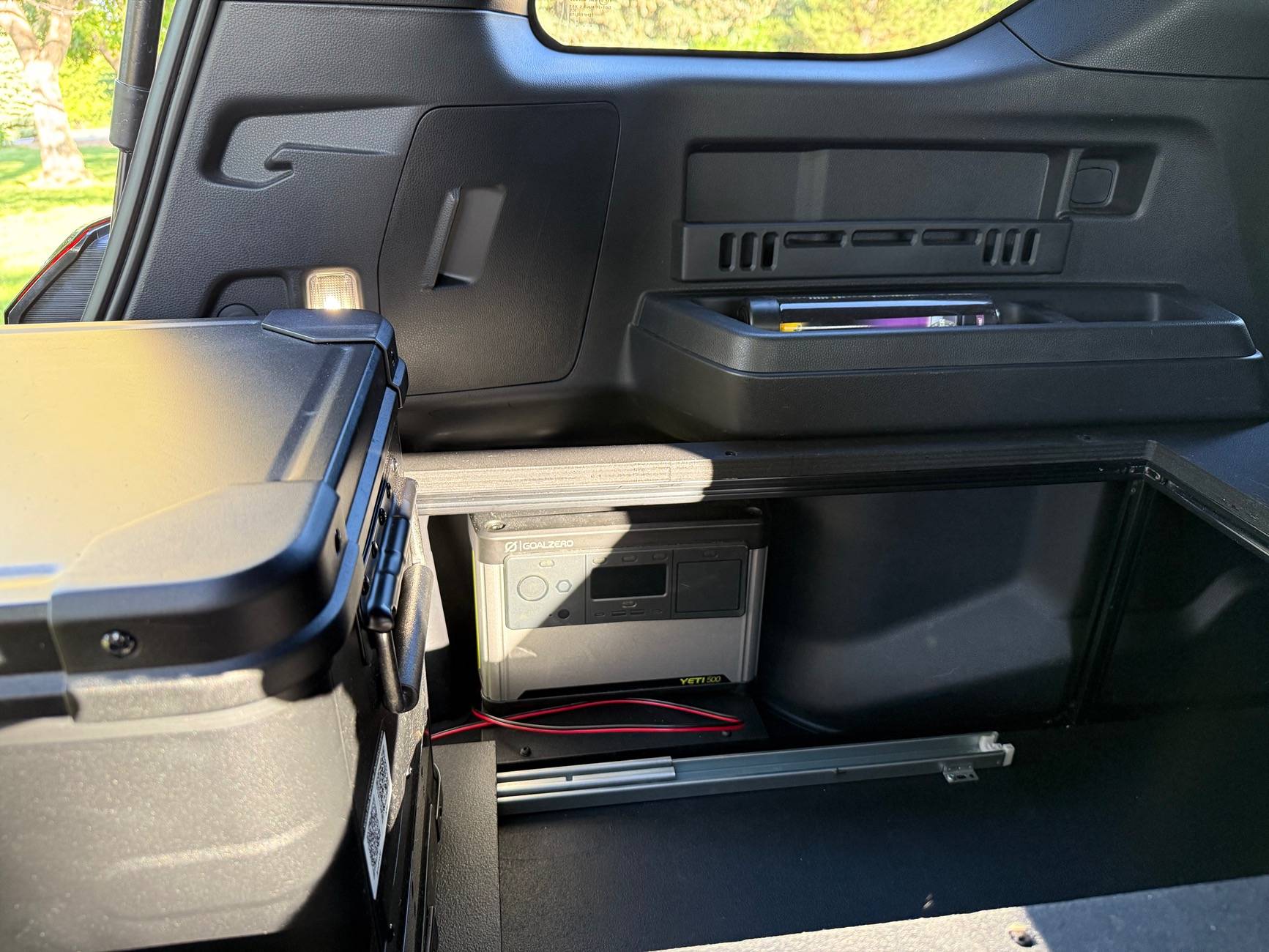

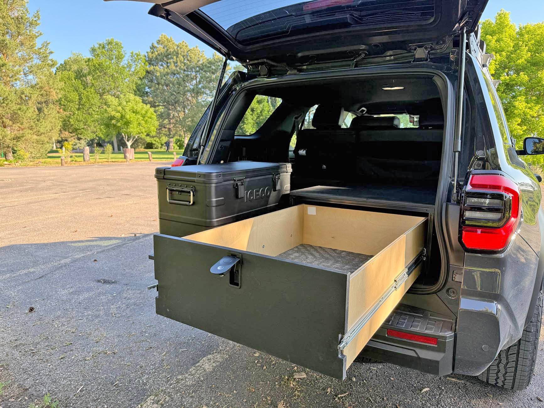

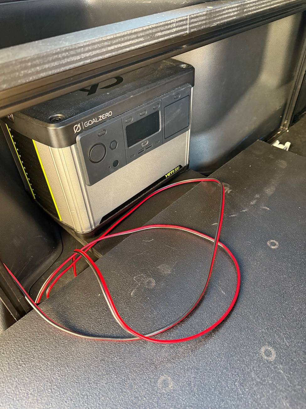

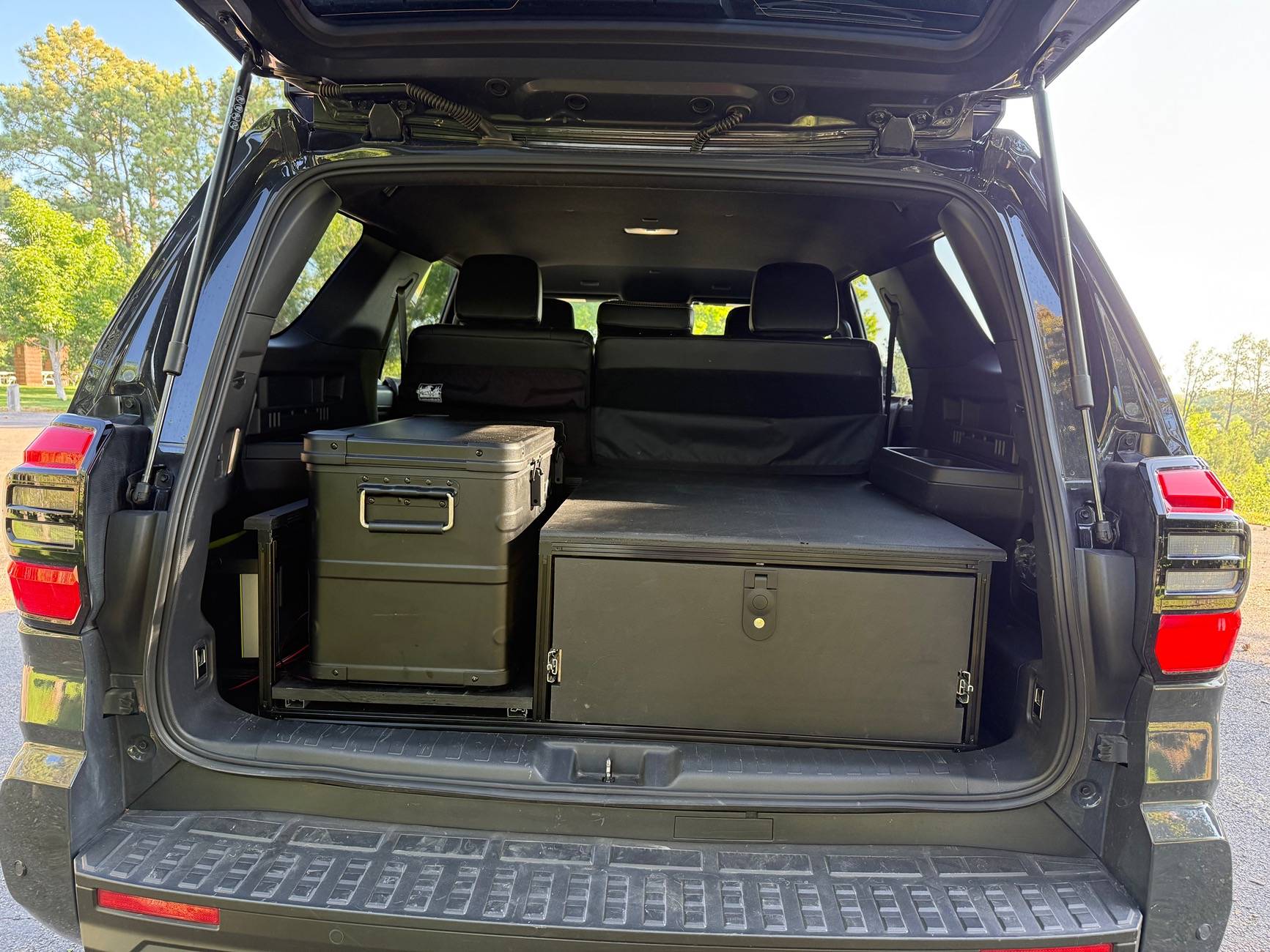

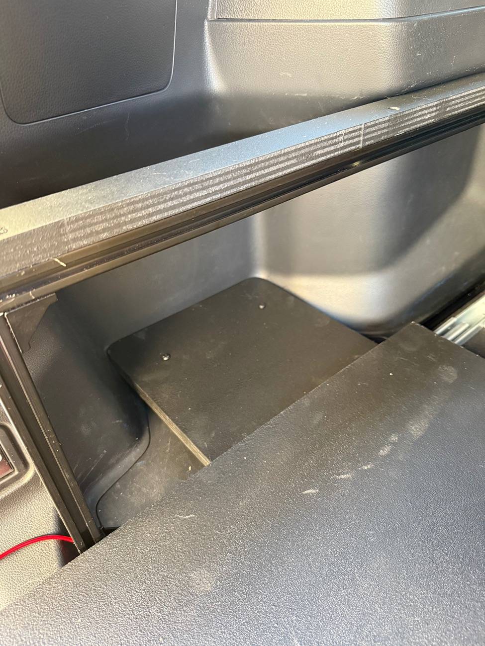

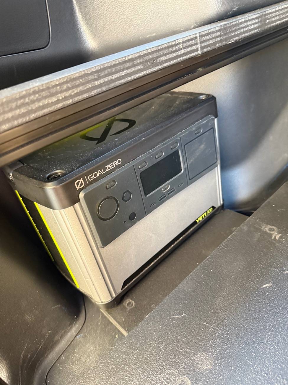

Built an additional side plate to hold my Yeti 500. This will power the IceCo fridge and whatever else I need when I am stealth camping. Additionally, I ran two sets of 14 gauge wire to the engine bay. One set will allow the 12v system to charge the Yeti while driving. The other will feed power from the yeti to engine bay. I will then connect the StarLink Mini power to the Yeti and not have to worry about the impact it has on the main battery. Now I just have to terminate all the wires and it would be set to go.

I also have everything painted and mounted ready to go. Just have to tie down the fridge and chase rattles which.

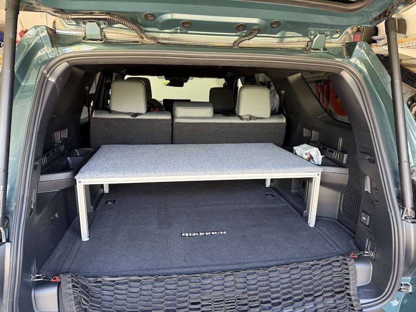

Thats perfect. Having that extra space under there is actually useful. I can store my snow peak iron grill table pieces under the drawer since I only need them once we get to camp. It's very handy as that thing is bulky. To get it in there I have to pull the drawer father out and then it just slides right in. Having an extra 1/2" is going to give you even more flexibility.
I am glad you're finding my post useful. That's why I love the forums.
I could store the sections that go over my rear seats to make it flat under there. Might be hard to get them under there though.
I had considered that as well. I can only fit the smaller side due to the width matching the frame on the longer side. I had also considered making a Z fold so I could hinge them and lay them over the back. It won’t be too much trouble to just install them when I need to. That will only be when I go solo, or maybe when I need to haul something larger.

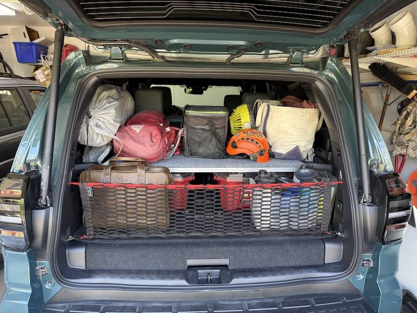

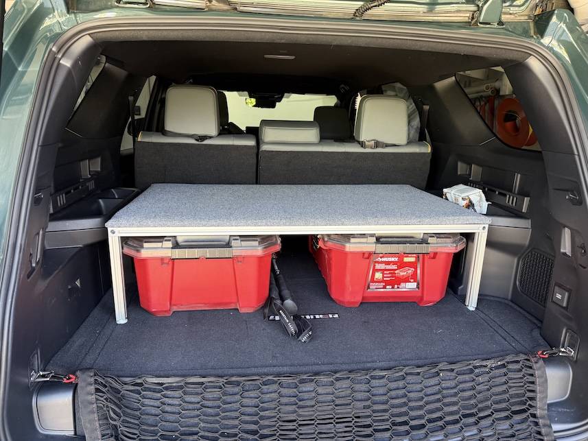

Here's my low-tech solution. I used 80/20 and Home Depot Husky containers. Not quite as elegant as an actual drawer but I can pull them out to access the air pump and I don't lose any space for mechanisms.
That looks great!! Those husky totes are awesome.
