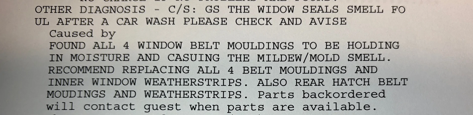

Needless to say, I took it to the dealer on Friday after washing it Thursday night.
They called and said it was ready to be picked up anytime, and they are replacing all of the lower window belt mouldings on all the glass positions. They confirmed the mouldings are holding moisture and have a very strong odor.
Of course, those parts are on backorder now, but at least we found a solution.
2025 2026 4runner 6th gen Odor/mildew smell from window mouldings on 2025 TRD Sport Premium (issue: muoldings are holding moisture / water) IMG_1305
The dealer is replacing the moldings, but are they replacing the moldings with the exact same molding material? Doesn’t that mean the problem will eventually reoccur? Or are they using a different type of molding material?
I hope they are solving your problem and not just creating a new cycle of replacement every so often.
I agree that’s a worry I already had in mind. Apparently, other people have complained about this on the new generation Landcruisers and some highlanders, so it is possibly isolated to certain date of manufacture.
If the design is holding moisture, and it isn’t revised on the new ones, I will be concerned.
I am going to ask to take pics of the new ones and the old ones that are removed.
