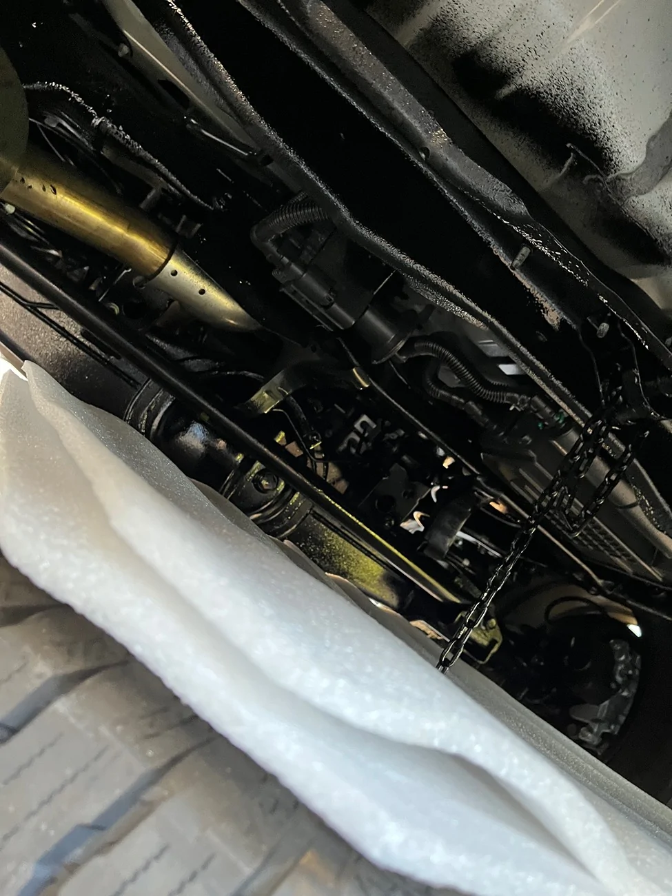

Hey OP, thanks for this thread!
I was fluid filming and adding skid plates this weekend when I saw this thread, so I thought I’d check my full-size spare I added a month ago. And, yep, I had a small amount of wear on the same spots. Added some packing material from the skid plates as a buffer between the spare tire and the frame. Hopefully that will stop the wear.

the slight vibration will rub a hole thru that sheeting eventually.
you need something more along the lines of metal cover. best bet would do like the old days and get a cardboard cutout for when you spray the tires with armor all and wanted to cover your wheels.
and use that as a template to cut out a metal cover

One concern I have is the hot exhaust is right next to that. It doesn't look like it would tough
58
2,552
1,445
the tire outer tread would be affected by it more than the metal plate would (since the outer circumference of the tire would be closer to the exhaust piping). there is enough airflow underneath to negate the heat soak i think, unless you are sitting for long periods of time idling.
