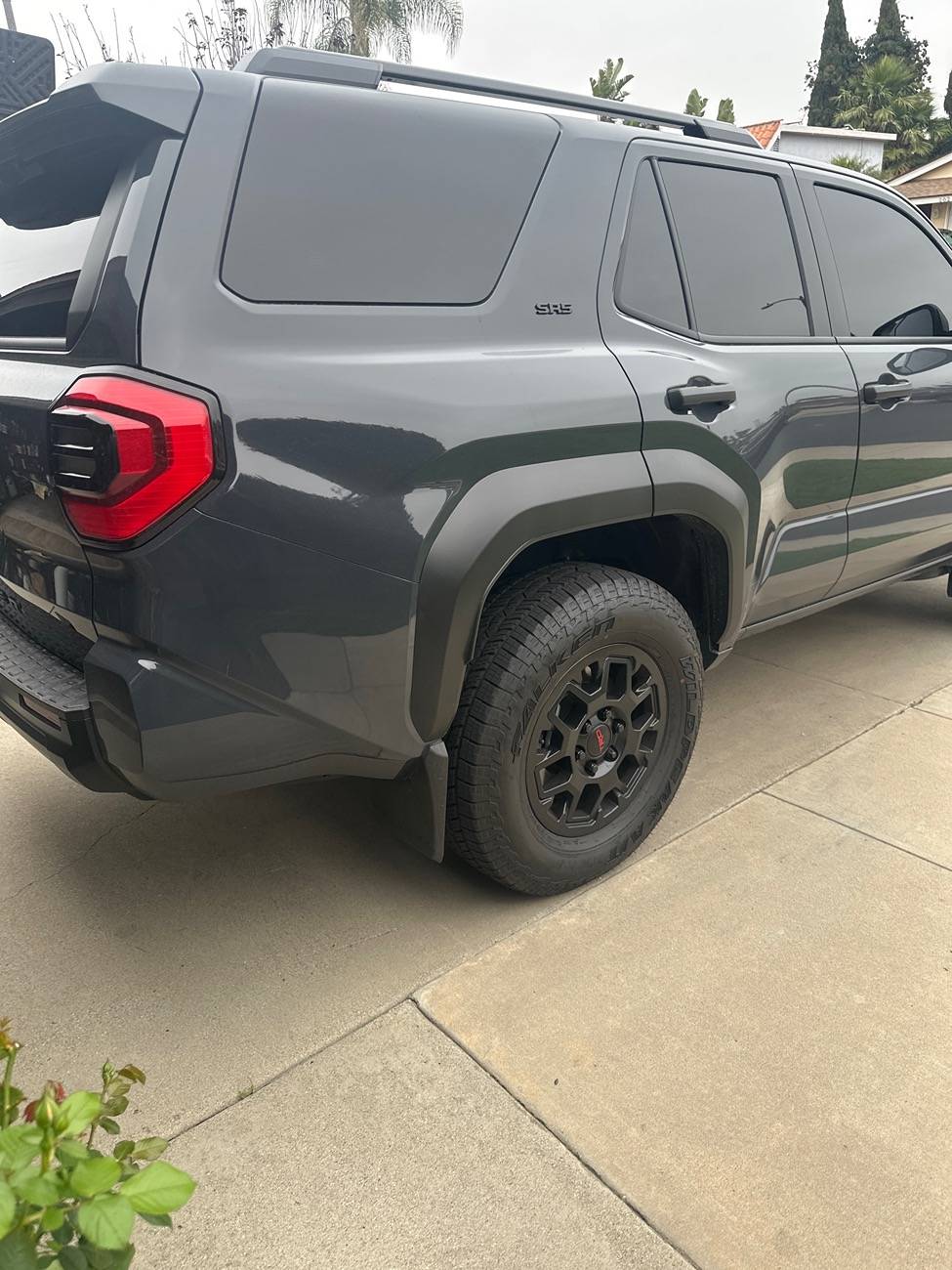

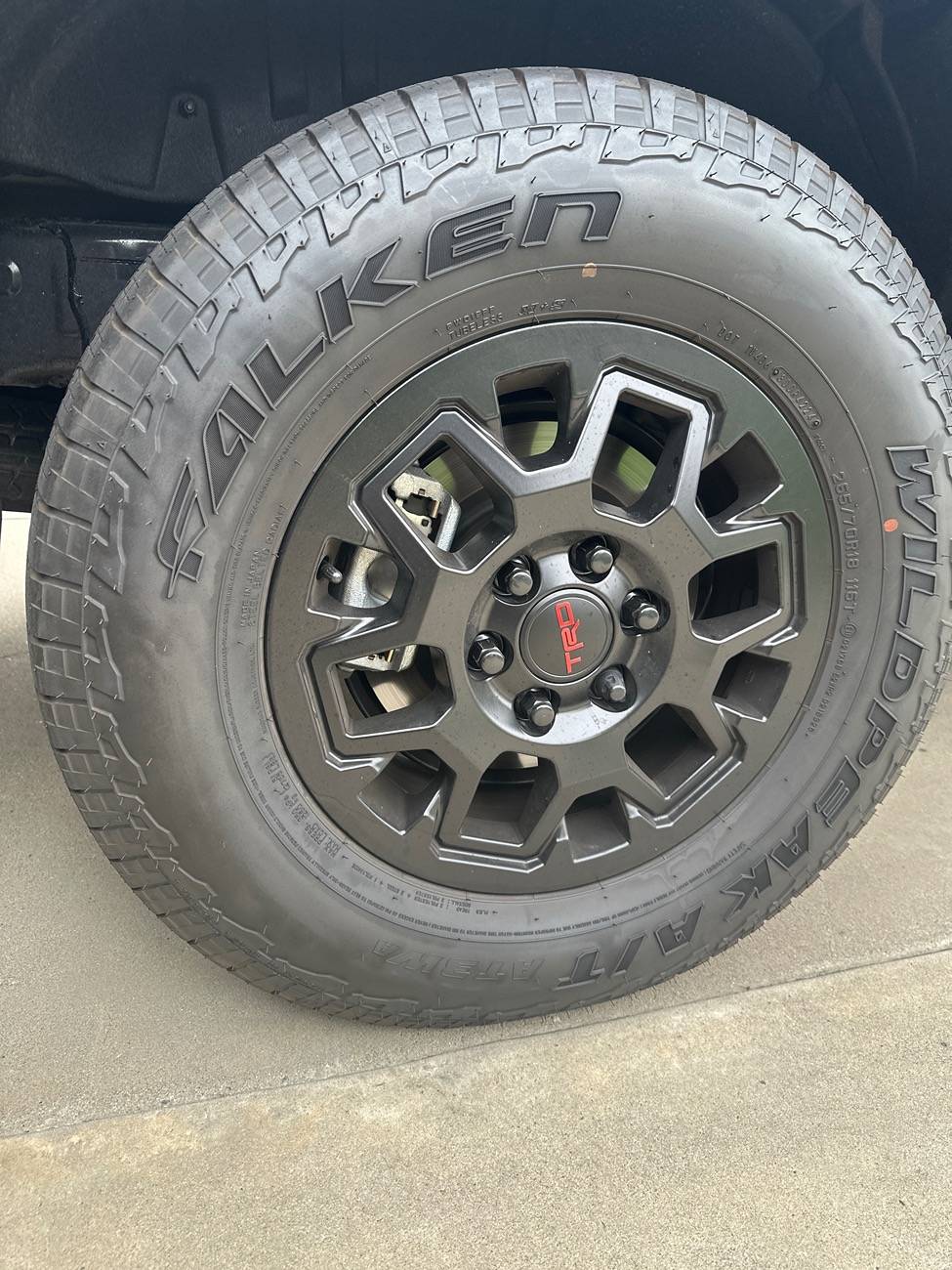

Thank you for the reply! Those are 18 inch trd off road rims and wheels that I got from someone online. I had them powder coated satin black. They came with the stock sr5 wheels which I quickly removed.

Thanks for the pic of powder coating the standard TRD OR 18" wheels. It looks good. I am considering this for my ORP but it seems impractical if the wheels are on the vehicle. Apparently the prep and powdercoating of 4 (or 5) wheels can take 7-10 days and most powdercoat shops are not also tire shops so you have to bring them bare wheels with TPMS and weighs removed, then take their result with your tires and TMPS to a tire shop to then remount on your vehicle.
I think I concluded it's far less hassle, and probably not much price difference after all is said and done, to just find/buy the black TRD Pro wheels and get it all done at a tire shop in one session. But I think you've made a good showing that if someone does replace the standard TRD OR wheels, it might help resale value/time if you got them powdercoated first.
