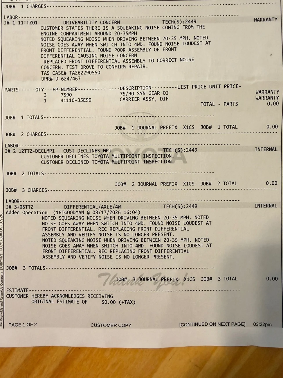

Just wanted to update everyone who's been having this same issue. At long last after almost a year to the day, the issue is finally fixed. I hope :)
The dealer needed to keep the 4Runner for a few days to get a recording of the noise, and were having trouble actually hearing it again. Asked me to stop by and drive it to see if it was still doing it, and within a couple minutes of driving I could hear it while they couldn't. Eventually I asked why they weren't using Chassis Ears to find the issue, since that's what they are designed for. They agreed to try that and a few minutes after could hear it clearly 🤦‍♂️
They submitted the claim to Toyota to make sure they would be reimbursed for the warranty work, and Toyota asked them to do some electrical tests to rule out other issues. So I had to drop it back off at the dealership again, though luckily this time it only took a day to run the tests. After that Toyota HQ approved the work, and told them to replace the whole differential. Only took a couple days to get that in stock and replaced, and as far as I can tell so far, it's no longer making that weird squeaking grinding noise.
Took 4 trips to the dealer and them having it for 8 days, but it's so worth it to finally be able to drive without that nails on the chalkboard noise anytime I'm above 25MPH. Shop notes and part numbers below in case it helps anyone else.
2025 2026 4runner 6th gen Noise above 30mph 4RunnerDiff

ChassisEar, never heard of that before. Cool!
And glad you got it fixed!
