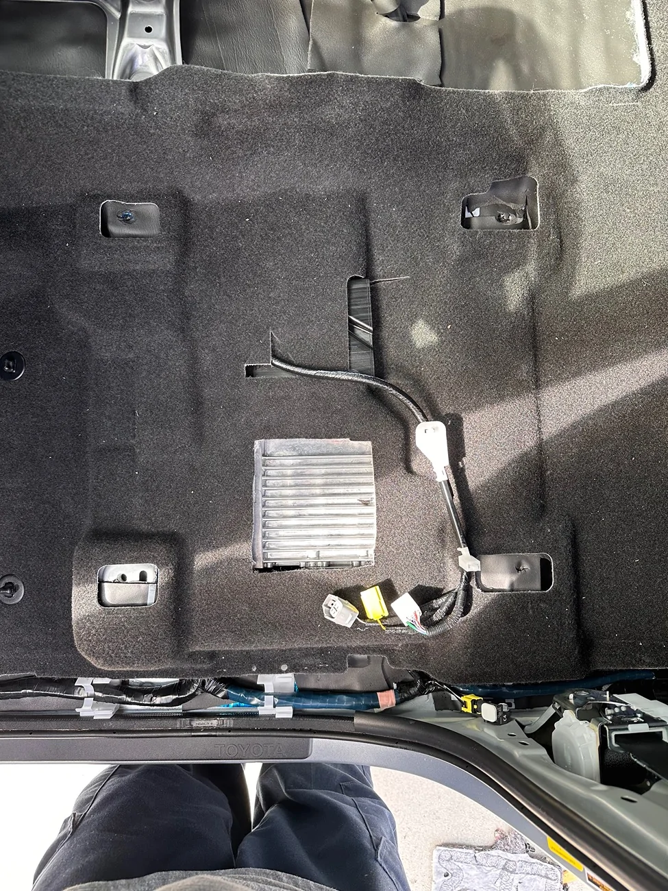

This is the amp under the driver‘s seat. For some reason Toyota decided to cover it up with carpet. I cut open the carpet
Thanks for showing us. I can't imagine why Toyota would think it's a good idea to cover an amplifier with carpet. My amp in my Tundra gets pretty warm without carpet covering it & hot when I'm pushing it.
