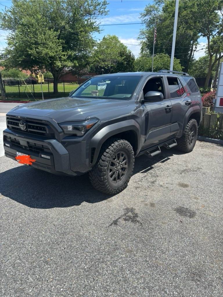

I have 285/70r/17 Wildpeak M/T's C load on my SR5 with no chub rub. About a 2 MPG hit. I still get 22 on the highway. And they have answered everything I've asked offroad.
2025 4runner 6th gen New tire options after sidewall puncture on Trailhunter. Image (4)
