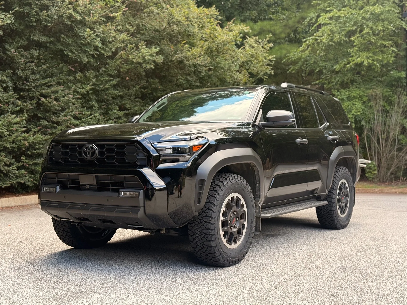

Oh, you mean like mine!? :)
Looks great, Which Method wheel is that? 17" for more tire options?

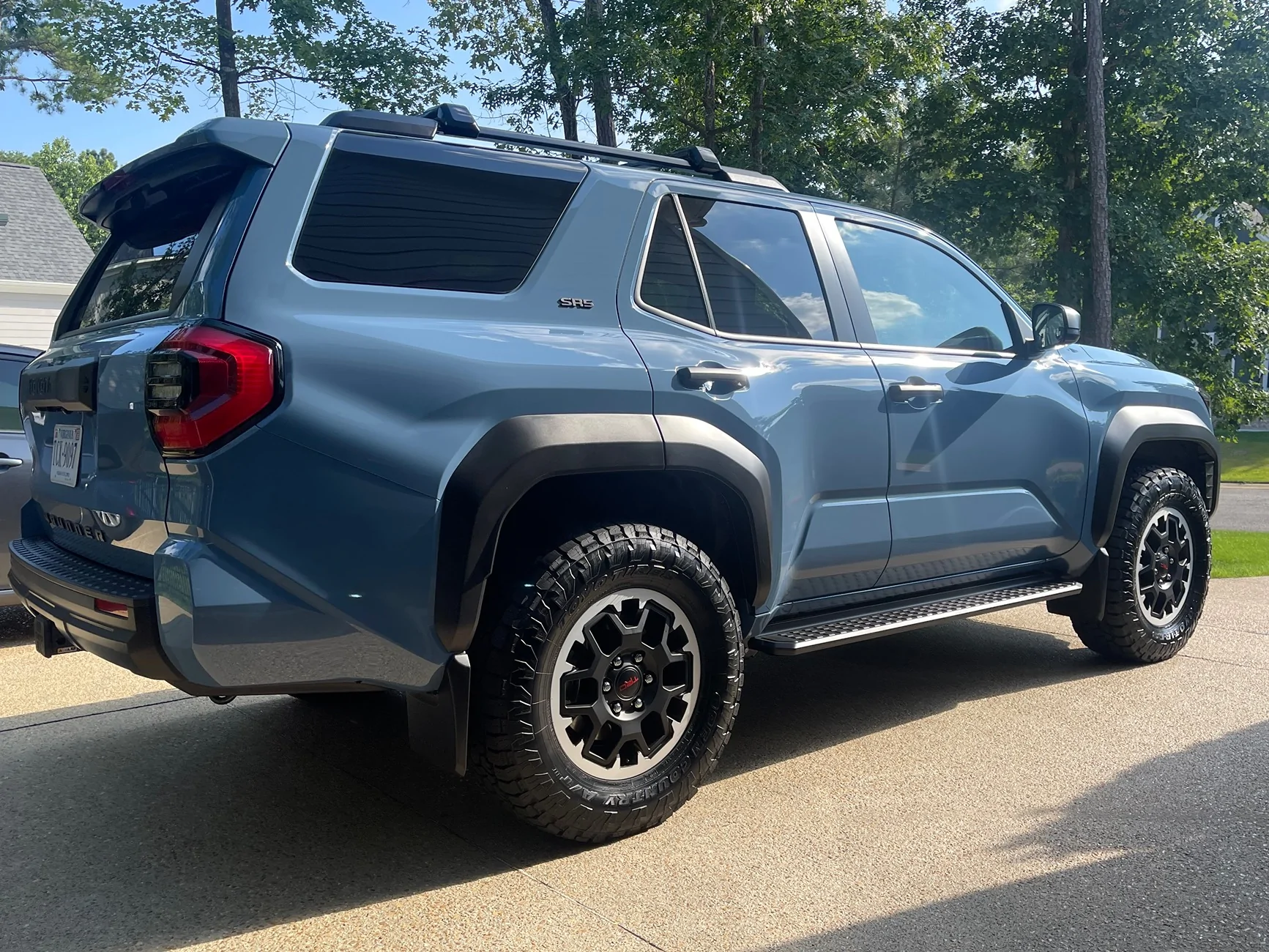

Unless you are driving a V8 like my Tundra I sold to buy our 4Runner, an E load range tire will suck away HP and gas mileage. Because of that I went with a C load range tire that is six ply instead of ten. The tire is a little lighter and still gives protection. I run 17"x8" wheels with a plus 25 off set. My tire size is 275/70/17 Falken Wildpeak AT4s. At full lock I have an inch to spare and have zero lift yet. Holding out for shock options for the 25 4runner.

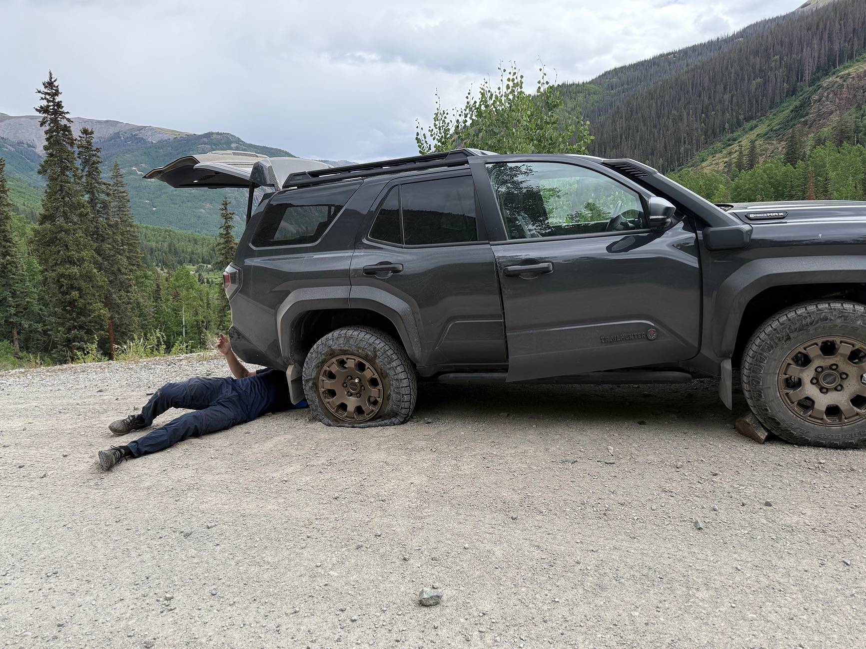

Hi all,
Today, while driving up to Engineer pass in the San Juans, slowly, tires deflated to 25 PSI, I heard a pop. Tire instantly deflated. Sidewall puncture. It seemed way too easy for that to happen. These are the original Toyo Open Country AT 265/70 R18. Truck has 3,000 miles on it.
Since this tire is non-repairable, and this is the kind of driving I intend to do I have decided to just buy a new set of tires. I have used BF Goodrich KO2s on all of my previous 4Runners and loved them so I'm inclined to use those again, and also go larger, probably 285/70 or 285/75.
So:
Any cons with this tire size besides reduced fuel economy? I assume these will still fit with no rubbing? Open to other tires but the BF Goodrich ones I have used in the past were 10 ply, much better sidewall protection. This Toyo tire felt very squishy to me, not up to the task of heavy duty off-roading.
Thank you!

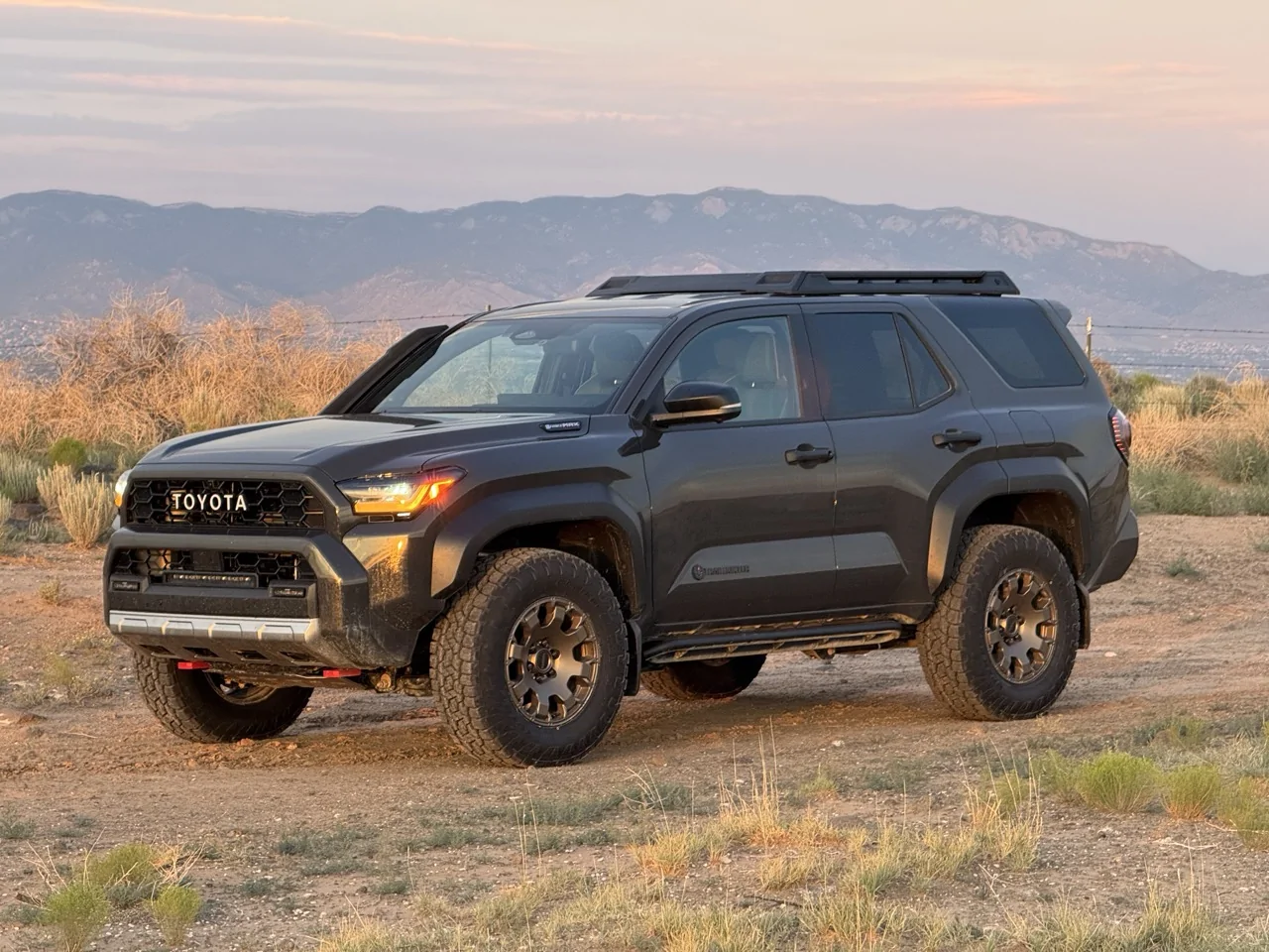

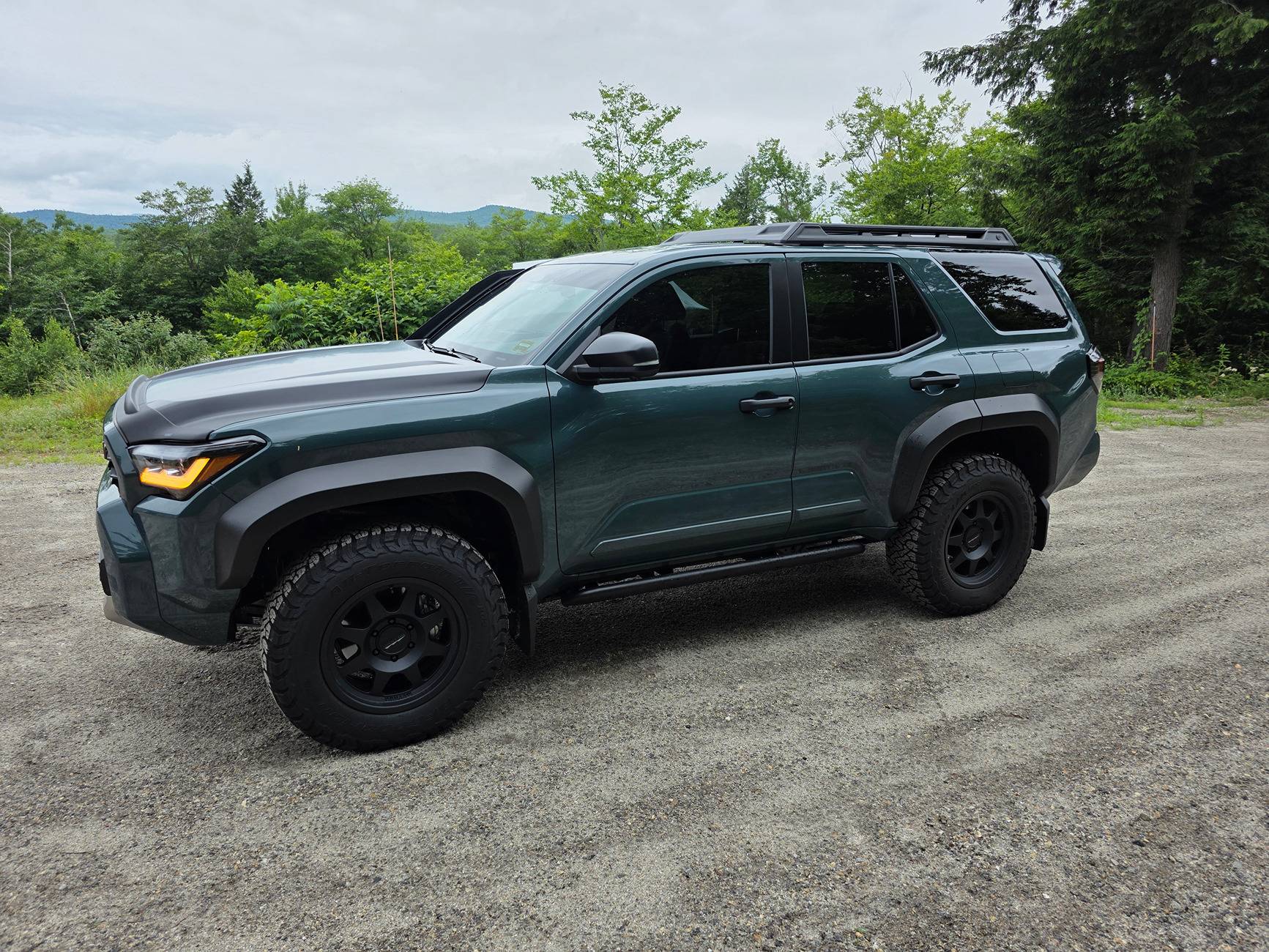

I opted to replace the originals with the 285/70 R18 Toyo Open Country AT3 from Discount Tire. They are significantly lighter than any other of the 285s and seemed like they got a better score with low rolling resistance. First impressions are that the ride isn't as harsh as I expected, they are noisier, but doesn't bother me, they look great and don't rub so no modifications needed, although they come very close. Effect on MPG is yet to be determined. Picture below with the new shoes:
Beautiful setup. What pressure are you running for highway speeds with these?
