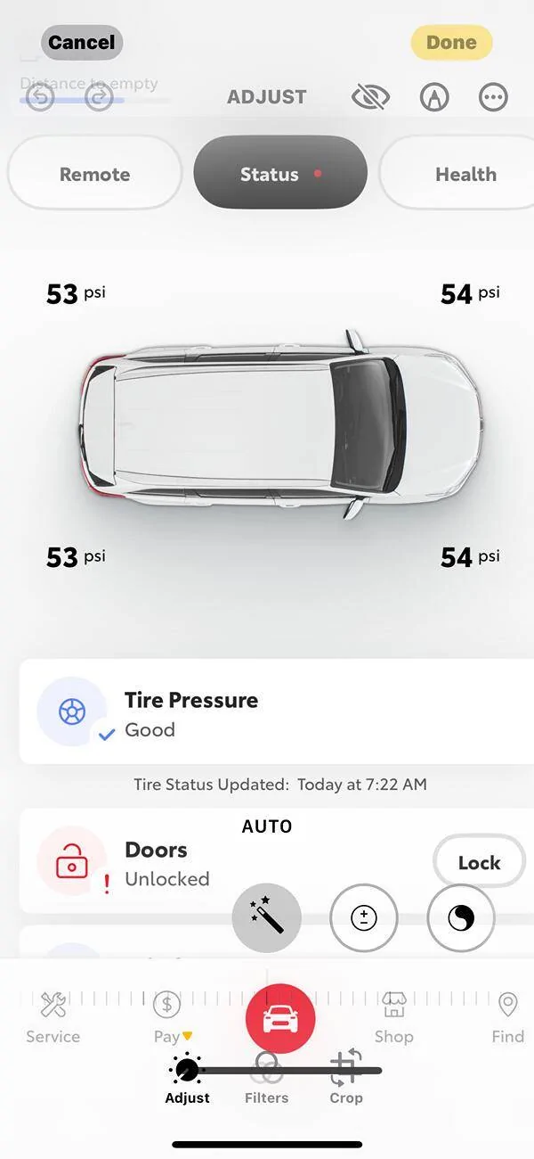

Stock trailhunter tires call for 33 psi. My spare was also way overinflated. I have one of the dash menu options set to report the tire pressure for all 5 tires which is handy.

Picked up my SR5 on Saturday. 55 psi all around. I asked the salesman if this was a mistake in the delivery process and he admitted it was. had them reset to 33 psi amd the ride was dramatically improved.

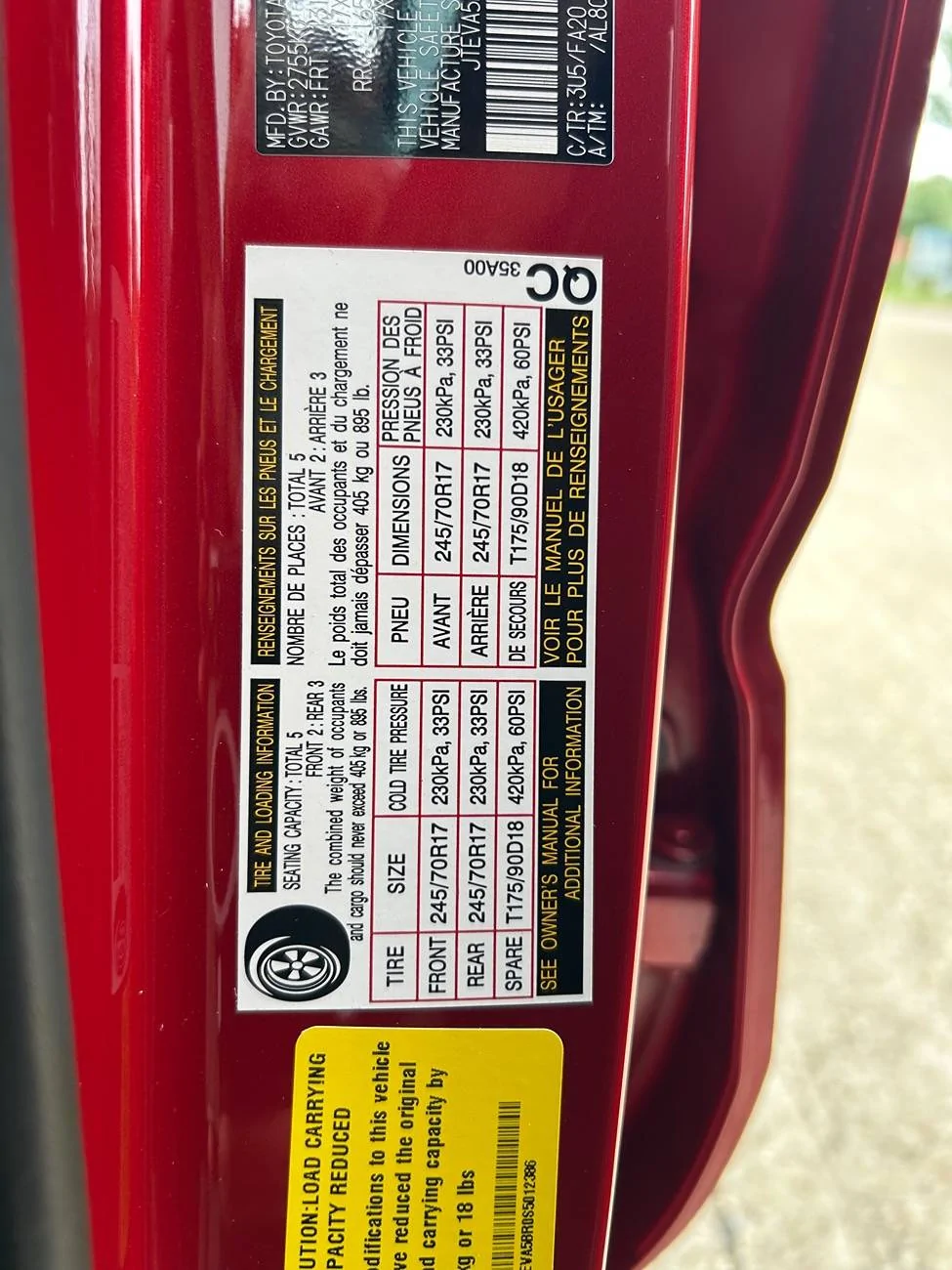

Door card shows spare should be at 60 in a pic someone posted earlier. Does yours say that?
Nevermind. That was NOT a full size spare.

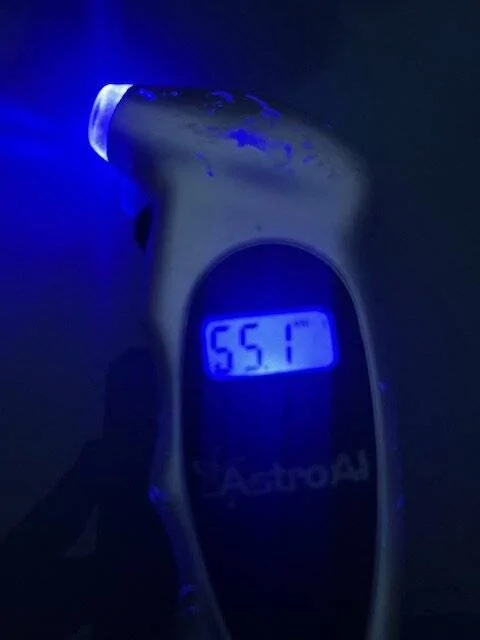

I’ve got the full size spare, it was 55 PSI upon delivery on Saturday. I backed it down last night when I had time to climb under the truck.
