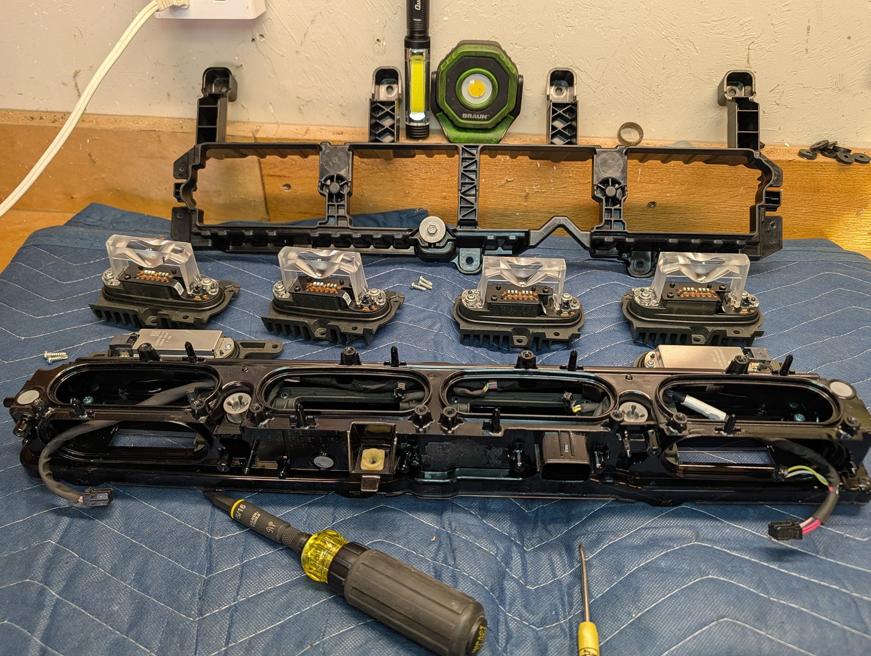

If you buy a Toyota light bar with the mounting bracket, it will bolt right into the TRD Pro or Trailhunter grills, but none of the others.
However...Getting the Toyota light bar to work is a whole other affair entirely. I bought one and have been trying to figure it out. There is no plug and play solution, and no one has figured out how to actually get the light bar to fire without tearing it apart (and that's on other models, it may not work here).
Source: Me. I bought all the parts to do a full Trailhunter grill/light bar conversion and...It's not going well LOL

The factory light bar (Toyota calls it: LED Illumination Light Center or Light Emitting Diode Illumination) connects to the dash switch, the headlights, and CANBus. That's what I've found so far. The switch itself also connects to a few other places (haven't chased that squirrel yet, probably won't). Techstream may help, but you need a LOT of physical connections to be made long before getting to the software side of the house (if you want it to behave like factory).
Duplicating the signal to the back of the factory light bar to get it to fire off isn't simple at all. There's no simple hot/ground/relay setup. The Tundra guys gave up a couple of years ago and just drilled a hole in the back of the light and made their own. I started down that path a couple of days ago, and even that might be a stretch for us 4Runner folks (slightly different bar). It's 10 pins on the back of the light, and 12 wires on the inside of the bar for the same connection. There's an entire 6" long circuit board and a whole ass wiring harness inside that factory light bar. As far as I can tell after a couple of years of forum posts on this exact subject...The Tundra guys couldn't do it, the Taco guys couldn't do it, and I seriously doubt that I'm going to be able to do it...I'm handy and can do basic wiring, but I'm not anything close to being an expert, I'll give up and order aftermarket soon most likely.
I'm going to have to drill a hole, cut wires loose and hope they're long enough to feed through that hole, and try to make my own connections (assuming I can access all of them...So far, I can only get to 4 out of 7 to manually make them light). If it doesn't work, it will ruin the light bar and I will have lost the $200+ I spent on it. If it does work...I'll have spent a ridiculous amount of time and effort to save a small amount of money for a light bar that by all measures...Is inferior to all but the cheapest aftermarket bars.
