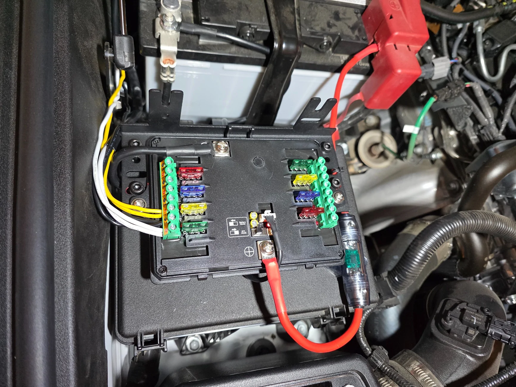

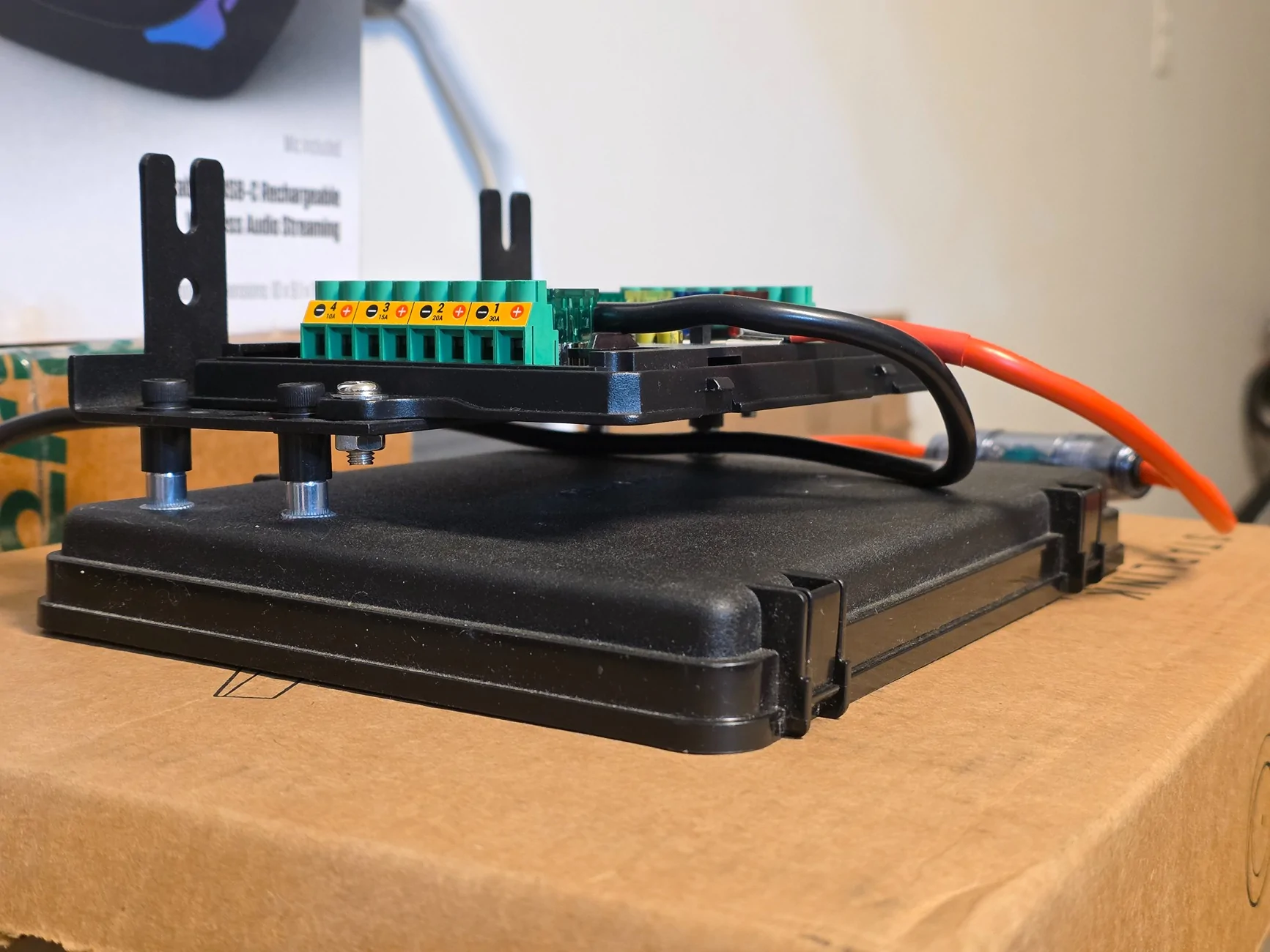

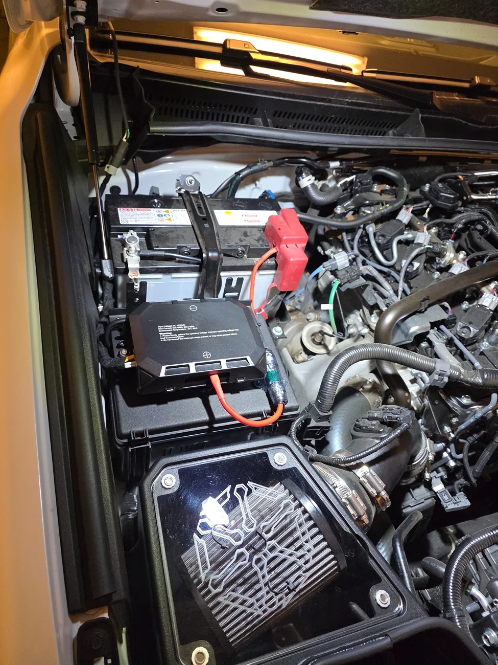

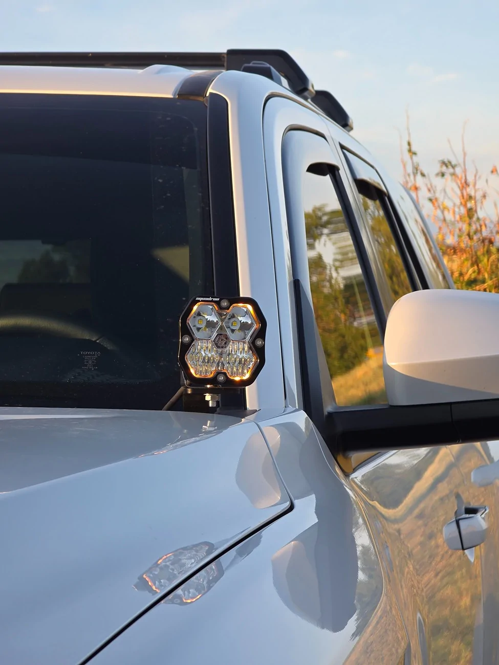

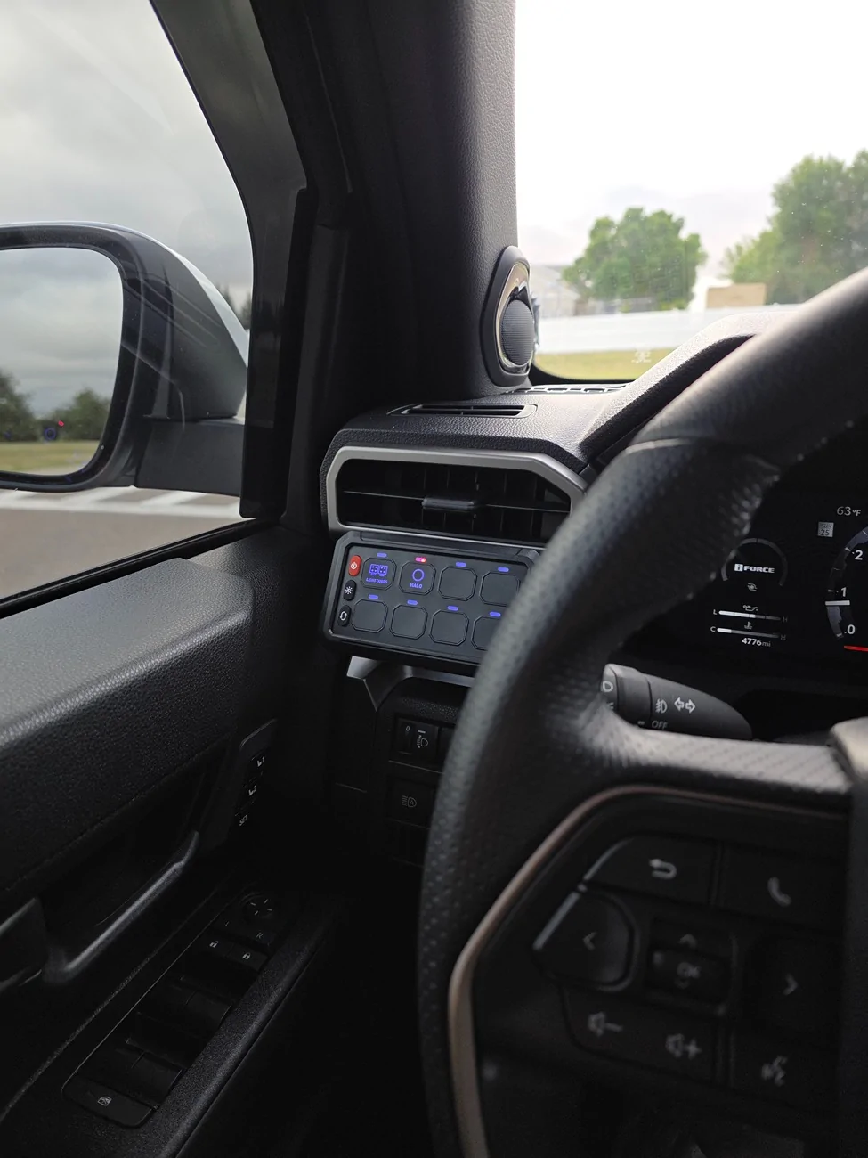

I got this Bumbee 8-gang switch panel for less than $80 on Amazon. It looks just like most other one for less. Wiring was very easy. I put it on the left fuse box (by battery/gas-model), and run the wire into the cabin. I put the controller on the left side below the vent, with double-side automotive 3M tape. Been great with no issue. I wired to my Baja Designs 2.0 Squadron Sport ditch lights.
This specific switch has an internal switch where you can choose between battery power (recommended) or ACC power (on/off with car). I skipped the wire to ACC fuse. With battery power, you can turn lights on/off whenever, even when car off.

Thanks, this is exactly what Im looking for! The few lights I want, I want to work when chilling at the beach in the evening and want light without the accessory on
