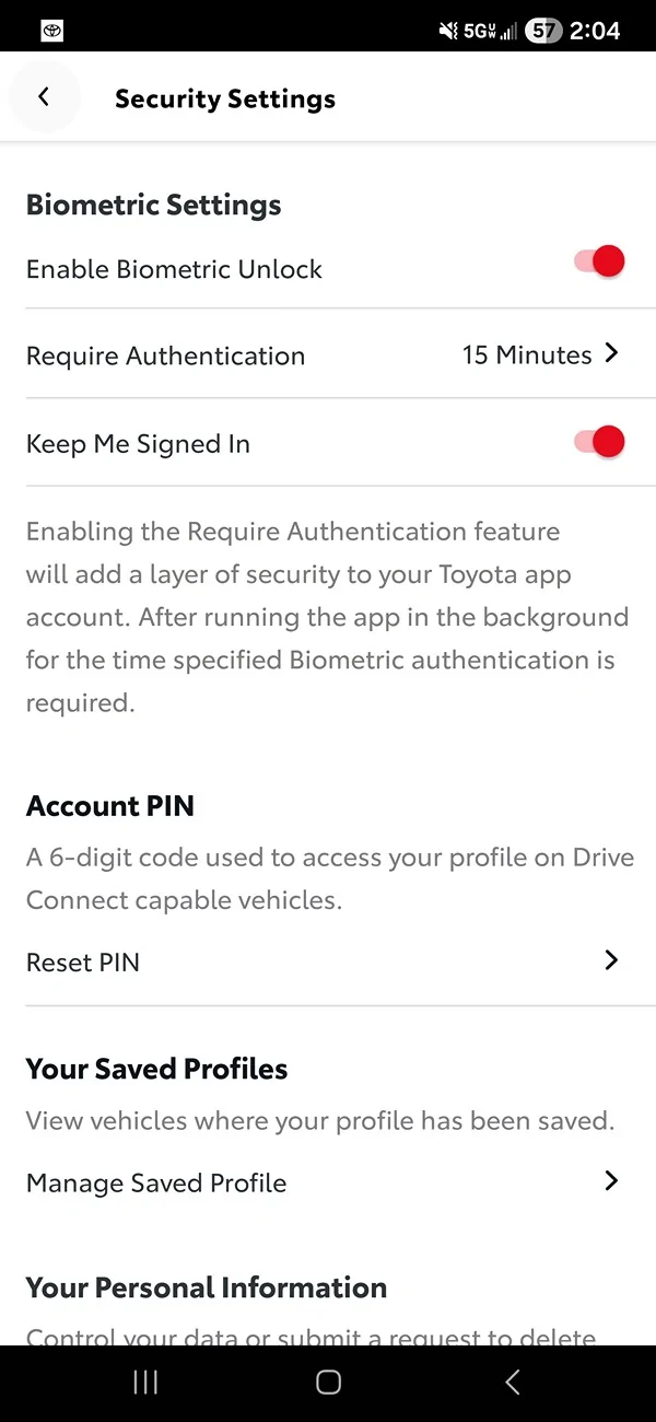

70
2,953
1,645
need to set the app to keep you logged in

2025 2026 4runner 6th gen Digital Key Issues Screenshot_20251002_140413_Toyota
