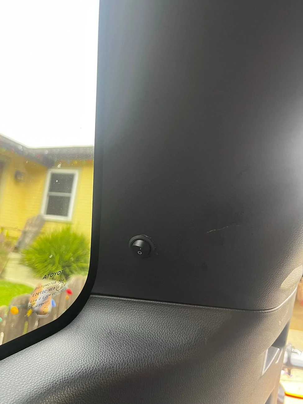

I added a simple rocker switch to control the rear cargo lights on ORP. I sleep in the back often with tailgate up and didn’t want to wait for rear cargo lights to turn off
MikeD
Jun 4, 2025
606
493
Wiring details? Switch location/mounting?
CSpil
Jun 18, 2025
2025 4 Runner TRD Premium
here’s a pic - I got a local car stereo place to wire in the switch / works perfectly to toggle the light on / off as needed
