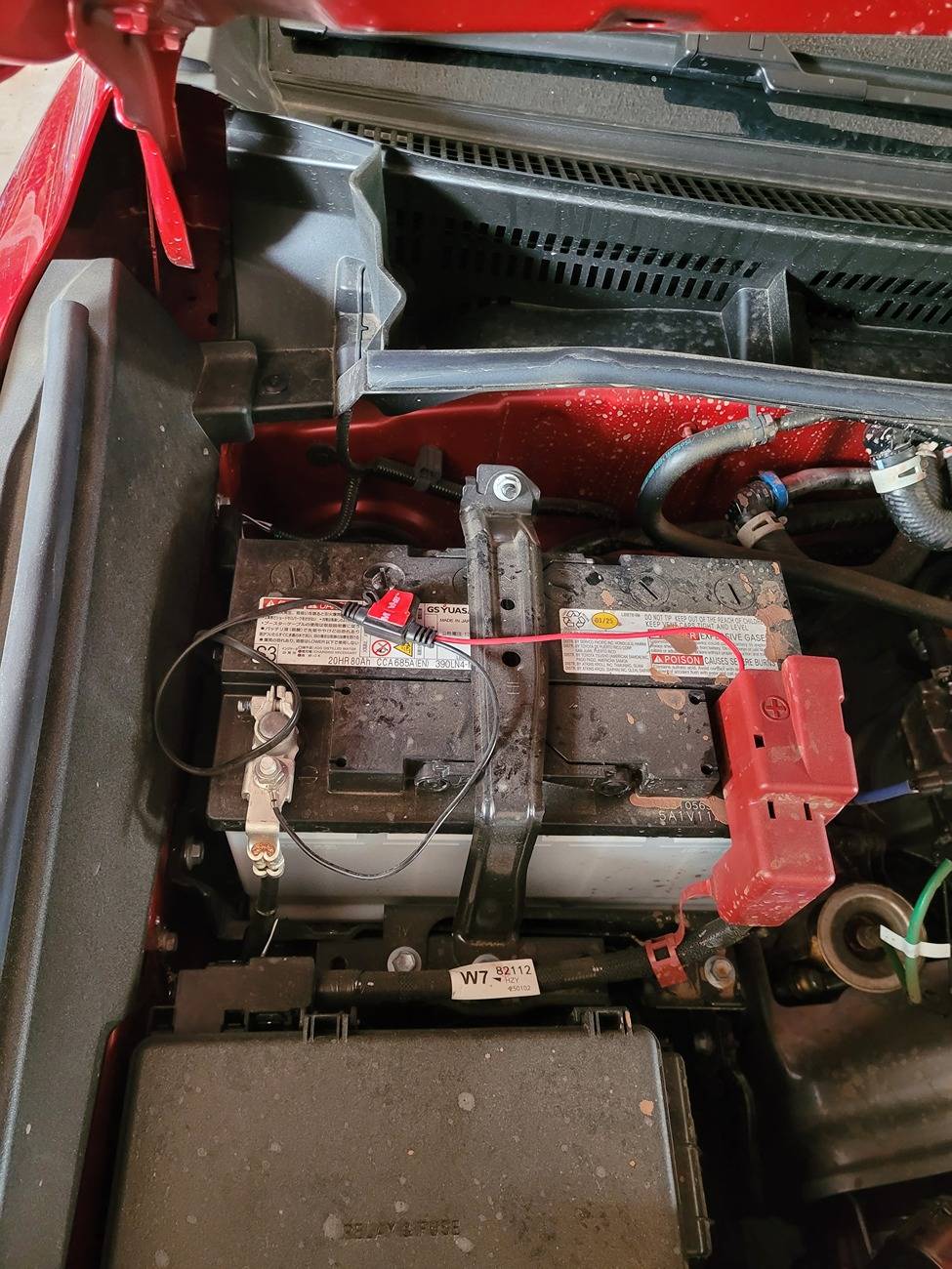

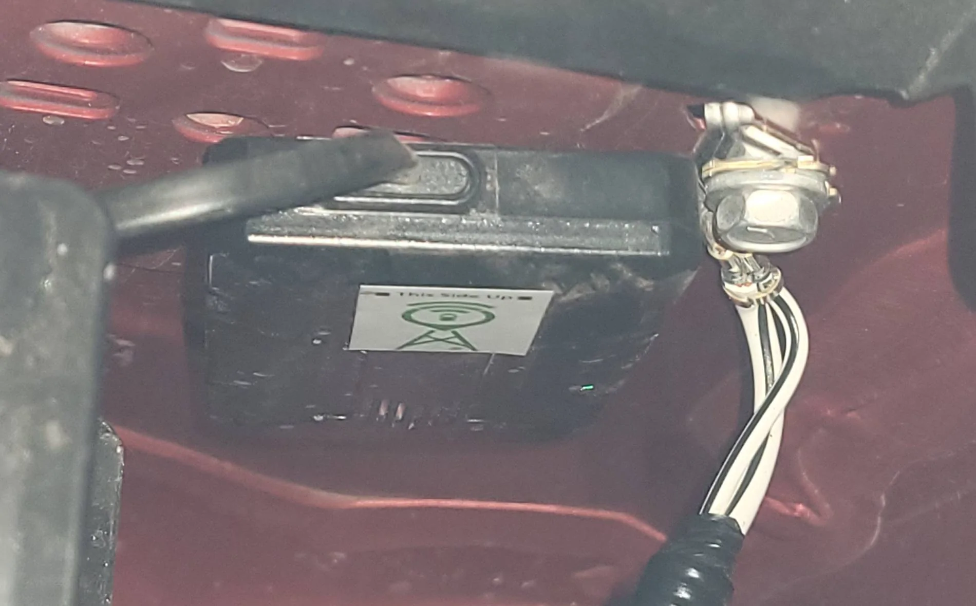

I was poking around under the hood, just checking things out when I noticed something connected directly to the battery via an inline fuse. The wires went to a small flat rectangular device stuck to the inside of the fender with double-sided tape. The only identifying mark I could see was a wireless symbol. No other wires, just the battery positive and negative leads with the inline fuse.
I'm tempted to pull the fuse and see who calls me!

That is an IKON tracking device I believe. Dealerships often install those as part of a "theft recovery service". I believe in most states they are required to disclose that they are installed at the time of delivery. I removed mine they day I bought my 4runner. I believe my vehicle is being tracked enough already. I do not know who IKON is selling your location data to along with being able to track your "stolen" vehicle. Hope this helps!
Here's a link...

I was never told it was there. I guess I'll remove the fuse and see what happens.

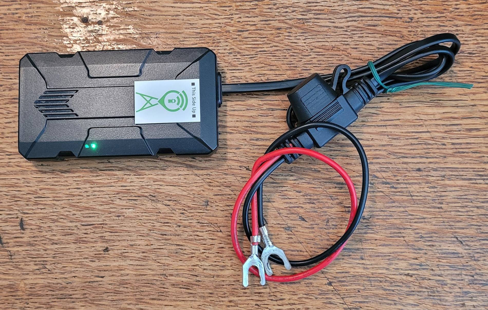

So I pulled the fuse but the pilot led stayed on. It must have an internal battery. Then I removed the device from the vehicle and brought it in my house. The led is has started blinking an hour later. The vehicle still starts and the SiriusXM still works. The key fob still locks the doors and allows me auto entry when I grab the door handle, just like it used to. I don't really care about any other fancy features.
