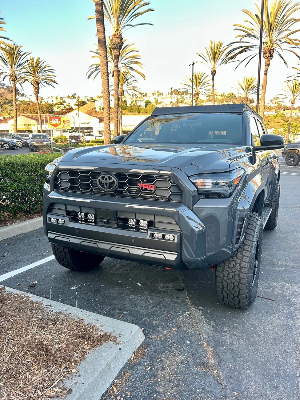

I went with the Baja Designs S2 Sport Light Kit that is a direct replacement for the standard fogs.
They are a definite improvement over stock for sure! I installed them myself which is simple but a little time consuming since you have to remove the bumper cover.
I would highly recommend adding the four Squadron Lights (See pic) at the same time so you don't have to remove the bumper cover again like I did.

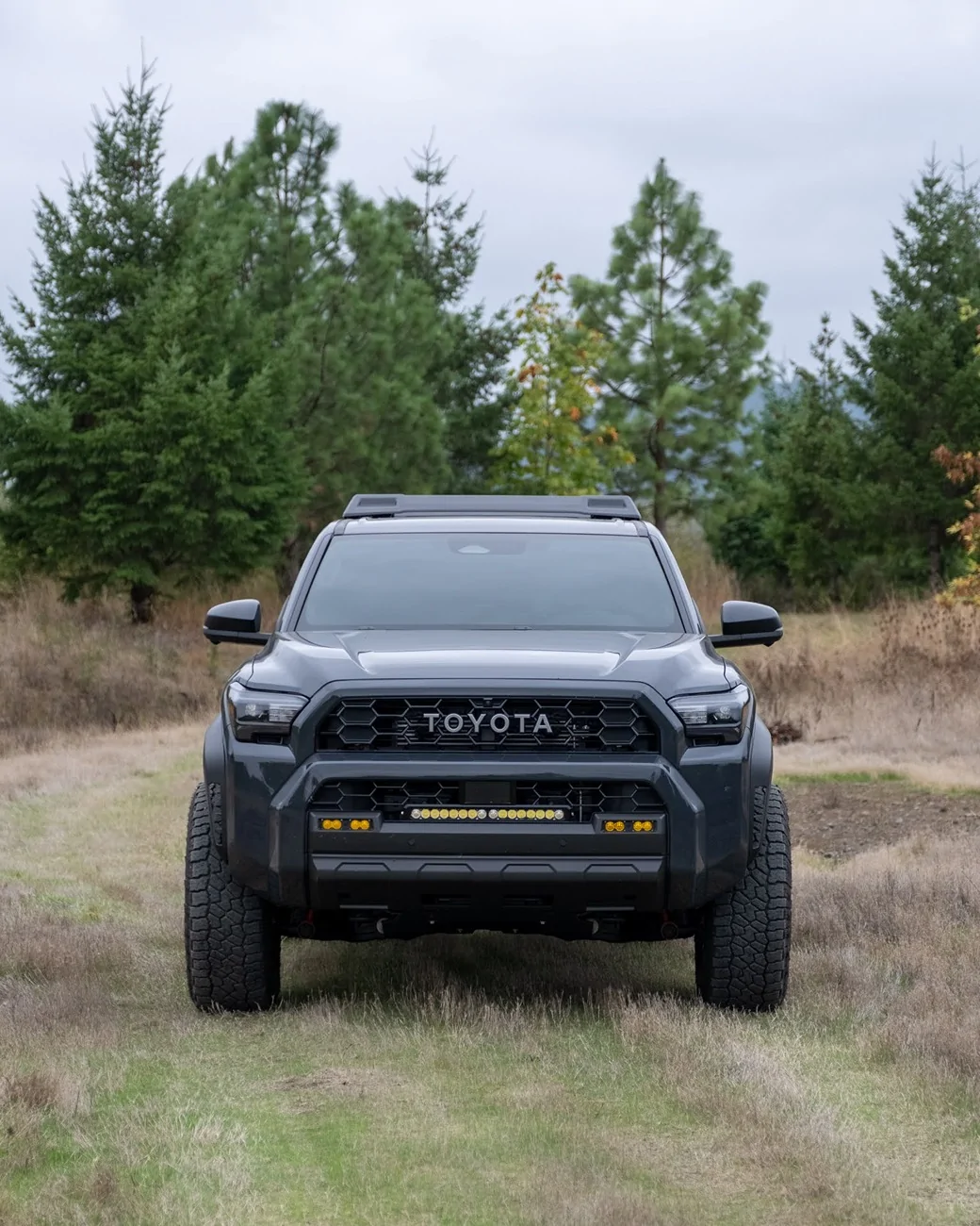

I did the Baja Design S2's but didn't use their direct fit kit. I bought the lights standalone and used the Westcott mount. Gives it a much cleaner and more finished off look. You can order the Baja Design Y harness to make life simple and then make your own conversion harness to plug directly into the factory plug so no cutting of the factory wires. (I did a little different as I wired to an SPOD BantamX using the factory harness as an input trigger but that isn't necessary. I wanted full control on the SPOD so they stay on with high beams and adds strobe features.)

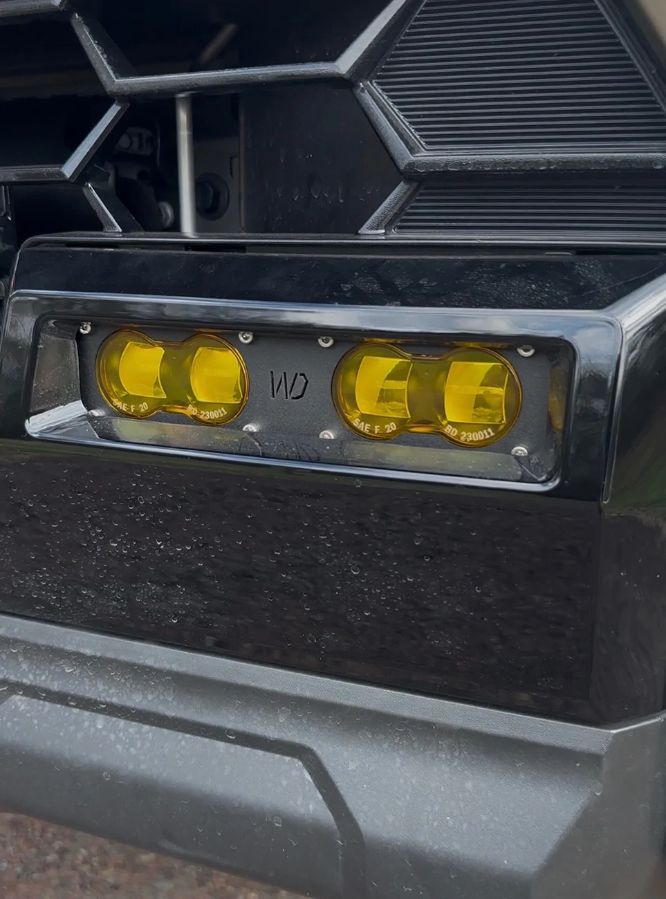

Same

The Wescott bracket sort of fills in the gaps that the Baja bracket creates. See pic.
