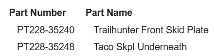

Double check on this . I have a non hybrid and almost positive the part number is different.
Skid Plates
read through . This is where I got my info.
