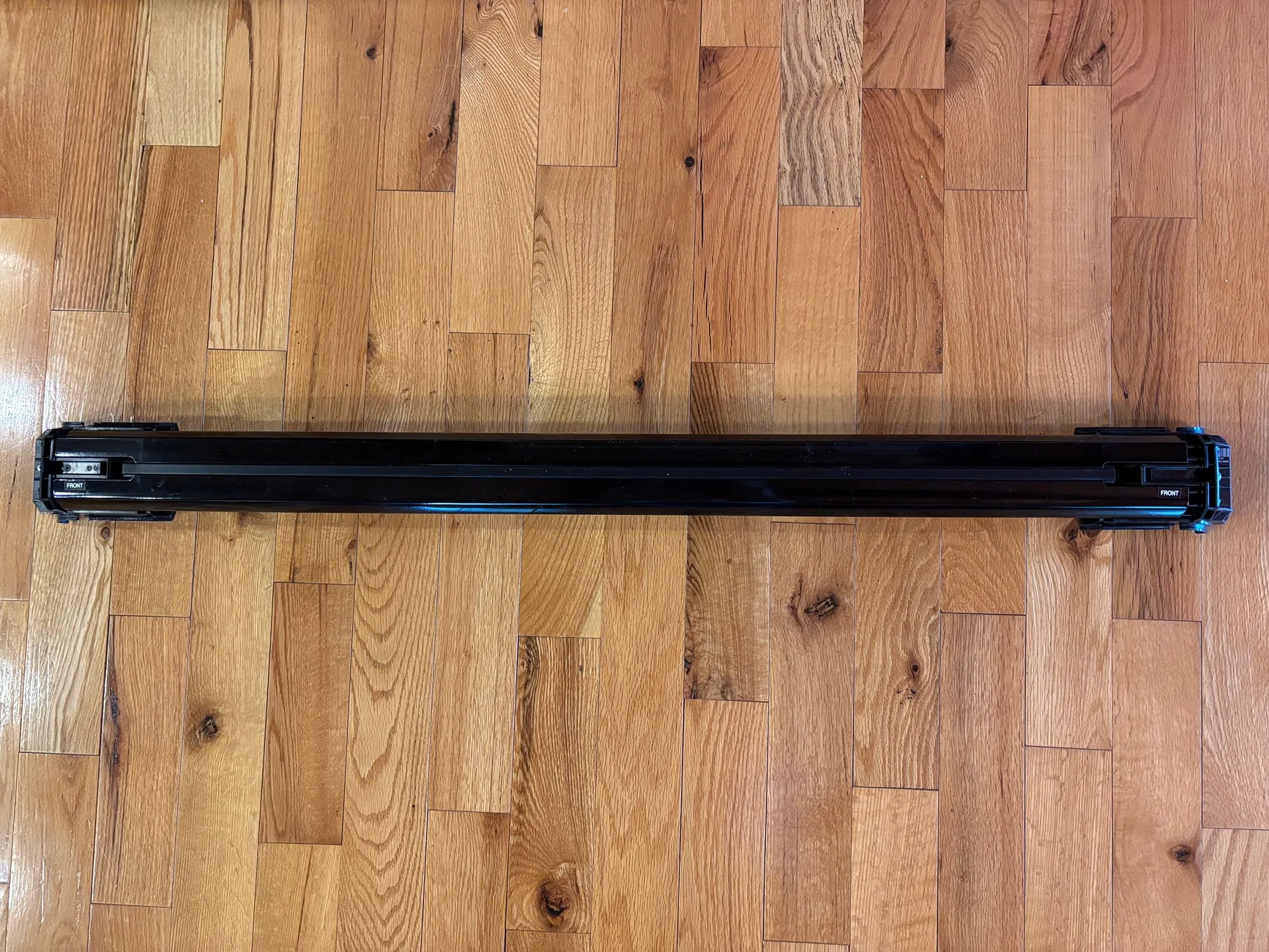

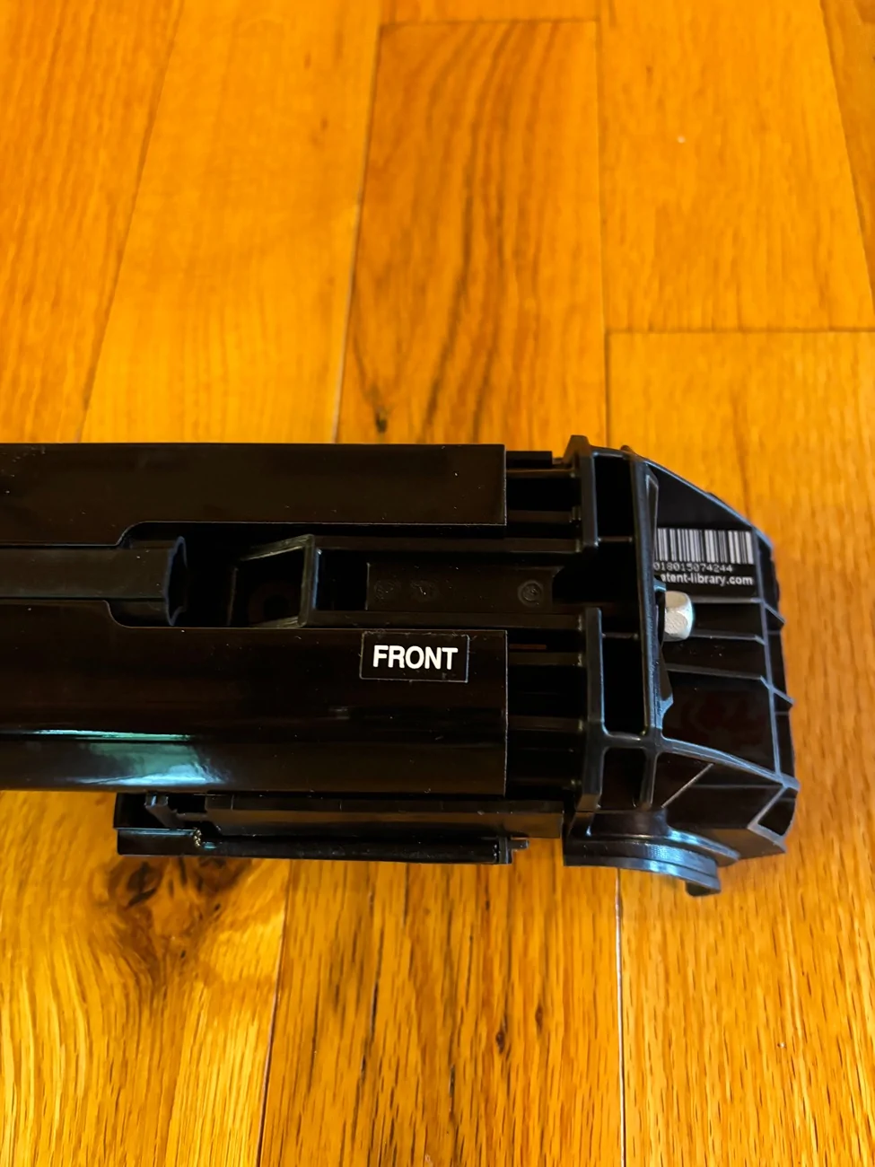

Mine are removed so I checked them.
The cross bars are labeled same as yours. But one cross bar has an adhesive label on the top surface on each end that says “FRONT” which means that is the cross bar that goes at the front of the vehicle.
As for which edge of that cross bar is the “leading” edge… another user on the forum previously posted that “the crossbars have one side that is smooth and round. The other is more angled and has a ‘lip’ or spoiler at the top.”
I labeled mine as I removed them. To minimize wind noise, mount the cross bar with the edge that has the lip FORWARD.
The decorative caps are labeled the same as yours. I also added labels to the caps as I took them off. An LH was driver front. An RH was passenger front. The other LH was driver rear. And the other RH was passenger rear.

Thank you for checking! Maybe we just chalk it up to a weird abbreviation scheme, although honestly I cannot imagine what the "F" could mean. And yes, mine does have the "Front" label as well, although seems like that would wear off over time--would be nice if it were embossed in better. That said, once I inadvertently tried putting them in the wrong way around and they really do not fit, so unless you really force it you will know if you are wrong.
