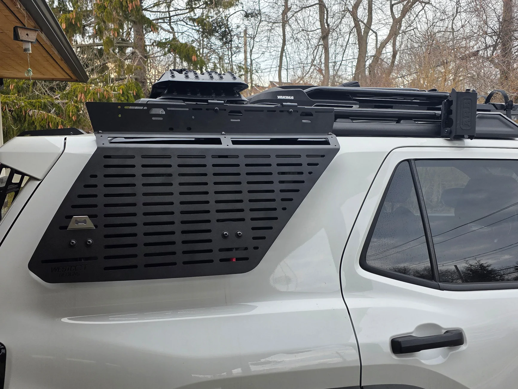

i am going to try fitting the westscott designs exterior molle panel to my TH. i used gemini / nano banana to spec out some custom L brackets and uploaded the design to sendcutsend.com. i made the L brackets in textured black .187" 50502 H32 aluminum. they should fit the standard ARB t-adapter. if it works out i'll go ahead and do the driver's side as well. look for a followup in a few weeks.

OK the custom adapter does work.
This is just a dry fit. I need to pick up some better/longer bolts before finalizing because my custom adapters are way over-engineered (twice as thick as the molle panel itself).
Also it's going to be a bit of an art to get my HiLift Jack holder back on in the high position - you can see the front jack holder bracket is still on the car in the low position. The order of operations will be important because the tolerances are tight.
But it looks like the inside top edge of the "fin" of the molle panel will rest square against the vertical face of the T-adapters, giving it good it rigid side support.
When the rear Jack holder bracket goes back on, that fin will prevent the holder from sagging while weighted in the high position (I don't find the dovetail system to be very secure but maybe I'm doing something wrong).
2025 2026 4runner 6th gen Exterior MOLLE Panels compatible with stock Trailhunter Roof Rack 1000014204
I had my brackets manufactured to a pretty tight spec at sendcutsend, but if you're capable of bending a piece of metal and drilling a hole you could probably make your own.
Now that I have the molle panel on hand I can see how I could do this differently - and maybe I will in a 2.0 version - and just manufacture my own fin with the three hole pattern to attach to the panel and an L-shaped bend to seat on the t-adapters. Then again, the whole thing will be hidden by the HighLift at least on the passenger side so it doesn't really matter.
I have the quick release awning brackets on the drivers side - though I don't drive around with the awning much. I haven't bought the driver's side panel yet, but that'll be another close tolerance thing. Not so much about getting the Molle panel on the truck - that is solved now, but more Tetrix of carrying a lot of accessories on the vehicle.
Feel free to rip off my plans. You can go thinner than I did and save a nickle. The .187" alumnium is overkill.
